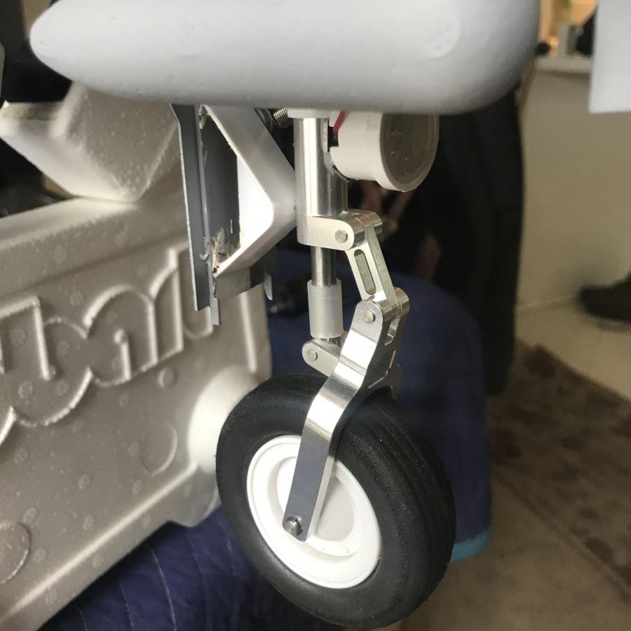

                                Hey there John, thanks again for sharing your experience thus far with the new nose gear.
                                I received my gear yesterday, and am quite pleased at the look of them. I played around with the Nose Gear by pressing down on it to see what kind of tension it had. I must say that it is quite impressive and really hard to compress down as far as yours seems to be going. I'm wondering too if yours was defective somehow.
                                You mentioned seeing oil on the strut early on, which is not uncommon, (and quite annoying; my F-86 has that issue) but quite possible that it may be not as tight as it should be. As soon as I get the chance, whenever that is, I'll install mine to see how it performs. If yours is noticeably compressing that far down even on taxiing there's definitely something wrong.
                                Has anyone else experienced the same issue?
                                I'll report what I find after testing it out.

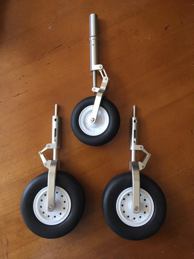

                                  I have the upgrade TL nose gear and the upgraded mains will be here tomorrow. They're all getting a flat white paint job before install.

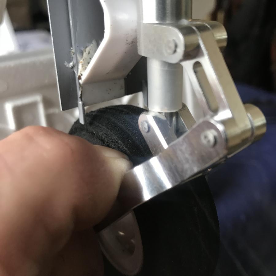

                                      I tested the amount of force of the new TL gear just like you did initially and was also surprised at the amount of force required to fully compress. Even now, after 15-20 landings, the amount of force required feels the same. On the pic I attached with gear/bushing installed in aircraft, it was all I could do to fully compress gear with one hand while holding camera with my other.
                                      I may not have explained well enough when I experienced tire to door contact. 90% of those times it was during my take off roll. With the original oleo strut, I made it a habit to apply power from idle to full throttle in about 3-4 seconds. Using this same method of spoolup with the TL strut is where I experienced the nose gear compressing and contacting tire. Increasing the spool up time by a few more seconds seemed to eliminate the problem. Keep in mind I fly from grass, cut fairly short but with a mix of hard dirt. Not sure if full up elevator was helping during spool up but I added that touch as well to help save the rear door.
                                      My description of experiencing tire contact while taxiing should have read “while taxiing back from a landing”. Just guessing, I estimate that to be 5 mph. I had no issue leaving or approaching pit area, which is at a slower than 5 mph.
                                      Woke up this morning to rain with a 60% chance of precipitation the remainder of the day. If I find a window of opportunity, I’ll head to the field and give the bushing mod a try.
                                      If I still have issues, I’ll order another nose strut and give that a try.
