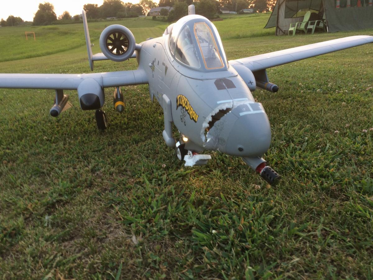

                      #6770
                      Originally posted by Sky Wolf
                      Are there any pics of how it looks on static display...not just the up close retract view? If so, I must’’ve missed it.
                      This is all I have but I can take some this evening.

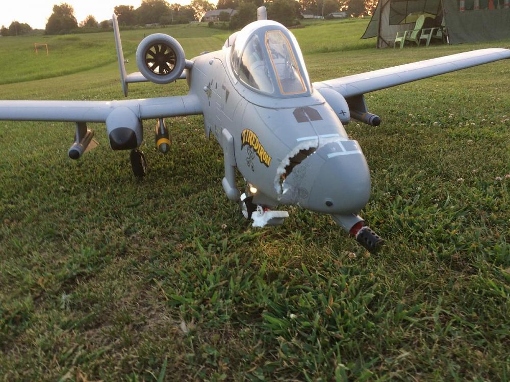

                        #6771
                        Yep, I am betting on it. But I clearly understand the reason for the mod. Glad you discovered it! It may bite me one day, but until then I’ll keep working on the greasers.
                        It’s like any plane- every one of them is different in their flight characteristics. I love the challenge of each of them.
                        While there are many who have obviously had problems landing her without incident, there are probably many who haven’t had an incident either...yet.
                        Clearly though, you’re right. There is an obvious issue with the way it reacts when it imperfectly touches down, and should be addressed in the future.
                        Here's what you're gambling on ;)

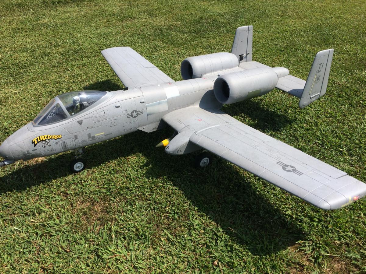

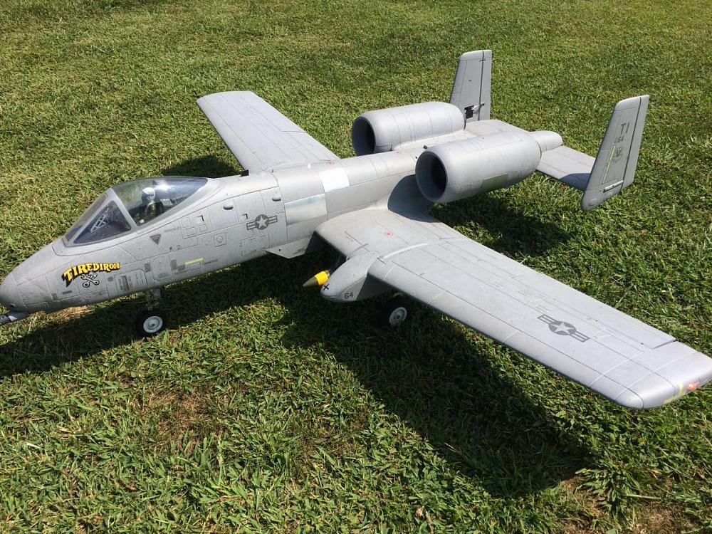

                                  #6776
                                  Here you go Wolf.
