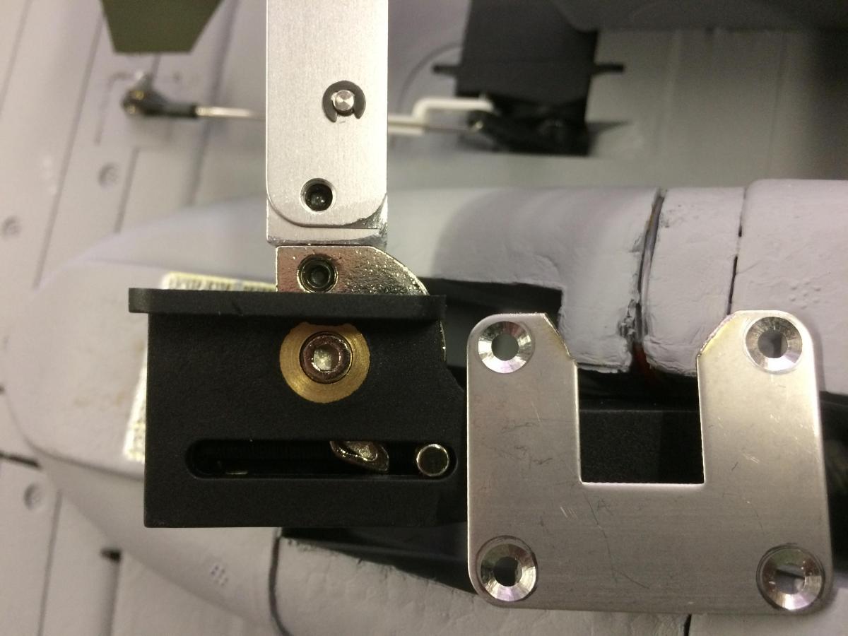

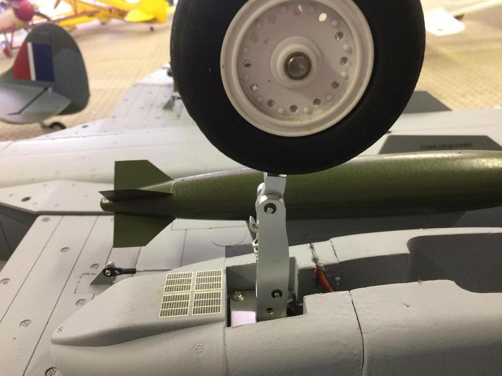

              Clear Blue (Jim) and I had our A-10s out this weekend. We have both reversed our mains after both damaging the nose gear from the "Death Bounce". Jim now has 6 flights and I have 11 on the reversed main gear. Not one single hop on any of those landings, and some were not perfect. Of the seven flights we put in this weekend Jim had the one "perfect" landing. It is very difficult to get a perfect landing every time and the stock setup is not forgiving. Reversing the mains is the only way to go.

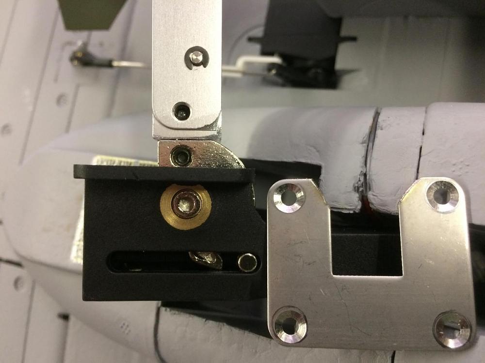

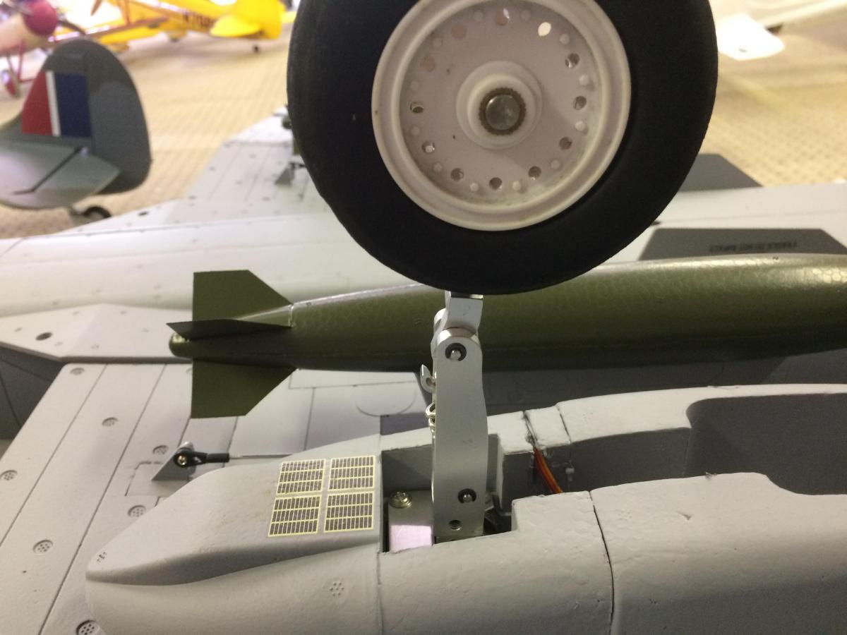

                                #6755
                                Originally posted by weedsnager
                                Any pictures of the mod you guys are talking about ?
                                and what Cg are you guys at with the batteries pushed back ?
