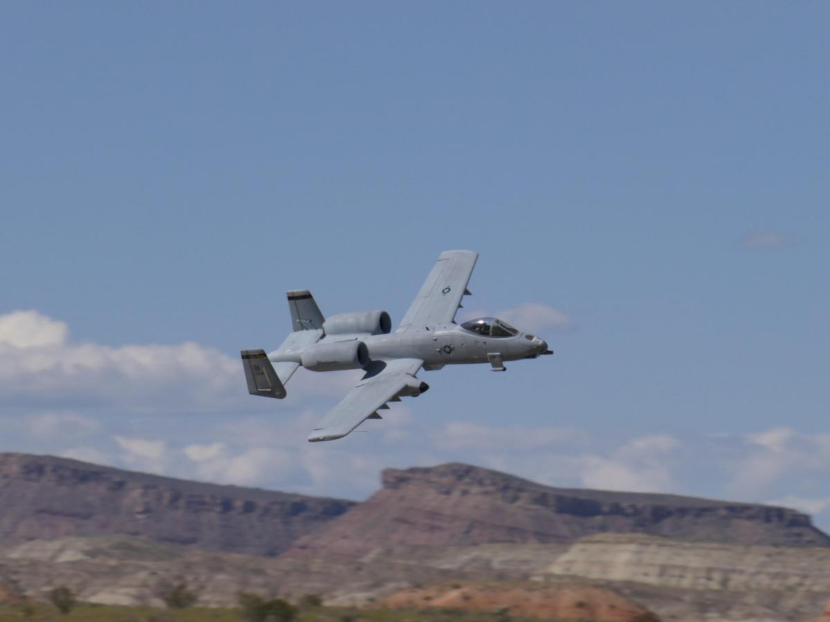

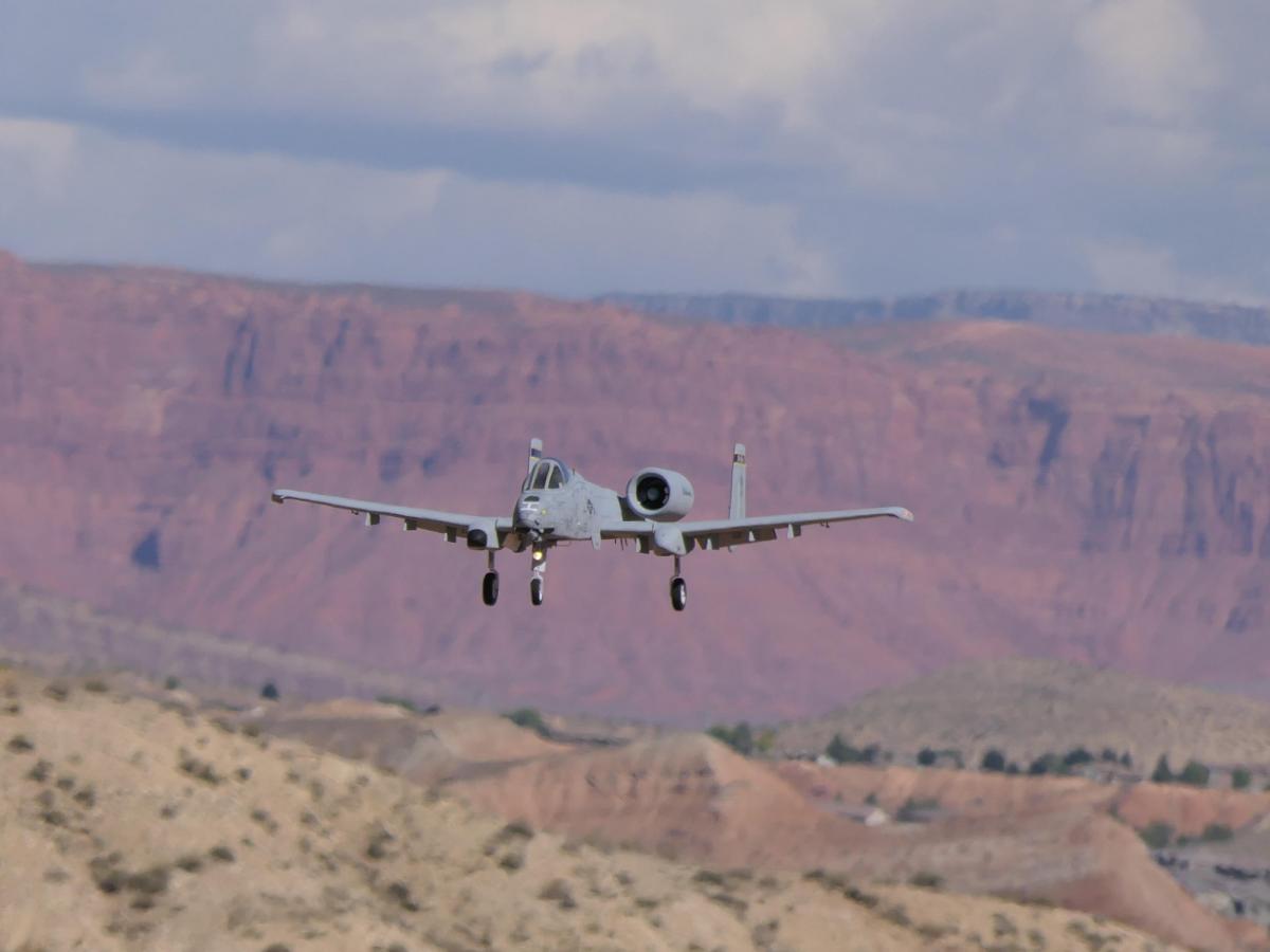

ID:	98863 Prototype Freewing A-10 flying at the St. George Electric Festival this week.
