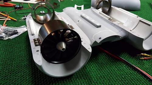

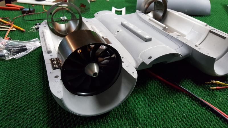

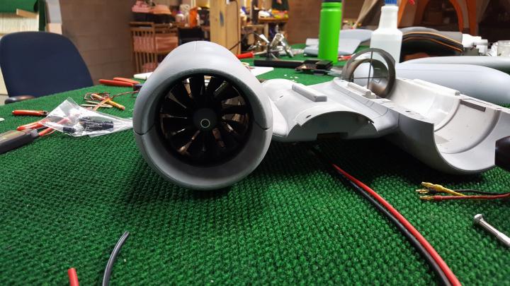

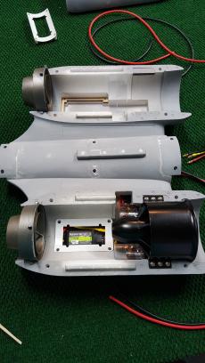

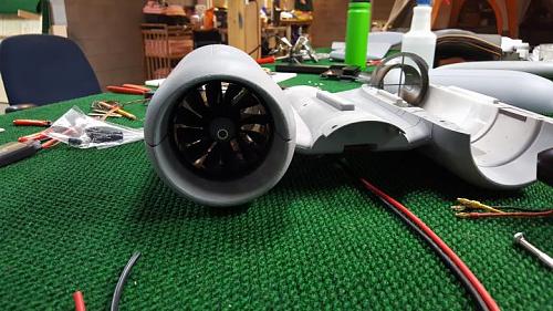

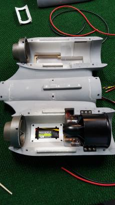

                            Well, here is the answer. The ARF+ does not come with the battery to ESC cables or BEC so I will be making a trip to my LHS tomorrow to hopefully get a Castle Creations 10A BEC. In the mean time I have one side done. I am very curious to see how this works out. I believe I can essentially run on 5S or 6S so it will be interesting to play with and see how they compare. I can't be the only or first person to drop some 90's in one of these... someone outside of the designers has to have done this already.

                              Bummer, that's what I figured, but was hoping they changed it. You may want to get the new Castle BEC that has better headroom than the old 10A, or just get the HV BEC for even greater headroom. The old 10A I believe is only about 5A maximum on 6S voltage.
                                    Looks like you're the CTD on the 90mm install..:)

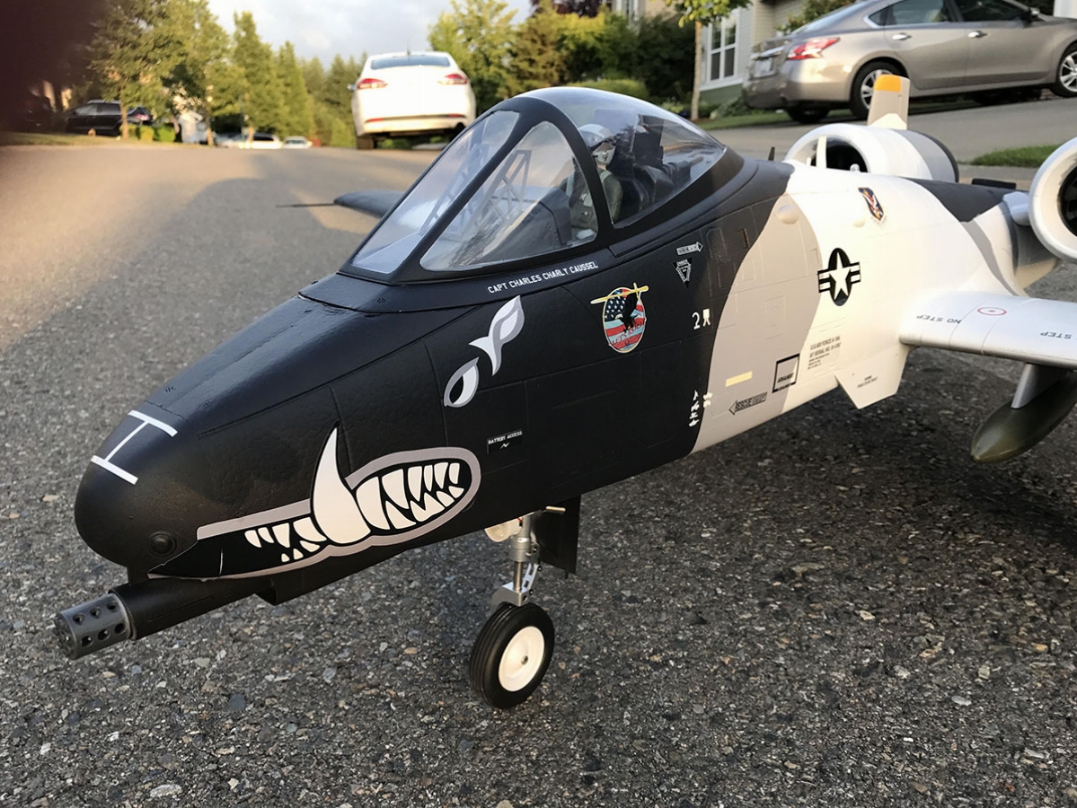

                                        Calliefied!! :)
                                        • HellHathNoFury
                                          • 247
                                          #4660
                                          Super nice Aros..:Cool:..Those dark areas wouldn't be agreeing with some of the Hot days some guys are experiencing especially in SoCal over the weekend.. Apparently got up to 117 degrees...
