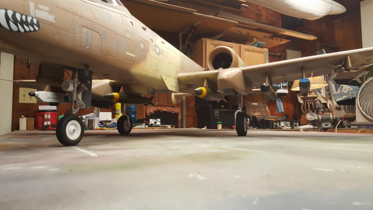

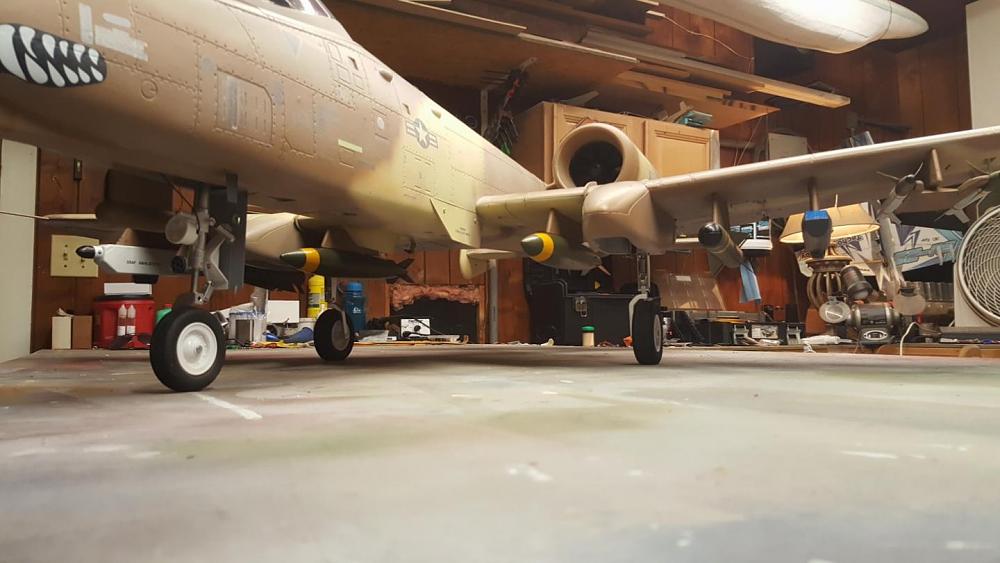

    Only thing better than one A-10, is four

      Sweeeeeet! And nice to see you joining the party Shirty!

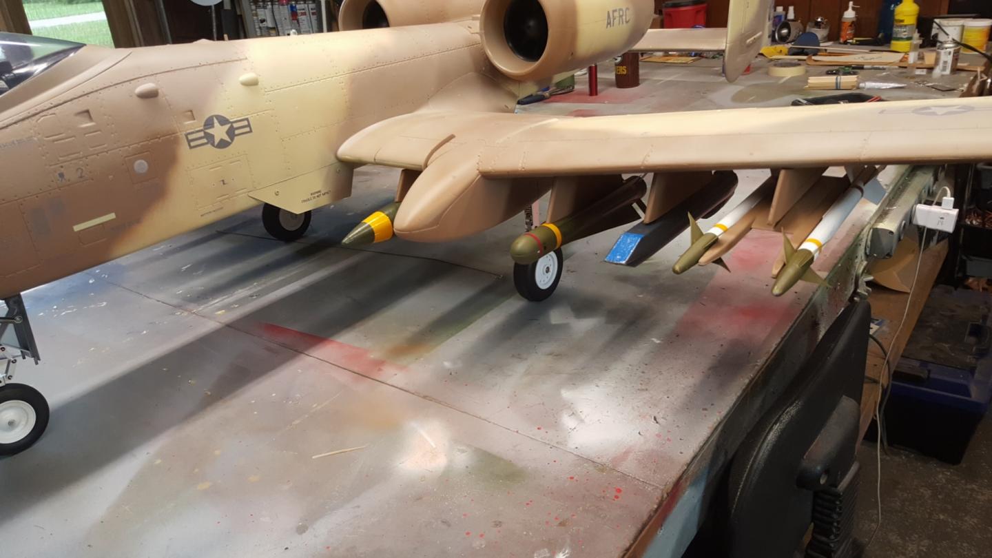

                  Originally posted by t33jetman
                  May I ask how you did that?
                  Awesome job!
                  It took 3+ hours to do the entire model. I used a bamboo skewer that I sanded down to about 5/32" and just lightly made the impressions. You do not need to actually puncture the foam, though I did get a little deep a time or three!! I altered the pattern here and there, as well as the spacing for a more authentic look. It really makes the panels stand out. I have her ready for the maiden, and I am going to wait to do the weathering until I have a few flights on her. The paint is Testor's Model Master rattle can in Dark Tan FS30219, Sand Beige-No FS, Testors 2910, and Modern Desert Sand FS33722. Then a coat of Matte Clear Krylon, decals, then 2 sealing coats of the Matte Clear. CRXmanPat's decals are stunning on the ordinance, which I also painted.

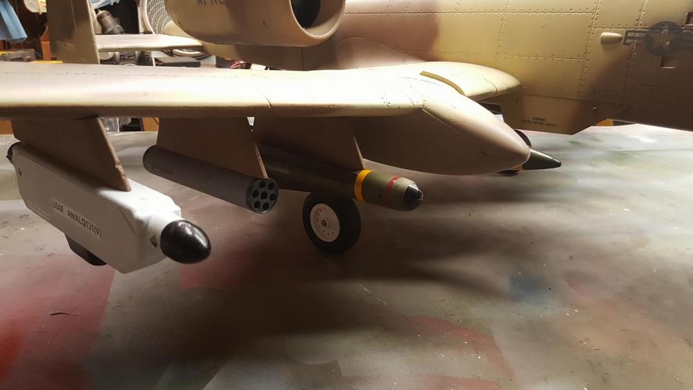

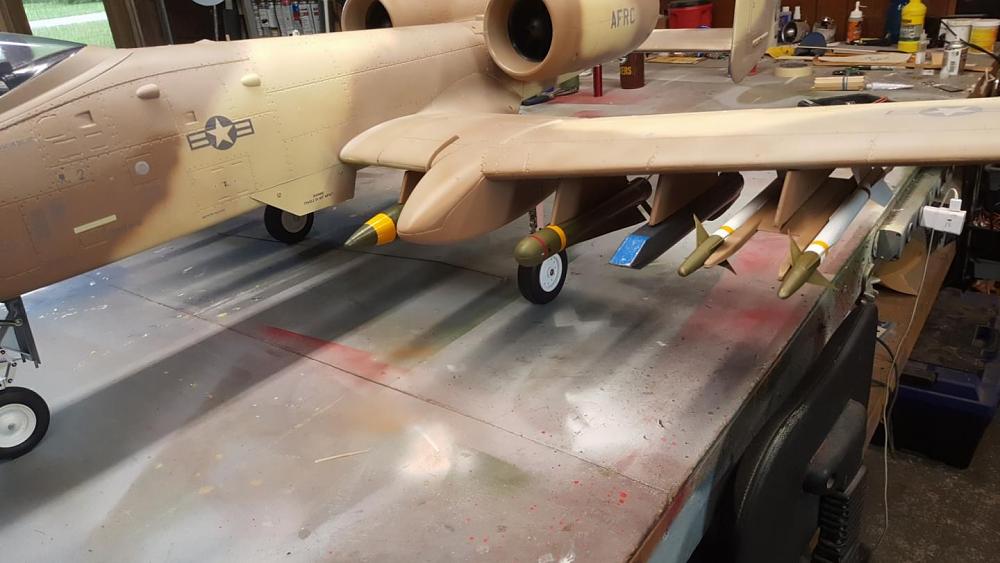

                    A few shots of the weapons on her!!!

                      Looks great Kloverzero!
