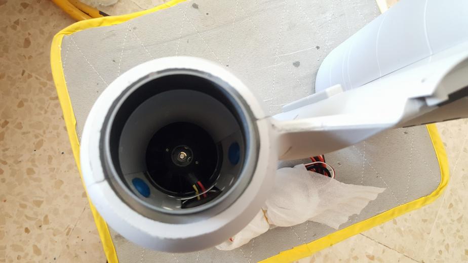

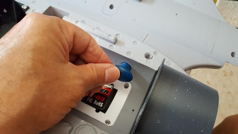

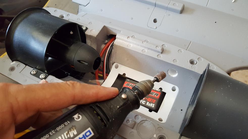

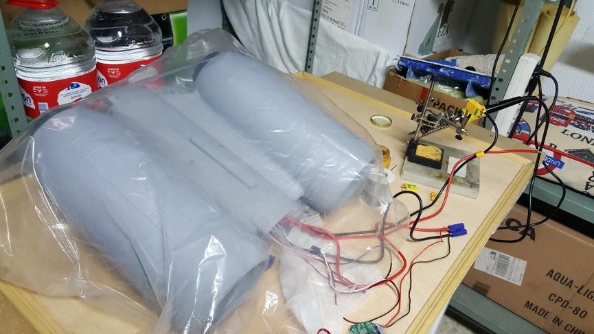

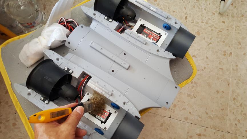

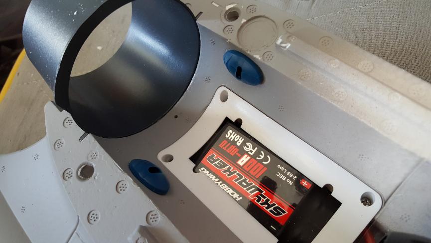

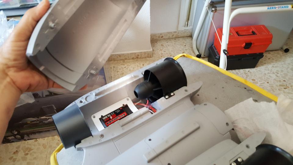

          Plan to to the carbon rods reinforcements on mine too...I bet you that you should not have anyproblem with these carbon reinforcements if you keep your receiver and mainly antenas out of these rods at least over 3 cm., I´m currently flying and during years 3D airplanes; ( Precision Aerobatics models, Extreme Flight and similars ).. and they like to do a very extensive use of carbon rods and carbon fiber reinforcements thin sheets ironed to the wood itself on their well built and designed airframes and never, never have any issue by radio interference...
          Start mine swapping EC5 connectors and adding the whistles too...
          Regards.
          Manolo.

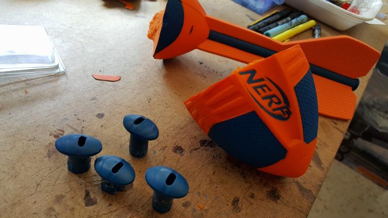

            Whistle while you work...
