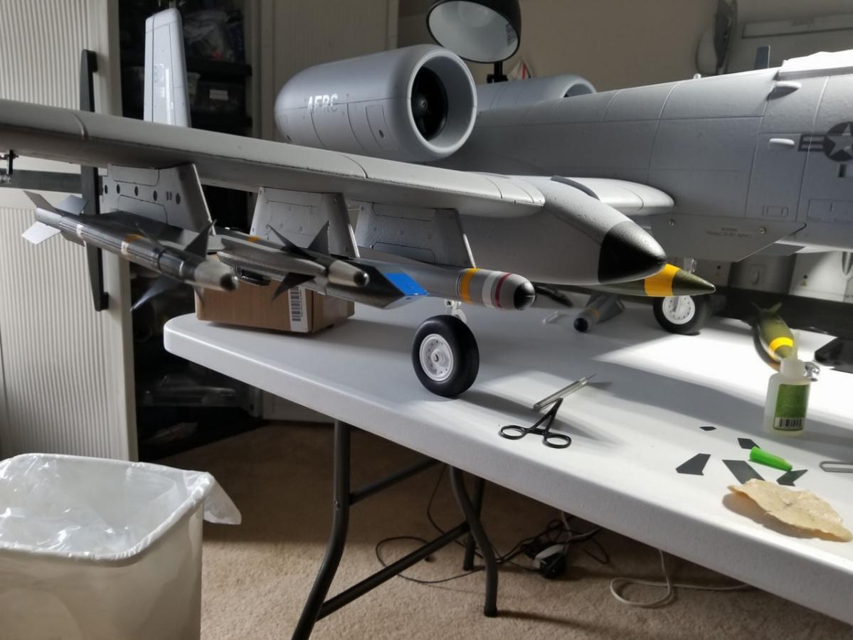

          I saw that too, but the set came with two Mav's and only one white stripe (as far as I could find on the decal sheet at least).
          Did we ever figure out what the white stripe is for?
            • 2137
            • On planet earth....right
            #4165
            It looks like it's an option for the maverick. One goes with the yellow and red stripe at the nose of the maverick, and the other one with the yellow and white stripe at the nose evidently. Here is two pictures on Motion's website that shows each wing Maverick being different.

              Of all the pics I've seen, the combinations are red/yellow for war shots, and blue/white for inert.
                    Yep. Yellow is definitely not a place to lean on while you are smoking... :)
                    For what it is worth: Mil-Std-709 is the bible for color coding stuff that goes bang. Have a gander at table 2. http://gigconceptsinc.com/files/MIL-STD-709D_1_.pdf

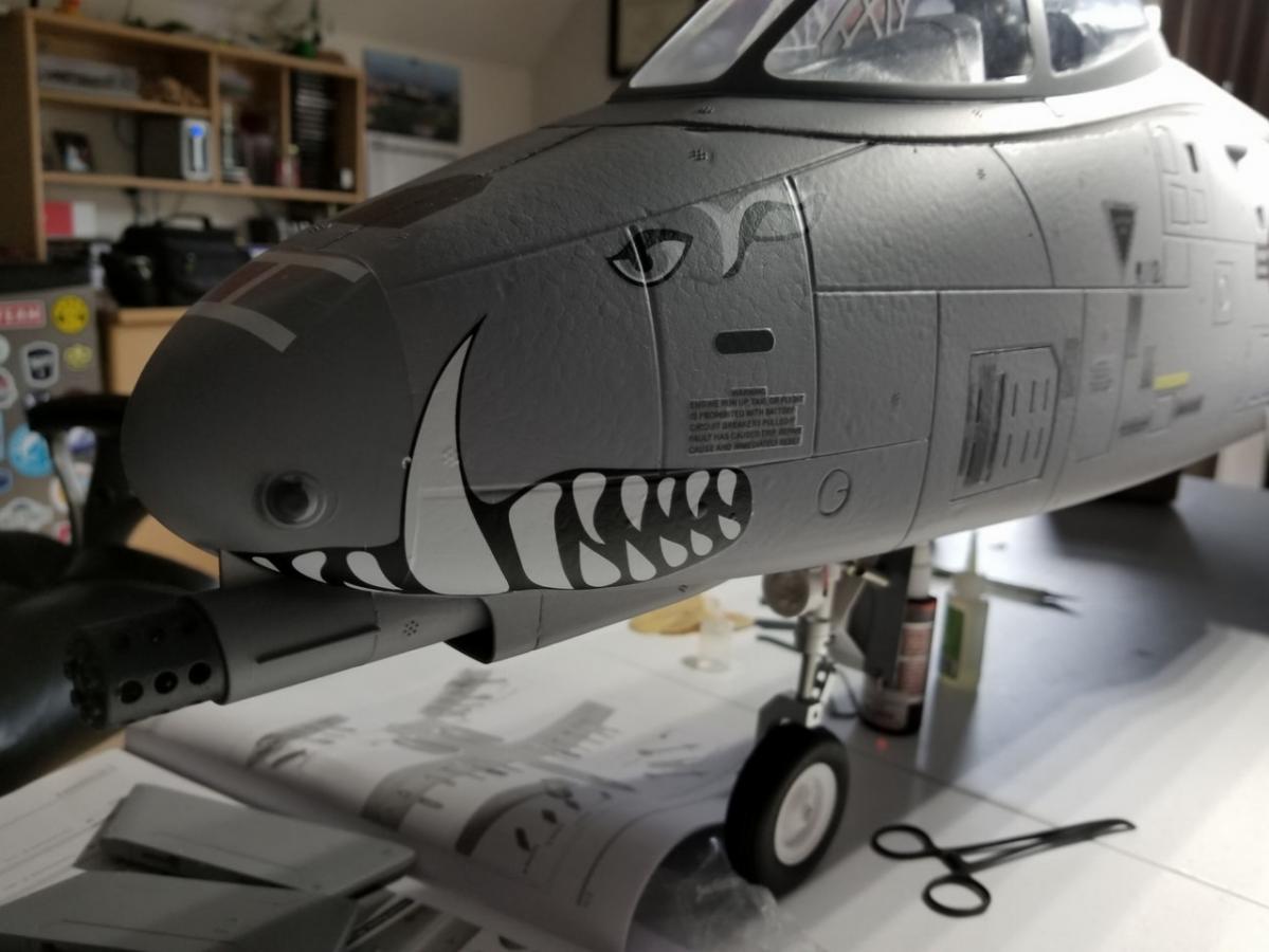

                      Thanks again all. While still on the subject of decals, I have a question regarding drying/handling time. I'm pretty much done with the water slides; at least the complicated ones. I'll add the wing stars and bars as well as the No Step ones later. I wanna start putting it together. :)​​​​​​​ I've already found one water slide had fallen off and I've seen others that are perhaps not quite set up yet. What's the drying time for the water slides? Or at least how long does one need to wait before handling it and the decal not rip or come off?

                          Thanks again all. While still on the subject of decals, I have a question regarding drying/handling time. I'm pretty much done with the water slides; at least the complicated ones. I'll add the wing stars and bars as well as the No Step ones later. I wanna start putting it together. :) I've already found one water slide had fallen off and I've seen others that are perhaps not quite set up yet. What's the drying time for the water slides? Or at least how long does one need to wait before handling it and the decal not rip or come off?
                          Here's my process:
                          Soak the decal in warm water for 15-20 seconds, then lay on a non-porous surface (I use my cutting mat).
                          Wet the area where the decal will be applied (I just use water, others use various other liquids like Windex and such).
                          With the backing paper still on, slide the decal off the paper directly onto the location on the plane.
                          Wet the area around the decal again if needed to get the decal in the exact spot you want it.
                          Apply a dry paper towel or soft cloth directly to the decal to remove excess liquid. On the bigger decals like the Stars & Bars, bubbles can be removed by gently wiping from the bubble to an outer edge. This also helps to remove any excess liquid trapped under the decal.
                          I usually give my decals about 5 minutes to dry, then apply a decal setting solution. My go-to setting solution is Walthers Solvaset.

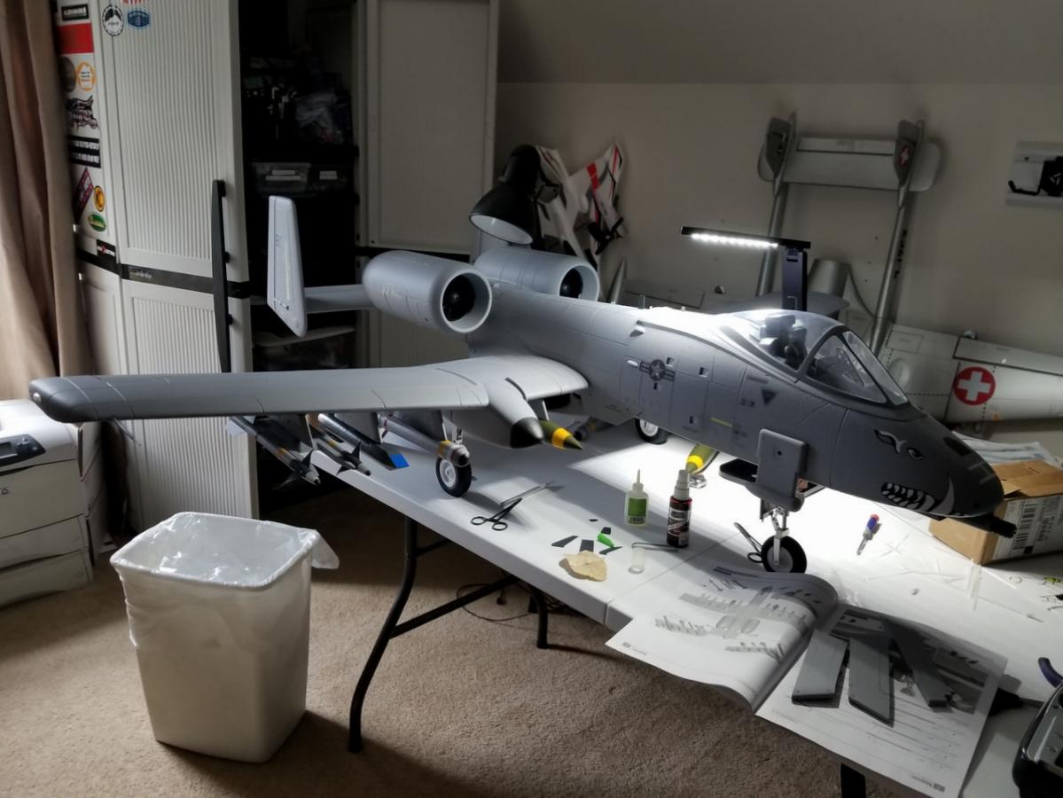

                                        Thanks for all the help guys. Almost done. Just have to mount the receiver, secure the batteries, apply a few more decals, and it's ready for the maiden flight. Saturday still ain't looking good but I'll have to make do if I don't want to wait another week.
