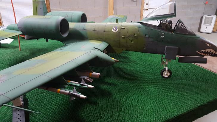

                    Originally posted by bcrc
                    Are you saying that I should use a water based paint in order to not have problems with the foam? Do you sand the existing grey paint before applying the latex? Can I spray latex? I'm scared that if I brush it, the brush strokes will show! I would much prefer to spray. Any options for spraying with a water based paint?

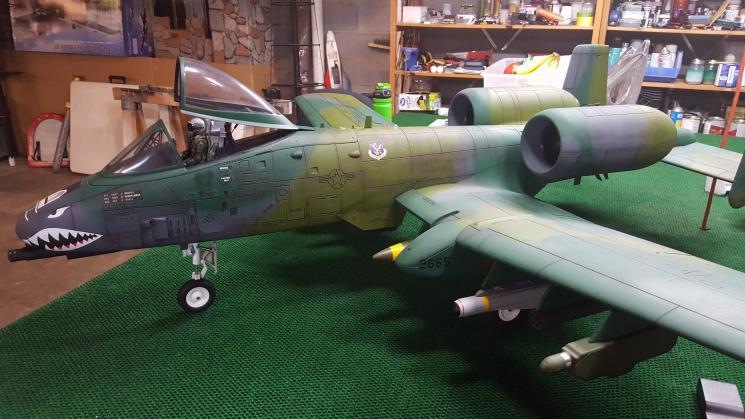

                    You can spray the latex sample paints with an airbrush. I did it for the first time on my A-10 and it turned out great! I thinned it with some Createx brand reducer about 1 part reducer to 3 parts paint and ran it through a 0.3mm tip on my airbrush. Others have thinned it with Windex. I have also brushed the same and by the time it dries there are very few brush marks visible if at all.
                    Click image for larger version  Name:	20170611_204554.jpg Views:	1 Size:	58.9 KB ID:	80832

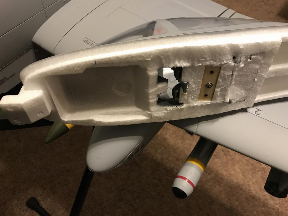

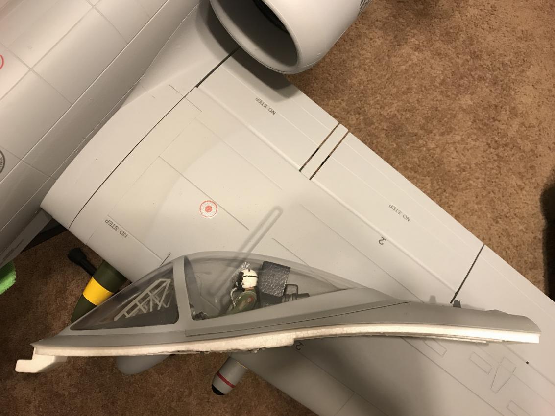

                      Originally posted by T-CAT
                      So, my 5000mah batteries wouldn't allow the canopy to shut properly and had to trim quite a bit off the bottom, removed the magnets, etc. You have to love foam for this reason, easy customization. I had to fix my pilot figure and the way it sits to make room for the batteries, but it actually turned out to be a good thing as it allowed me to move it further back against the seat and at a little better height.
ID:	80344Click image for larger version

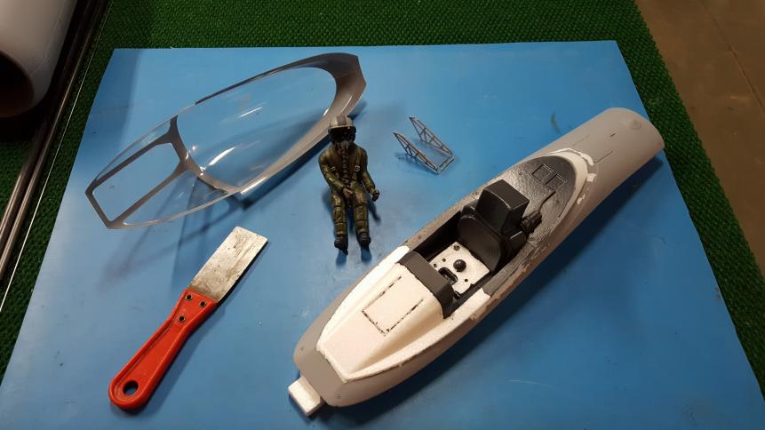

                      Hey T-Cat where did you get that pilot? It looks really good. Also how hard was it taking the canopy off without messing up the paint?
                        • 2137
                        • On planet earth....right
                        #4071
                        Thanks redandblue. These were from Hobbyking long ago when they sold some amazing pilot figures for a very reasonable price. Although it already came painted, it didn't look quite right and the mask was completely opposite of what it should be, so I repainted that mark and the accenting of the helmet. Unfortunately, I don't believe Hobbyking sells these pilots any longer, and would like to see a vendor carry these again (Motion....Motion.....Motion, calling to Motion, ha-ha). If they can find the molds or see if the original manufacturer is willing to reproduce these or someone else reproduce these, I'd love to see that.
                        Instead of taking off the canopy (I won't do that until I detail the whole cockpit), I trimmed the foam surrounding the bottom to fit my large LiPo's, kept a lip on the bottom following the contours of the original found at the beginning of the canopy foam. Once I cut out seat portion of the cockpit, I used the same foam and the wood block to secure my pilot to via the screw, and glue back in. This was a quick and easy mod to have a new pilot, and make room for my batteries, so that was a win-win.
                        Click image for larger version  Name:	IMG_1248.JPG Views:	1 Size:	96.0 KB ID:	80839Click image for larger version  Name:	IMG_1249.JPG Views:	1 Size:	88.6 KB ID:	80840

                              You can spray the latex sample paints with an airbrush. I did it for the first time on my A-10 and it turned out great! I thinned it with come Createx brand reducer about 1 part reducer to 3 parts paint and ran it through a 0.3mm tip on my airbrush. Others have thinned it with Windex. I have also brushed the same and by the time it dries there are very few brush marks visible if at all.
                              I've used a foam brush with latex paint with no brush marks visible at all. I don't have an air brush. The only issue is the paint going on this way is thick adding weight. Air brushing not so much. I'll borrow my brothers air brush.
                                    Popping the canopy off is not that difficult. I used a metal spatula about 1-1/4" wide. Once you get it started it comes right off. I did end up lifting the paint from the dash in the process but for me it was no big deal as I was going to sheet it with styrene anyway.
