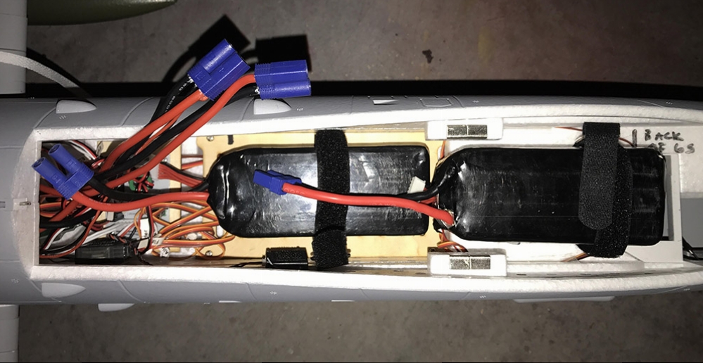

            No I haven't had to carve anything out...Here's a photo (It's at an angle so note the black vertical marks I etched in...The first one on the left is for the front of the first 6S and the second one on the right is for the back of the second 6S...
            That's close to where my Admirals are. The top one is flush with the step down. The lower one the end of the battery is lined up with the 2nd long oval on the wooden tray. Flys great, I have 5 flights on her.
                  Those are the old style Admiral 5000"s, if you got the new longer ones they will not fit properly on top rail. I am mixing mine with longer new ones on bottom and older ones on top...
                            Nice to see pics of the inside, thanks for posting.:Cool:

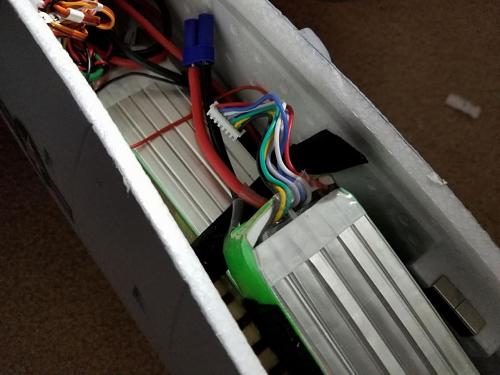

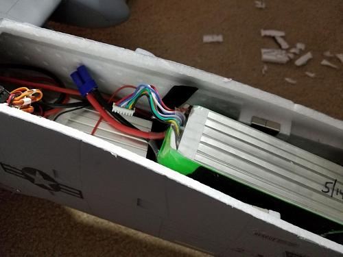

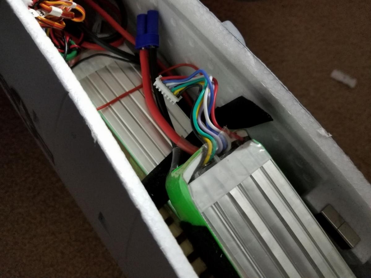

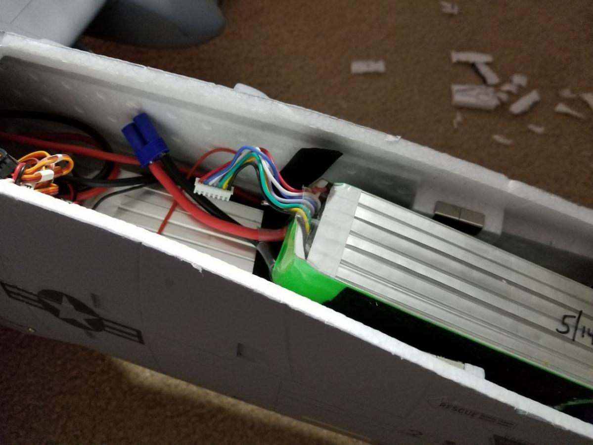

                                    Anyone else have to hog foam to balance the A-10? I had to carve out a channel in the bottom of the canopy as I had to stack the batteries in a weird way to get it to balance. Going to have to get creative with getting the front battery to stay in place.
ID:	81531Click image for larger version
ID:	81532Click image for larger version
                                      #4278
                                      move the control board back, you can easily slide it back and put the two front screws in the two rear screw holes in the fuse then you won't need to stack them like that.
