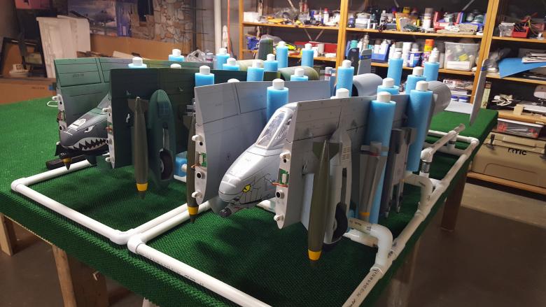

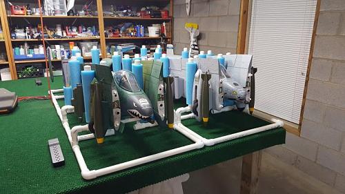

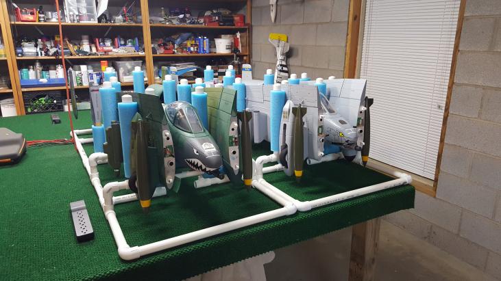

        As snug as two peas in a pod...
        I'm gonna need to rent a wider Uhaul trailer but at least they won't get damaged transporting them.
        Any chance we could get a pic of your cradles without the planes and foam spacers? I need to create one and yours looks awesome.
        Thanks,
        Bill D.
              I like what you've done, can you post a few pics without the plane to better help me understand the construction?
                #5267
                Bill and Dave, I will get some pics of a rack empty on my lunch break and get them posted up. Not a problem.

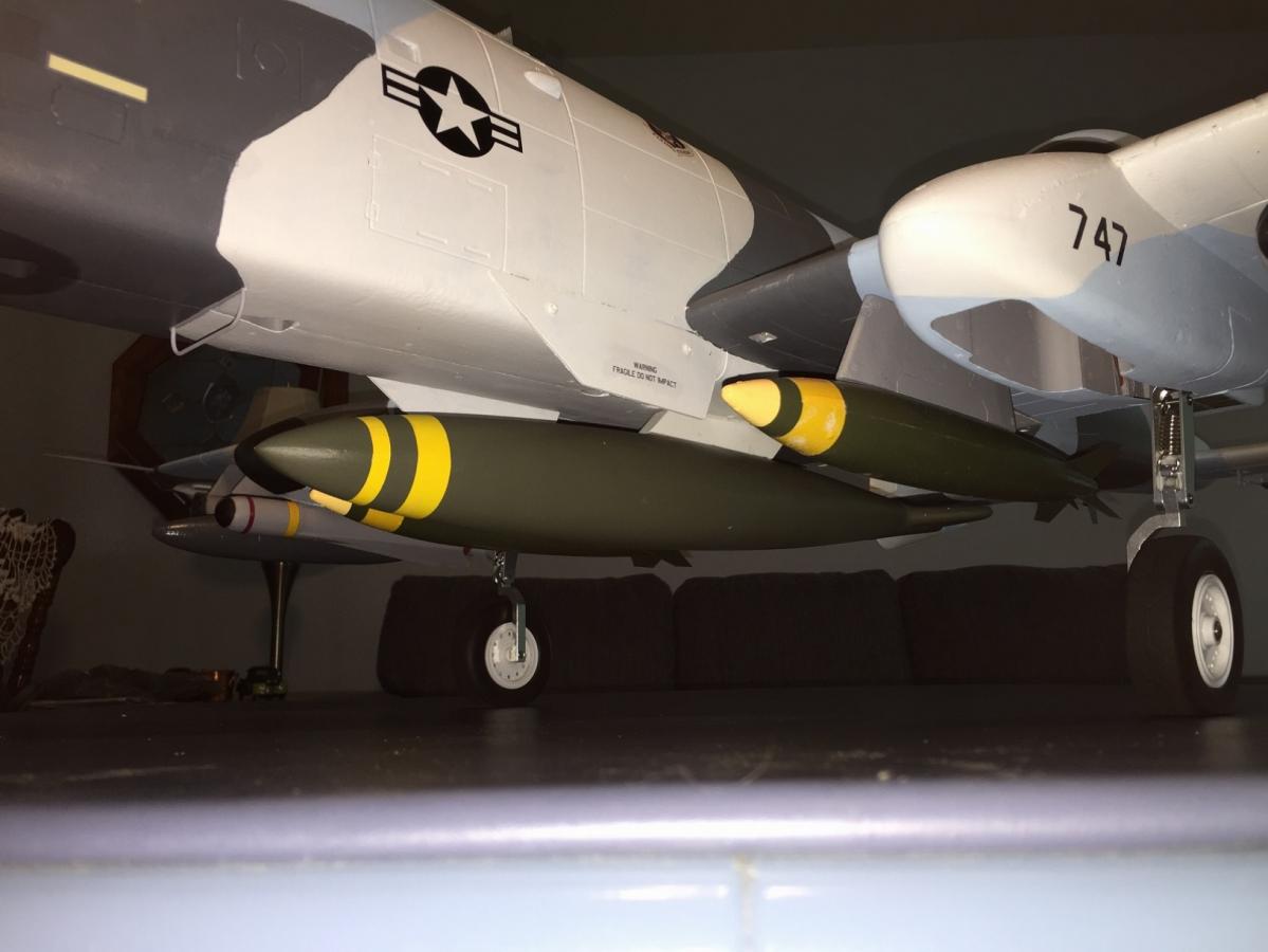

                            Wish I could help whereas I "HAD" (the operative word here) 2 extra drops from my Seagull Skyraider and one was put on the HSD Skyraider you saw # NEFI and now I've taken artistic latitude in putting the other as a centerline "bunkerbuster" on the Artic Thunder.
ID:	87301Click image for larger version

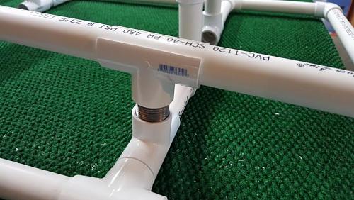

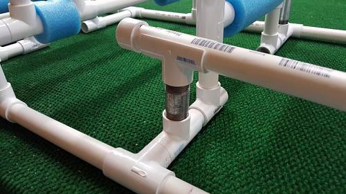

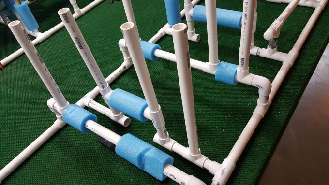

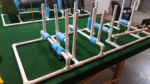

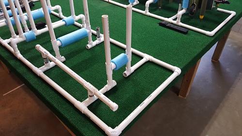

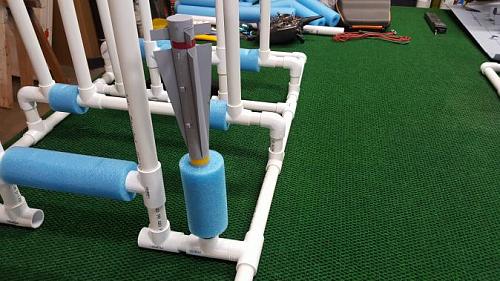

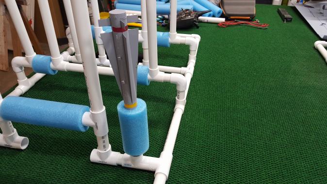

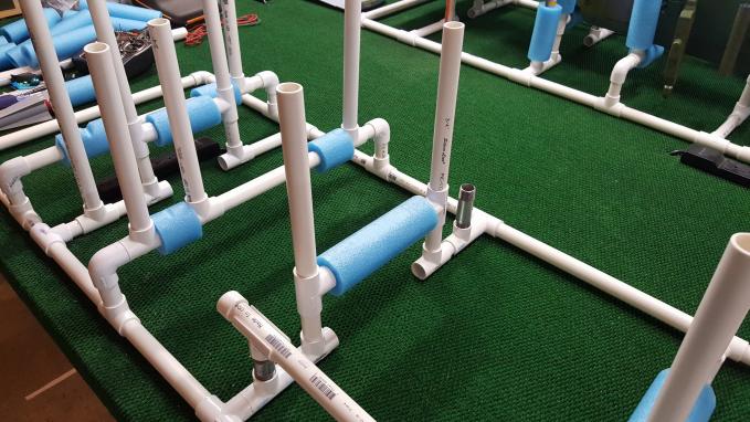

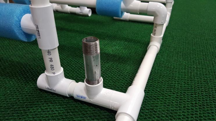

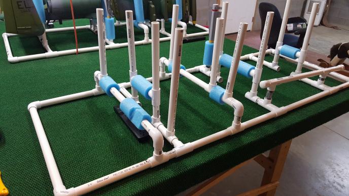

                                  Ok. Here's some pics without the plane and pool noodles at least on the verticals. It's all 3/4" PVC.
                                  Click image for larger version  Name:	20170714_123813.jpg Views:	1 Size:	56.7 KB ID:	87319
                                  Click image for larger version  Name:	20170714_123821.jpg Views:	1 Size:	53.8 KB ID:	87320
                                  Click image for larger version  Name:	20170714_123828.jpg Views:	1 Size:	57.8 KB ID:	87321
                                  Click image for larger version  Name:	20170714_123844.jpg Views:	1 Size:	57.3 KB ID:	87322
                                  Click image for larger version  Name:	20170714_123852.jpg Views:	1 Size:	55.6 KB ID:	87323
                                  Clip on PVC fittings...
                                  Click image for larger version  Name:	20170714_123856.jpg Views:	1 Size:	55.2 KB ID:	87324
                                  Click image for larger version  Name:	20170714_123901.jpg Views:	1 Size:	56.8 KB ID:	87325
                                  The wing spars go in here.
                                  Click image for larger version  Name:	20170714_123917.jpg Views:	1 Size:	51.3 KB ID:	87326
                                  One more clip on holds this nipple..
                                  Click image for larger version  Name:	20170714_123929.jpg Views:	1 Size:	53.7 KB ID:	87327
                                  I have to remove 1 Maverick and this is where I put it.
                                  Click image for larger version  Name:	20170714_123949.jpg Views:	1 Size:	55.1 KB ID:	87328
