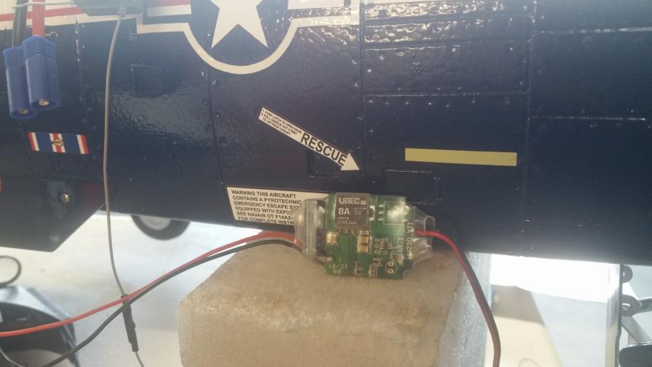

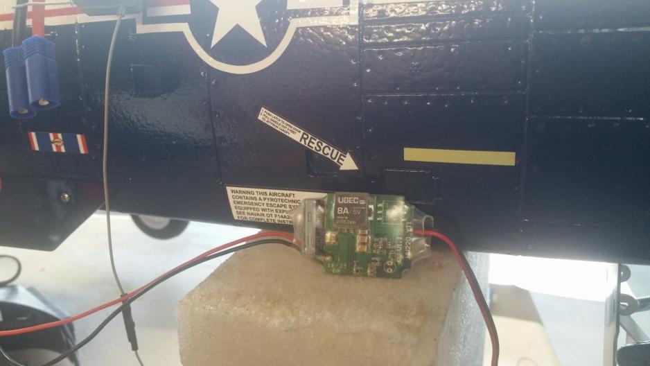

              How did you hook up UBEC?
              Did you cut the red wire off the throttle wire going to the reciver?
                #5287
                DON'T DO THAT..........if you want your system to have power for the Rx to power everything

                  So what do you do with the UBEC wire coming off one of the motor plug???? Leave it unplugged? Or plug it into an open chsnnel? Click image for larger version
                    So what do you do with the UBEC wire coming off one of the motor plug???? Leave it unplugged? Or plug it into an open channel?
                    Plug into any open chan port on the Rx (the bind port is good also)
                      #5290
                      Plug the throttle leads from the ESC's into your connector board and plug the lead from the BEC into your receiver bind port or battery port if you have one. The throttle lead from the connector board goes to the throttle on your receiver. If I am not mistaken the ESC's don't have built in BEC's so there is no need to lift a red wire although I honestly don't think it would matter if you did on anything other than the red wire from the BEC..
                        #5291
                        t33jetman.......the two throttle leads from the Opto ESC's plug into the two throttle connectors on the top of the main connection board as shown on page 7 of the manual.
                        Freewing messed up by not advising about the UBEC in the manual but this was caught early on and discussed in the early portions of this thread.;)

                              Thanks alot, and yes it was not covered in the manual. Hate to get this far and burn something up..
