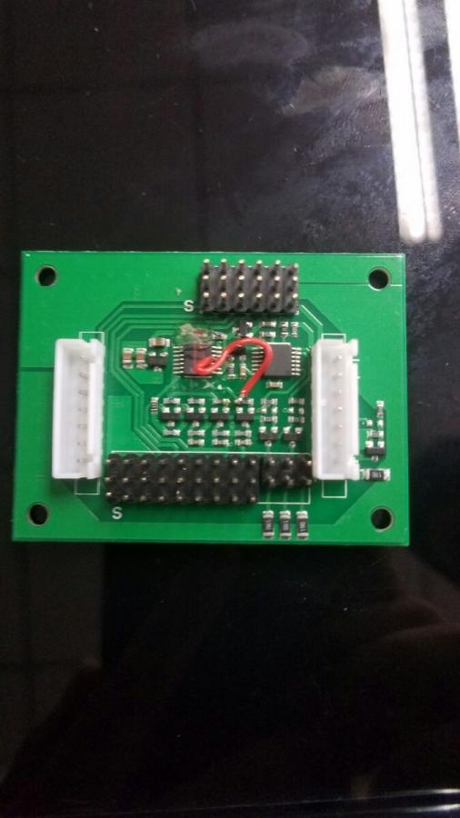

                    Also, to follow up on those asking if the forward nose door can stay open while the nose gear is deployed, here's something we've worked on at the factory that will allow that functionality. To be clear, if your A-10 door currently closes with the nose gear deployed, DO NOT ATTEMPT THIS MOD. I'm still testing it to verify that it really is as simple as soldering a jumper wire between these two points, and doesn't require a re-flash of the board itself. If and when I verify it's that simple, then I'll post it here and the handful of us who want that functionality can decide if they want to attempt the soldering job. Even then, attempting this mod will void the board's warranty. I'm more so showing it just to demonstrate another example of us trying to incorporate customer feedback into our aircraft. We can't always chase down the rabbit hole on every request, but we do try to tackle a fair amount of them.
                    Click image for larger version Name:	Circuit Board Door Stays Open mod.jpg Views:	1 Size:	44.2 KB ID:	80403
                    I hope you're enjoying my little bird, everyone! :D
                    Alpha, I did not do this modification that you described above, but it's good to reference it because the topic has to do with getting the nose gear door to stay open while the gear is extended. Since I went through the method of just doing the mixing in my TX (removed nose gear door servo lead from the main board, plugged it into an open receiver channel, and mixed it with the retract channel), the board is likely still sending power to that nose gear port on the board to close the gear door after the gear is extended. However, since the servo lead isn't attached to the board in the nose gear door port, it can't, and that's good. For safety though, I want to see if you found any issue with that via testing. I would assume that as long as nothing touches the open/revealed pins at the nose gear door port on the main board, there wouldn't likely be any way to short anything out, correct?
