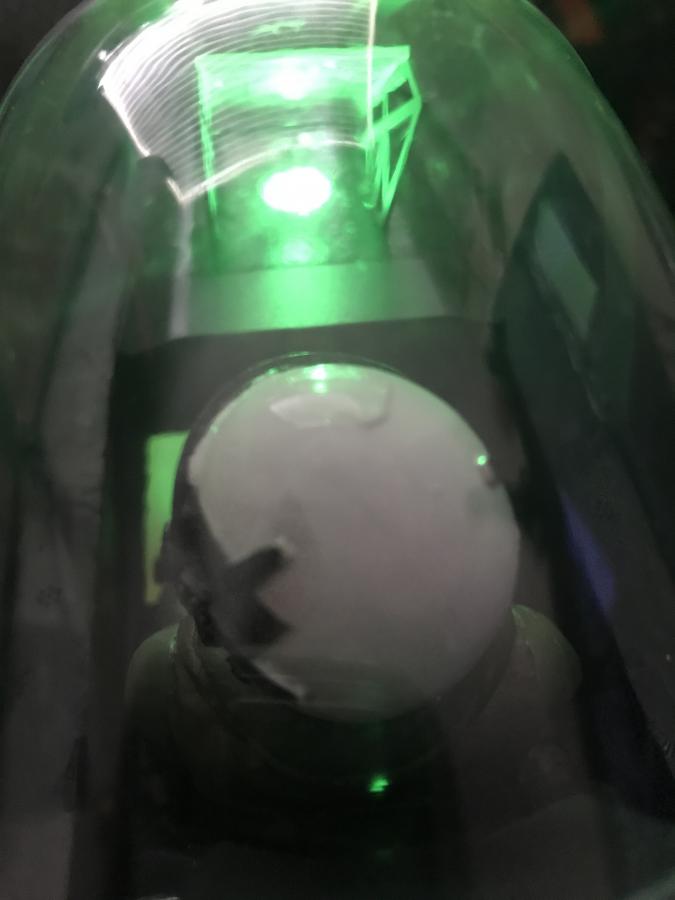

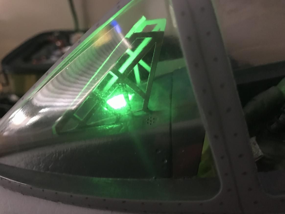

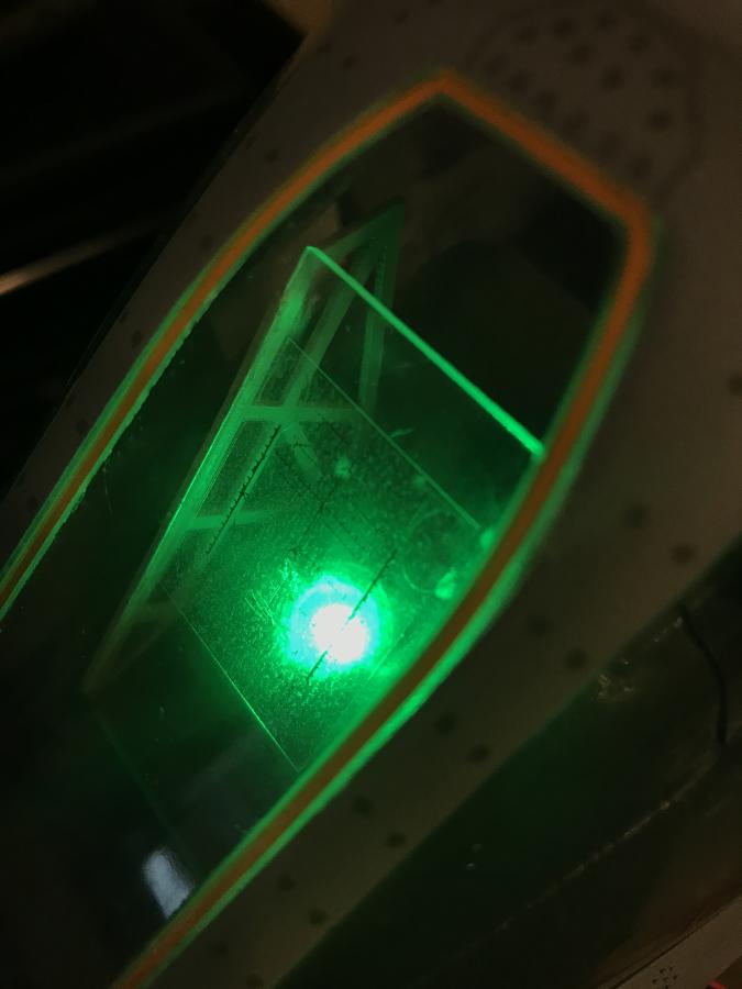

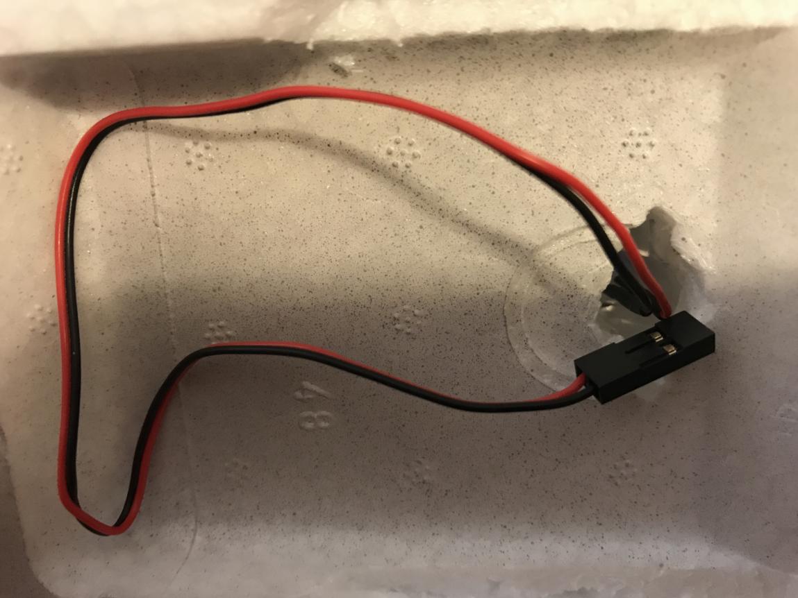

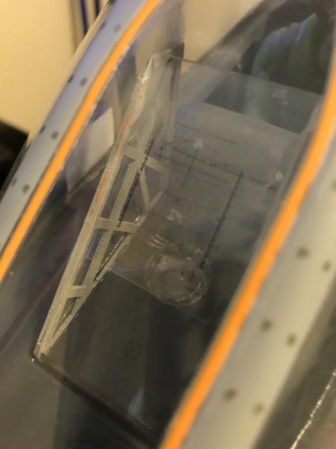

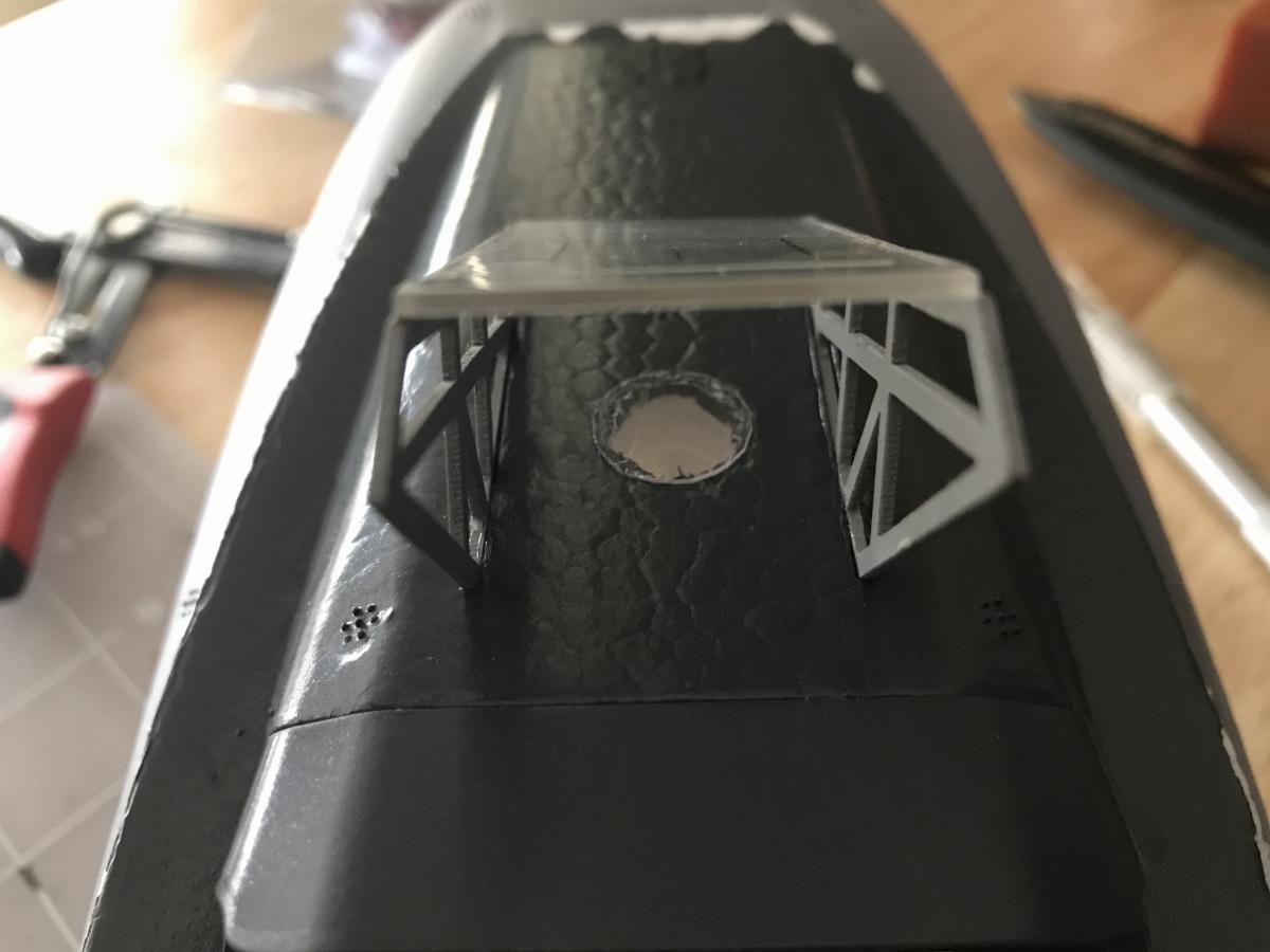

            I had some fun with adding a green LED NAV light to simulate a HUD. I made a harness to tap power off the landing light port so the HUD light is only active when the landing gear is extended, so it gives a fun factor for folks seeing it on the ground during static power-on display, taxi to and from the runway, and during takeoff and landings.

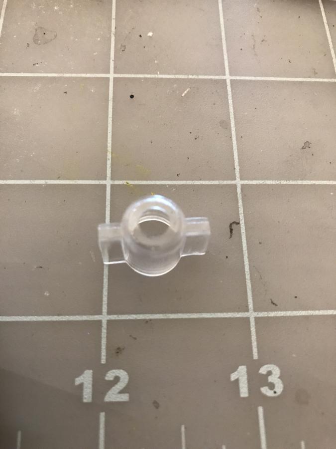

            I drilled the hole out with a large drill bit, painted the exposed foam, cut a piece of round plastic to cover the hole, and then embedded a plastic LED holder deeper down in the foam hole to hold the LED in place (the plastic holder is simply pressure fitted in and needs no glue). I then made a decal of heads up display markings to give a subtle effect on the HUD screen. It's silly and useless, but it sure is fun, ha-ha. :)

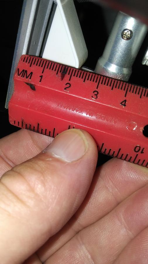

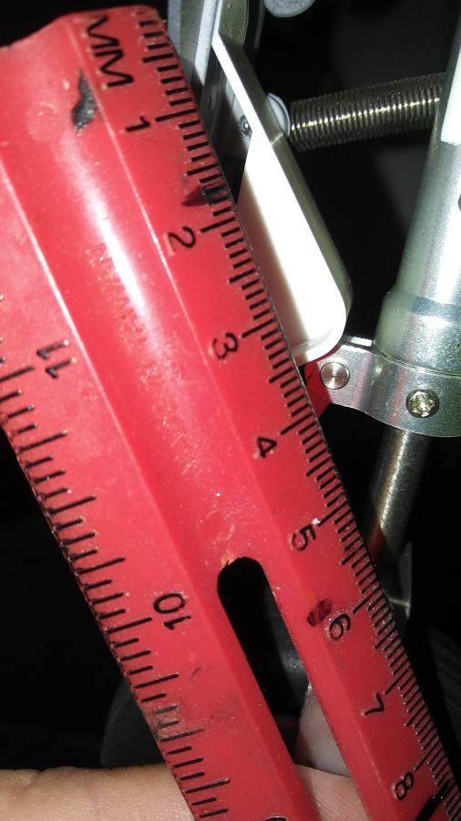

                  This will help. Here are the dims. Maybe you can make a few tonite and try for Sunday ?
                  look in the shop...kitchen...junk drawer for styrene or sheet stock of suitable.
                  Pete
                  • Pete Lane
                    Turbine lover
                    • 290
                    • Los Gatos Cally
                    #5309
                    Heat gun should make plastic plyable.
                    Tupperware...Folgers can...tin paint can top...etc
                    Gloves a must until deburred
                    LMK if you need any other measurements or pics

                      I ordered a new gear door. When it comes I'll fasten it with screws.

                          Cool T-CAT.... get this over on the mod thread too.
