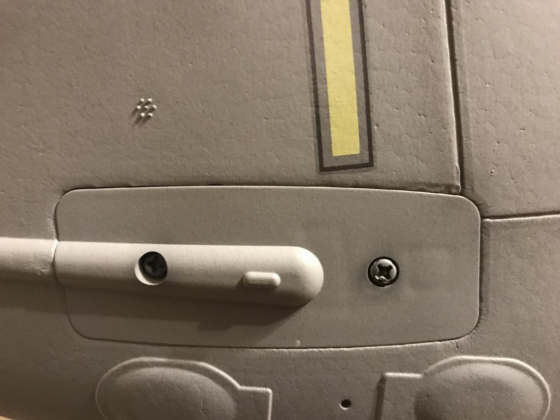

              Today I had to bring out the airbrush again because the eyesore of servos, control rod, ball link, and pushrod keeper were bothering me. They stand out a lot. After I weathered the plane a week a couple weeks ago, I didn't think the servos would still bother me as much since the weathering tones down the planes brightness, but I was wrong. I mixed my own paint since I didn't take any parts to the hardware store for a paint match, and kept mixing black and white opaque colors until it was close. I'd spray, let it dry, check the color, mix again, and repeat until it was good enough. I painted each wing servo, the rudder servos (these were by far the largest difference after painting since they are the most noticeable), and the elevator servos. I also touched up all the visible screws on the jet, and when gray they don't stand out nearly as much as when silver.

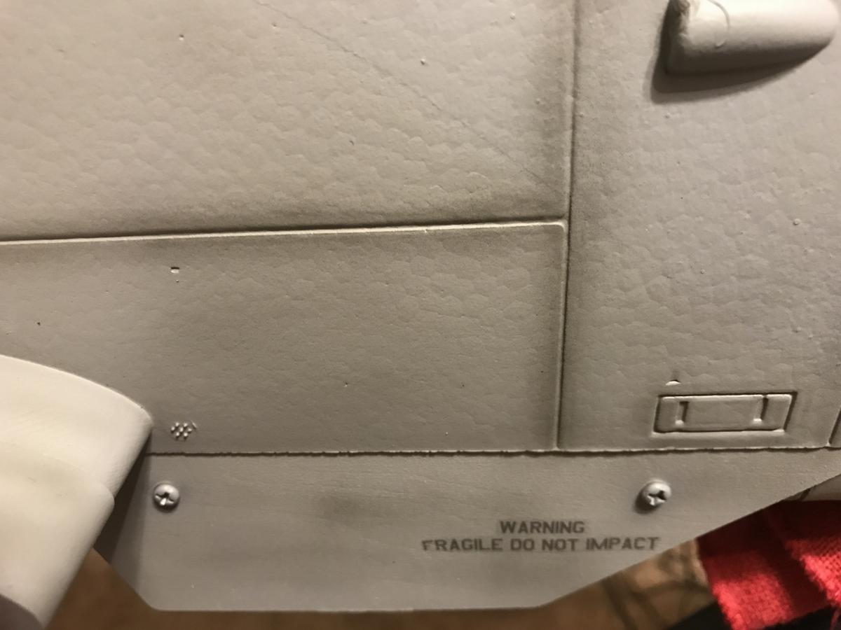

                Just in case, I have attached a picture on the waterslide decal sheet for you to reference the position of that specific one.

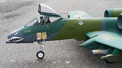

                          Since mine is fun scale I get to cheat a bit and also made up a new interior color to fend off those pesky gators. I then drilled two holes in the canopy rear deck and made a screen cover out of a section from my fly swatter...lol

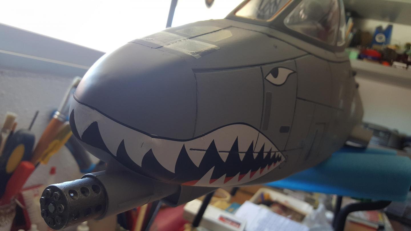

                                So, next question: (sorry guys). I downloaded nearly everyone's pics of the sharks mouth applied to get an idea on how to set it up, but seems everyone's done it slightly different. BUT, it seems where the two decals join in the centre, that everyone has cut or painted in black the gap where they join? Is that how to do it? Seems no one has the gap, or have made a tooth to cover the middle? Cheers.
                                Click image for larger version  Name:	IMG_1289.JPG Views:	1 Size:	74.6 KB ID:	87636Click image for larger version  Name:	IMG_1274.JPG Views:	1 Size:	51.8 KB ID:	87631Click image for larger version  Name:	IMG_1270.JPG Views:	1 Size:	307.2 KB ID:	87632Click image for larger version  Name:	IMG_1284.JPG Views:	2 Size:	73.5 KB ID:	87633Click image for larger version  Name:	IMG_1283.JPG Views:	1 Size:	103.0 KB ID:	87634Click image for larger version  Name:	IMG_1272.JPG Views:	1 Size:	147.5 KB ID:	87635
                                    Mine clearly needs braces but it's good enough for me. The offset of the gun kinda messes with making it symmetrical and I have never seen a shark with perfect teeth anyway. LOL

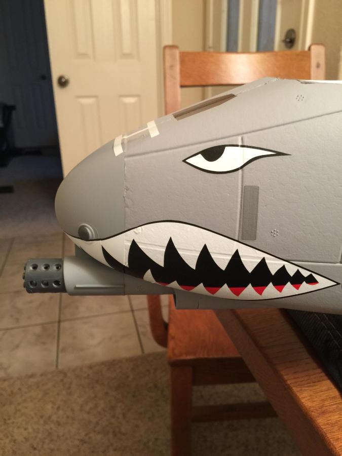

                                      Lol, i like yours best! How did you close up the gap in the middle mate? No one seems to have this gap like the pic of mine on the table... what am I missing? :-S
                                        #5339
                                        I cut and overlapped the decal across the front. I based placement on the blisters on either side of the nose and let the front take up the difference. If you dry fit base on the blisters you will see that the decal overlaps a lot in front so I just made strategic cuts to allow the overlapping to look decent. If you look closely you can see where I did it. Notice too where I lined up the back of the mouth. I also had to trim away some on the bottom around the gun. Any places that were broken lines I just touched up with paint.
