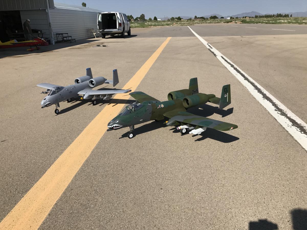

    Here's mine (the camo version) and a friends at the maiden of mine yesterday. Uneventful maiden is the only words that come to mind.
    Mike

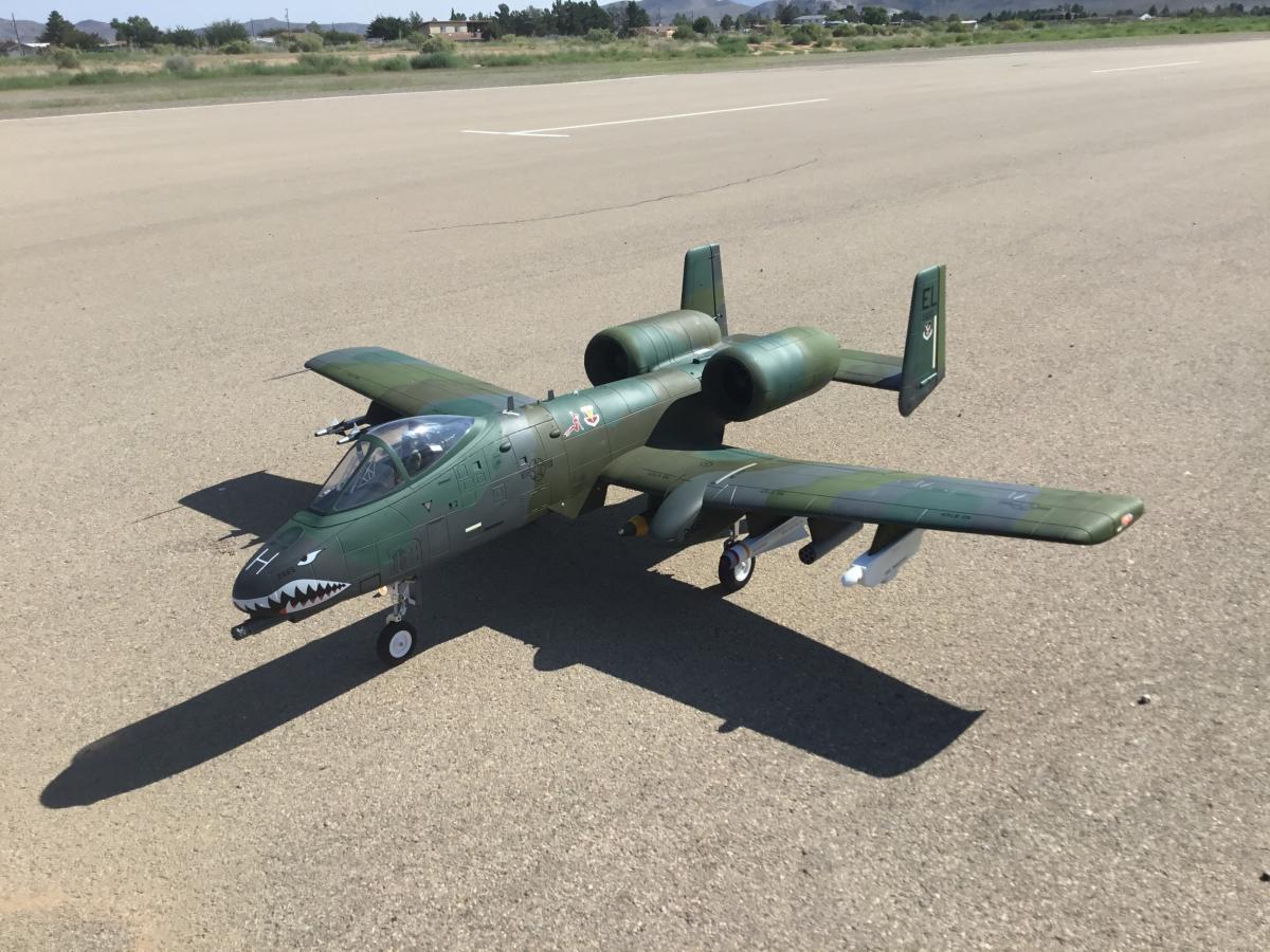

      I was looking at the rack of Dubro stuff at the LHS and the button screws (#537) looked about right so I bought them. There was plenty of meat to drill the hole a bit larger do that's what I went with. Guess I could have gone metric but the though never crossed my mind..
      Mike
      Beautiful Mike. Looks awesome!
        Thanks I'm really happy with the end result. Looking forward to a full winter of flying it here. This 90+ degree stuff is getting old.

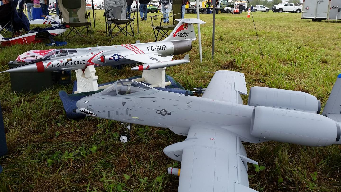

            At the Dayton D.O.G.S. show today! Click image for larger version
ID:	95279Click image for larger version
