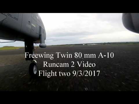

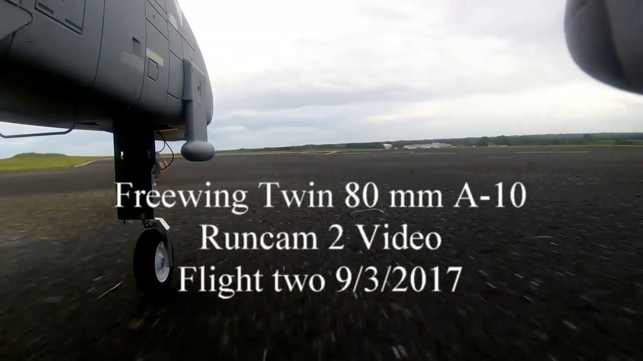

        I have to agree. Three flights on mine this morning and the 1st one should have done it in since I let it get too slow and didn't have enough airspeed to properly flare. The nose wheel was the 1st thing to touch the tarmac but the dance of death did not follow..
        Second flight was one of those "unicorn" landings. Speed and angle of attack were just right.
        Third flight was another good landing but I almost kissed the tarmac on one of the low passes.

              Thanks Tim and T. I like having videos from the ground but since I can't run camera and fly at the same time, on board is about the only documentation I have.
              Love the way this model flies. Landing damage, not so much. Kudos to TI for coming up with this fix. I'll still be trying the oleo struts when they get here but this should save a lot of wear and tear in the meantime.
