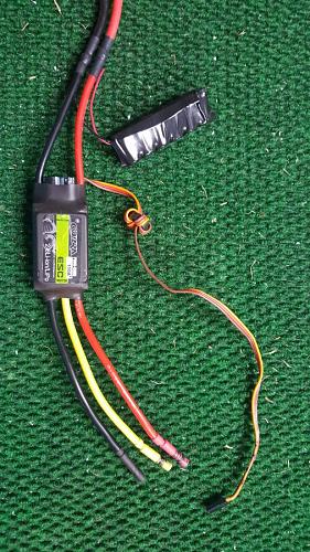

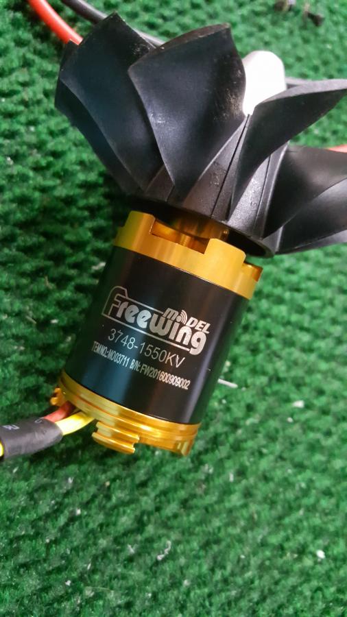

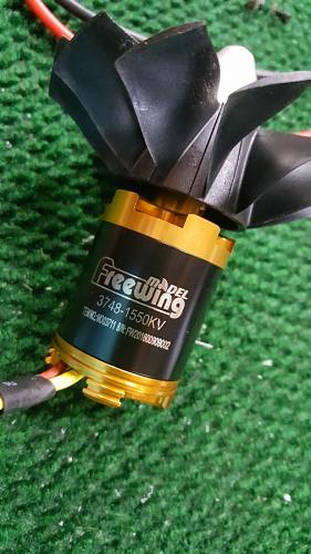

                                  T-CAT... it looks really good. You have done an outstanding job on it. Have you installed cap packs in the nacelles for your setup? Reason I ask is I just lost both ESC's in my 90mm Blacksnakes and I am trying to figure out if it was the ESC's or something else. I have cap packs on mine of 6 caps each of the same rating as the caps on the ESC's and they seem fine but the caps on both ESC's spewed and one stopped working altogether. Fortunately there was no loss of the aircraft and I am in the process of replacing the ESC's which simply could have gotten too hot but I have not heard of anyone else having any problems. I was using Cobra 150A ESC's and am swapping them out with Gekko 125A ESC's. I had one and had to order another which will be here Friday. I checked the amp draw on the one I installed and on 6S the 1750kV 12b fan was pulling right at 100 amps. I must admit the whole thing has me just a little rattled.
                                    Ugh, I am sorry to hear that, as I was worried about this as well. I am using two new Freewing 130A ESC's but with Castle Cap Packs attached, one on each ESC as close as possible to the ESC's. Once I solder them up and get them running, I will be sure to test the temparture of each ESC under ground operation, then take a temperature test again upon landing after the first flight. It sounds like you are using the 1550kv motor on the Freewing 90mm EDF with 12-blade fan. I am using the same EDF/motor combo. Seeing the cap packs give out must have been uncomfortable for sure. What gauge wiring is on the ESC battery leads of the Cobra's?

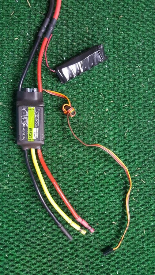

                                      My cap packs are fine it is the caps on the ESC's that gave it up. Yes, I am using the 1550kV motors... my bad.
                                      The Cobra ESC's have 12 ga. wire on the leads.
                                        Click image for larger version  Name:	20170823_194819.jpg Views:	1 Size:	70.1 KB ID:	93965
                                        Click image for larger version  Name:	20170823_195921.jpg Views:	1 Size:	141.1 KB ID:	93966
                                        Awe gotcha. The caps on the ESC gave way. I wonder if those ESC's are overrated. They look to be about the same size as a Hobbywing 100A, or is the picture just making it seem that way? Maybe they are suited for applications under 100A, although these 1550kv motors are usually in the 100-110A range, so not terribly far from that territory. However, that still may have taxed it too much if the ESC's are truly overrated. The 12 gauge wiring also makes me wonder if the Cobra ESC's truly are rated to 150A. On an ESC in that range, usually 10 or 8 gauge wiring is used to play it on the safe side. I would think those ZTW Gecko ESC's you have in mind would be much better for durability and longevity than the current Cobra's.
                                          #6200
                                          The Cobras are rated for 150A but they are smaller and lighter than the 125A Gekkos... It was the first time I have ever tried the Cobras which I got for a really good price at NEFI. I figured ehhh... It was worth a try.
