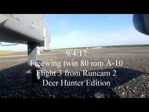

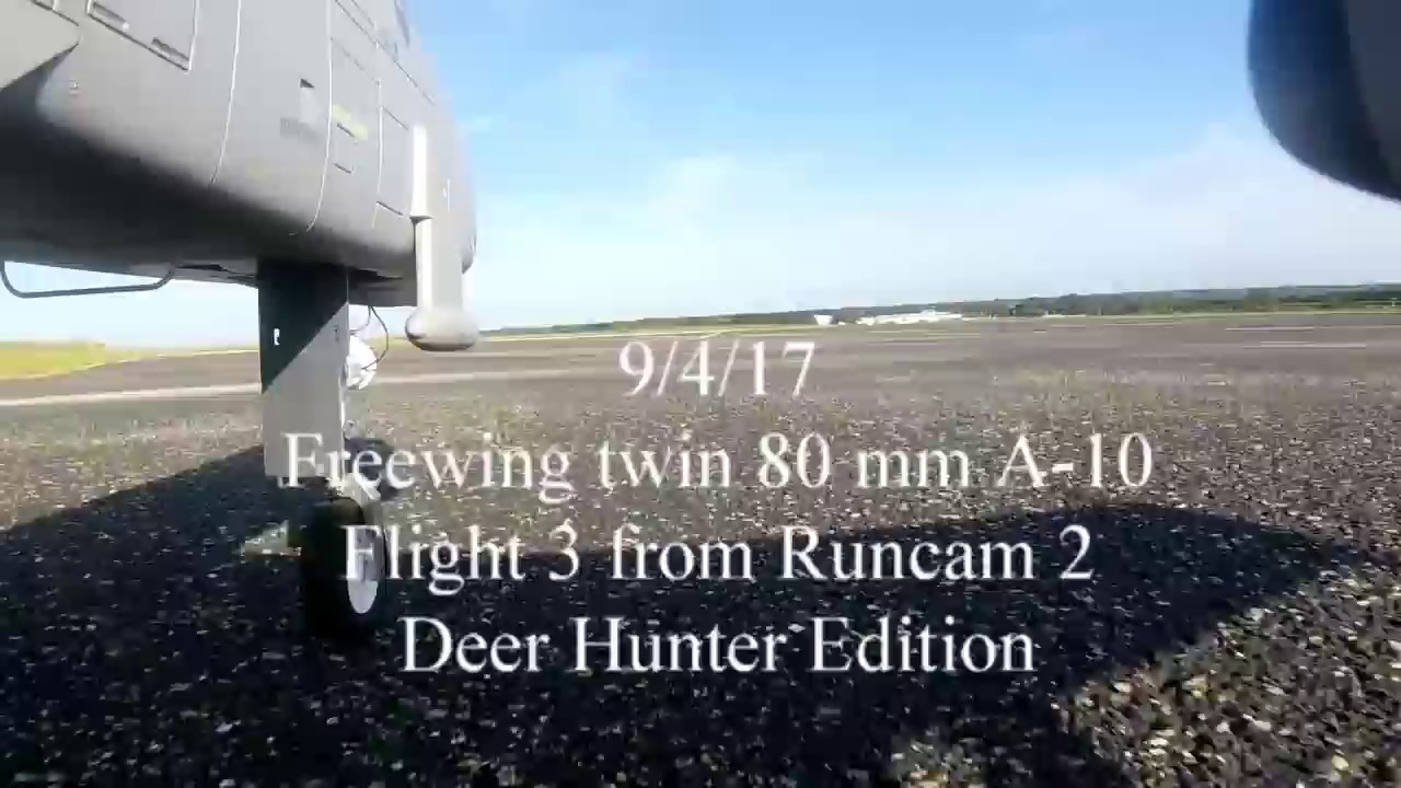

                  #6368
                  Put another 4 flights on mine this morning. This is the special "deer hunter" edition. Note that no wildlife was harmed or harassed in the making of this video. The deer that hang around our field are accustomed to model aircraft buzzing about. I did however capture a unicorn during the landing. :a10
