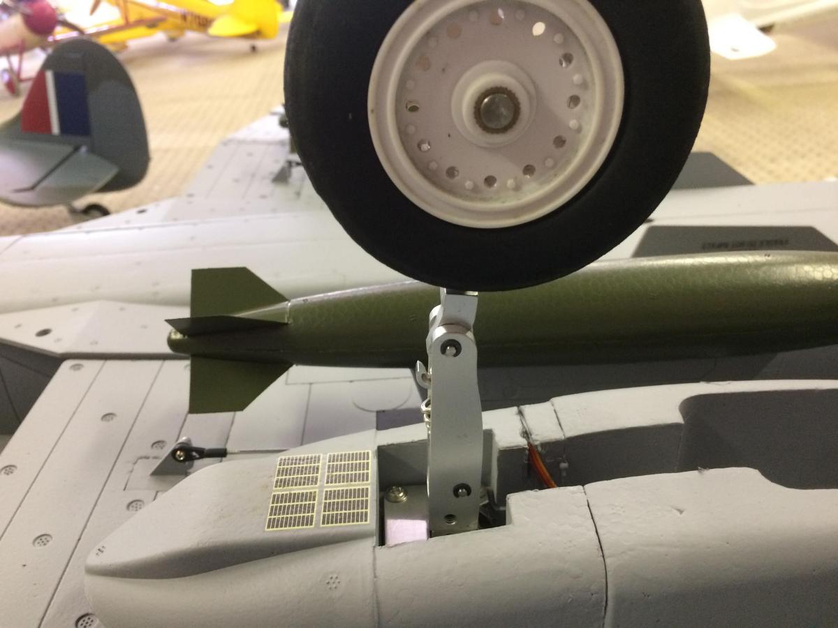

                I see many getting discouraged about this plane over the bouncing and nose wheel issues caused by it but if you do these simple fixes you can fly her on grass, pavement or textile without bouncing and you will have a solid, straight nose wheel.
                I know I have some naysayers but I have over 30 bounce free flights with this setup and several others are having success with this setup as well.

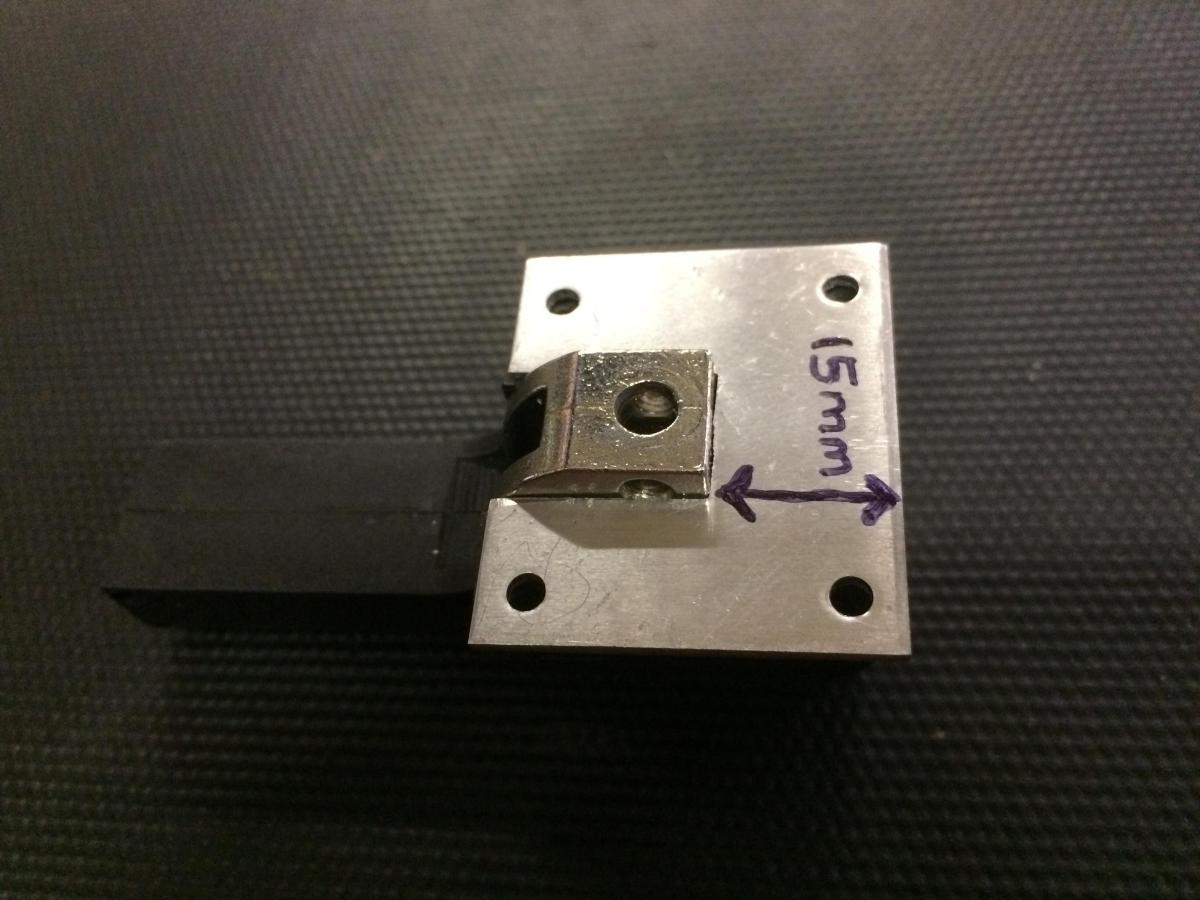

                1: Reverse the freaking struts, to do this you need to take the plastic covers off of the main gear retracts (throw them in the trash so you can tighten the struts when they get loose), then remove the strut from the retract and move it to the other side with the wheel facing the wingtip. You may need to clearance the strut and plate like the pictures below, some haven't had to do it but some have.

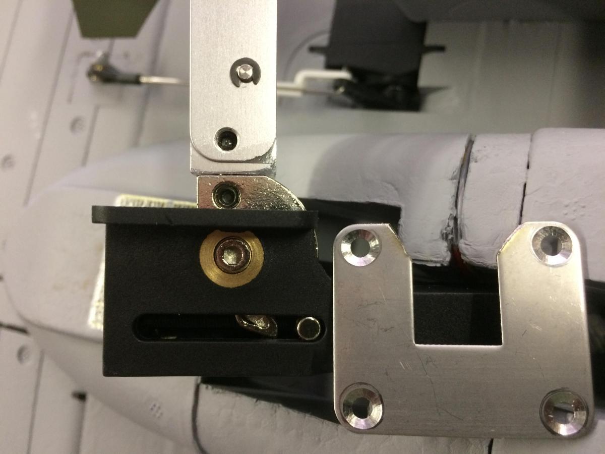

                2: Make a new retract plate using the old one as a template but make the slot where the trunion rotates less shallow (see picture below) so it will stop the trunion travel and keep the strut from bending back. Put the original plate back on top of the new one for extra support.
                3: Cut about 3/8" off the nose wheel strut spring (sorry no picture).

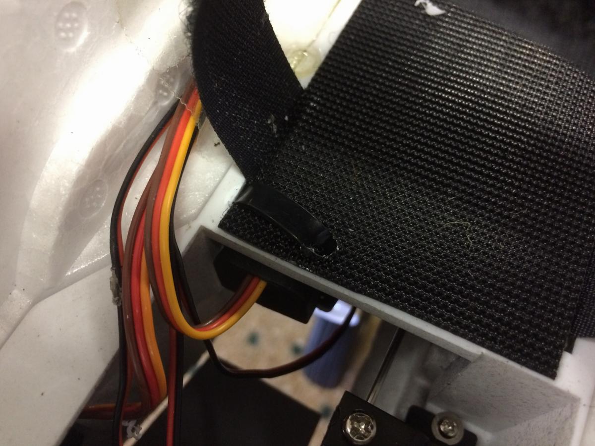

                4: To give the retract a little more strength you can drill a hole through the battery tray and run a zip tie around the long end of the retract (again, see picture below).
                *Bonus* If you have already broken the nose gear strut pin and are having trouble getting a new one the Freewing 1600mm Spitfire axles work great if you cut down the flange a little and cut a second flat on them.
                This will be the last I post about this fix, use it or not but if you want a really great taking off, flying and landing A-10 this will do it.
