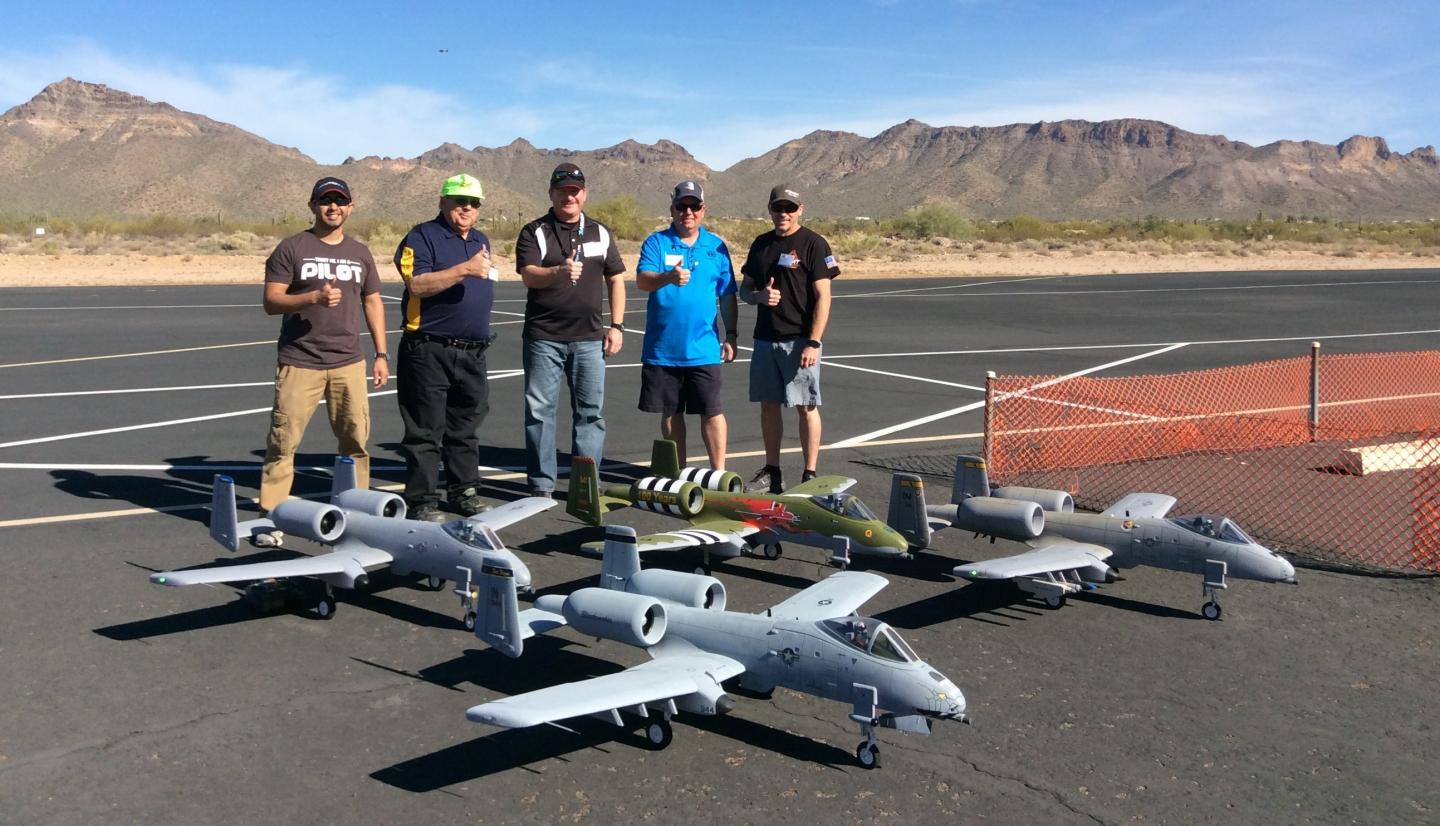

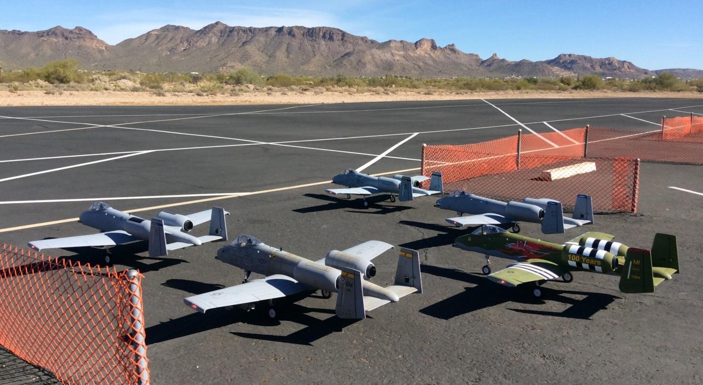

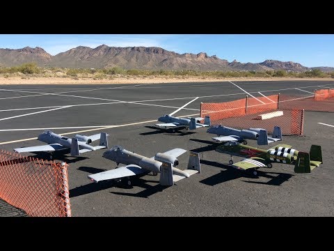

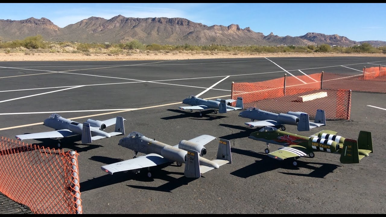

                    Five Freewing Twin 80mm A-10 Warthogs flown together at AEF 2018. Good times!
                    • And the video.

                            • Originally posted by xplaneguy View Post
                              And the video.
                              Beautiful flight, and beautiful day! And what is that strange type of clothing you're wearing that stops above your elbows and knees?? It looks vaguely familiar? :Ligthbulb:Rob
