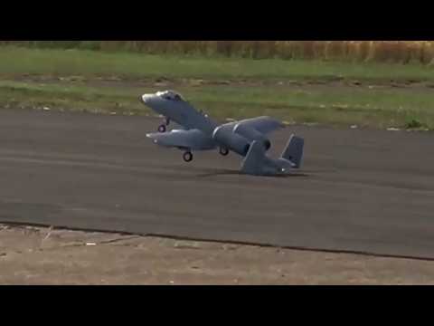

That is a generalisation. https://m.youtube.com/watch?v=yUR5mZAvlK0Originally posted by janmb View Post
100% correct.
With the obvious danger of generalizing, almost every single video I have seen of people bouncing this model has been fast, unpowered elevator based landings, rather than throttle controlled, sink landings where the throttle is used actively. In my not at all humble opinion, a fair share of pilots would benefit greatly from using their throttle more and their elevator less.
you can hear me use the throttle, you can see it land mains first. And it certainly wasn't fast.

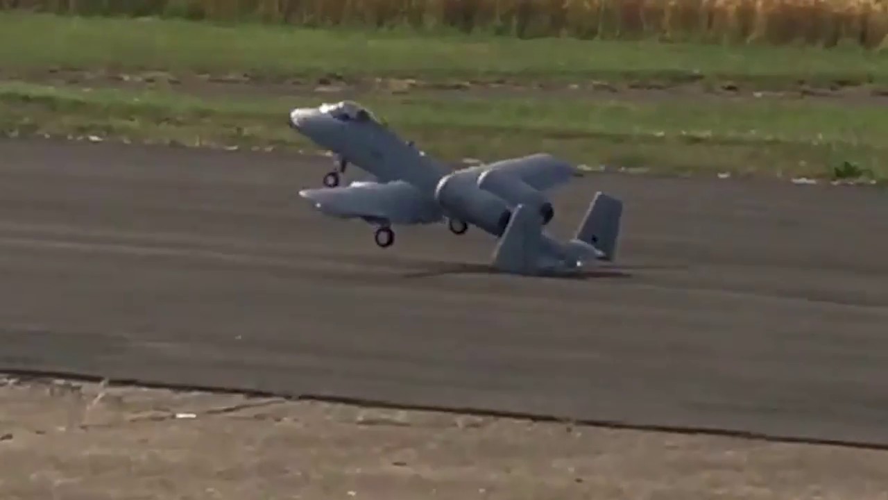

Here's one I slowed down of that same video.Originally posted by RCAV8R View PostWow Porkster, that is a great video of the problem! I must have missed that before. Thanks for capturing such a textbook case study on video! Rob

Hence why I wrote "most".Originally posted by Porkster View Post
Your video definitely is a good example of an exception. Not too hot by any means, nice and active throttle, and starts rodeoing from just a tiniest bit of heavy setting. Very close to a perfect landing, but punished hard.

Absolutely, I do agree that jets need to be flown into landing by using throttle for altitude and elevator for speed.
I have quite a short runway at just short of 300ft so it can be very unforgiving, I don't have the luxury of letting it land long and gentle for 600ft, I've seen some pretty bad videos of jets being forced down on massively long runways where either a go around or long landing would have worked.
The mains fully compressed when I landed and I still think the springs should be stiffer - and I should have throttled up and went around after the initial bounce!
Tired Iron, your version really makes me wince:Scared:

The slow-mo video shows one thing though: You do set her down quite hard/heavy. Which indeed suggests how soft the stock suspension is relative to the mass of the plane. From listening to the original version carefully, in hindsight you probably eased off throttle a little too much/little too early during late final/flare. But still, that's peanuts and hardly relevant here at all. The main thing to be taken from your video is how extremely little it takes for this model to rodeo like mad. As I said the first time as well, that landing was way too close to perfect to deserve that kind of reaction.

I'm looking forward to getting the upgraded main struts. I'm not sure what I did wrong on that landing but it did use the full compression on the mains which when they released started the bounce.Originally posted by DCORSAIR View Post
Wow, that was a good landing from what I can tell, and you didn't deserve those bounces, only thing I would say or see, it was maybe more of a plop down on the mains instead of a flare onto the mains, maybe??? I also changed my front stock tire to a main tire from the 90mm F-16, other than that mine is all stock. I'm only posting my video again to see if someone can spot the difference on why I have no bounce and yours did? I'm not saying by no means anything in anyway that yours is a bad landing and showing off my video for that reason, just trying to compare why you got a bad bounce. My A-10 is nose heavy too, my CG is not back where others are running, I'm around the 80mm but no more than 82mm. I also hold elevator even after the mains hit the runway so there is not much energy left. Please turn the sound down so you don't have to hear my voice, was a little nervous doing this video for the first time.
I've reversed the mains and haven't had this problem since and have approximately 20 flights on it.

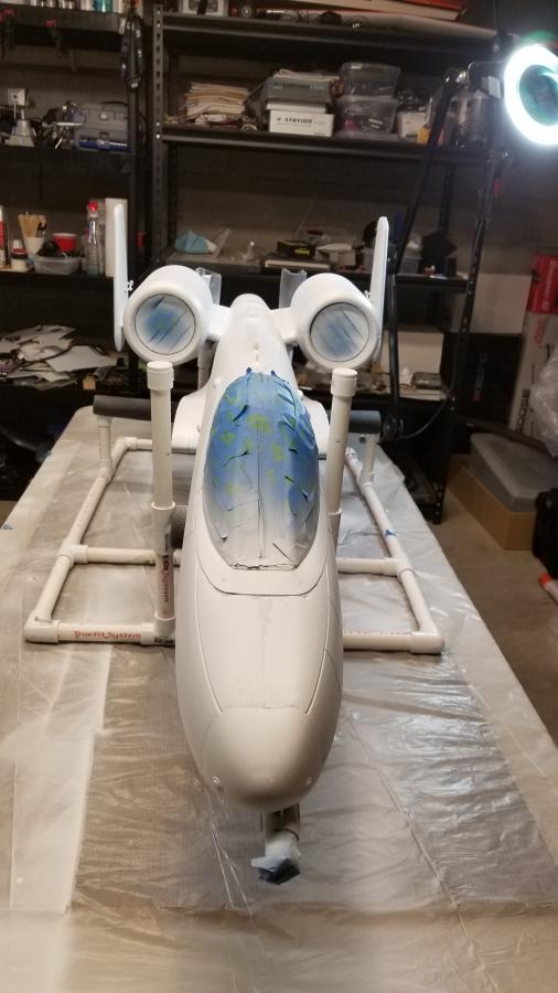

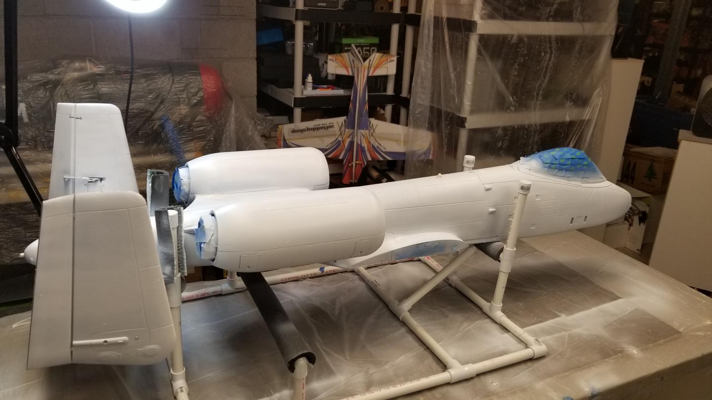

On another Note, almost done laying down my white paint on the a-10.. what a PITA getting that gray covered.
