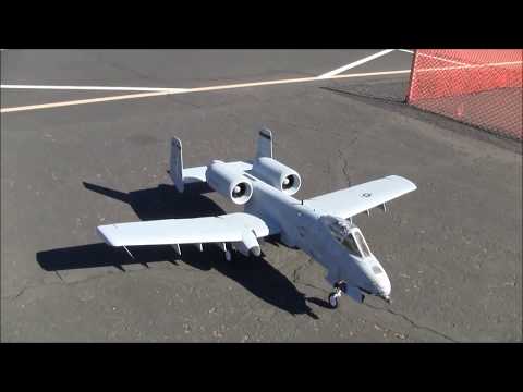

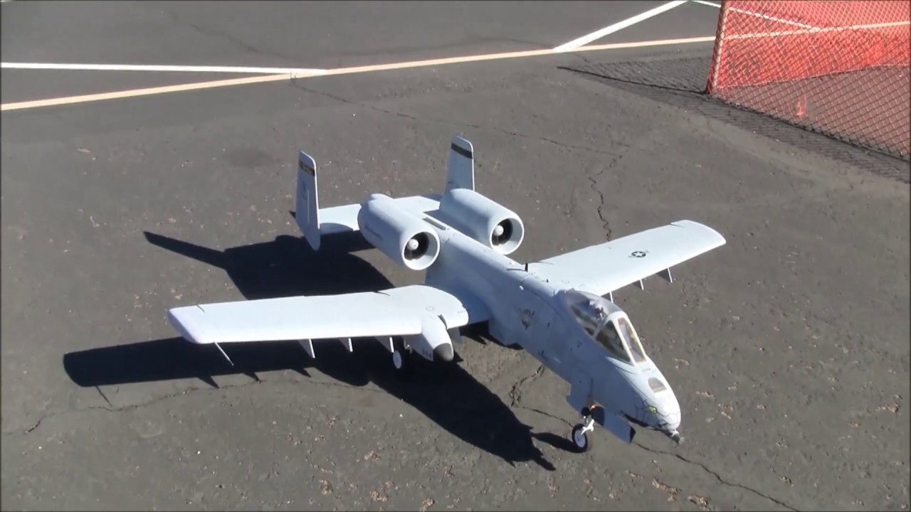

          Some video of formation flying with 4 A-10s at the recent Arizona Electric Festival. That's me in the blue shirt at the beginning. The amazing thing is xplaneguy is flying Alpha's original prototype. Glad to see that one still going strong!
            Awesome video.
            Really miss flying this bird - this reminds me to hate the winter even more lol

              #7526
              Thanks for posting this over here Pat!!!
              I have another video floating around with the FIVE SHIP flight....I have to find it among the 40+ videos I shot!
