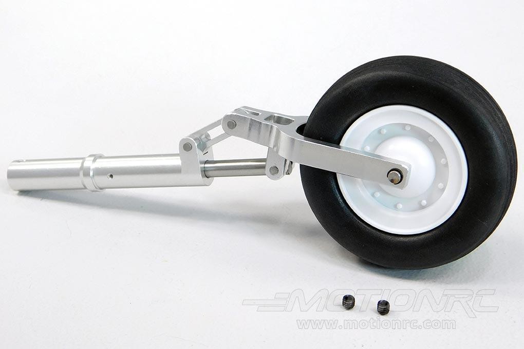

    Pat, I’ve looked my gear over again. On my nose gear, the link is in the rear already. What am I missing? Click image for larger version  Name:	9B433ABF-9193-4FB1-BAD1-CF3CA48BBE6A.jpeg Views:	1 Size:	77.6 KB ID:	123215
    I don't consider that to be a trailing link suspension. This is ............................ (see the difference?)
    Click image for larger version  Name:	freewing-80mm-edf-a-10-trailing-link-nose-landing-gear-strut-and-tire-b-landing-gear-motion-rc-1187521527833_1024x1024.jpg?v=1520981221.jpg Views:	1 Size:	71.9 KB ID:	123220

      • The factory nose gear is an oleo strut. The pic above is a trailing link....
        The “link” in the bottom pic goes to the nose of the bird, not the back like the oleo. So trailing link is a bit tricky, if not familiar with what is meant.... Hope that helps some! I reversed the mains via Tired Iron’s suggestion and it works wonders......

            The single factor that defines a trailing link is for the wheel axle to trail behind the strut. Just like on your super market trolley, this gives the wheel one important quality: It wants to run straight.
            There are numerous suspension benefits too, but tracking is the main purpose.
            There are various ways to implement trailing link gear. A leading knee joint is common, but far from the only route.
            • Seems to me that if you upgrade all three gears, your getting rid of the problem with the mains and adding a problem with the nose gear. IMHO just replace the mains and keep the nose gear. The fact that the T.I. reversal has been such a game changer for so many, including myself, proves my point. If it ain't broke. don't fix it.. It's just that simple.
              Brad
              • For me, I have had such great experience with my Stinger 90, I feel good replicating that! It has oleo mains and TL nose gear. I fly off pavement and I look at it as an ounce of prevention... Rob
