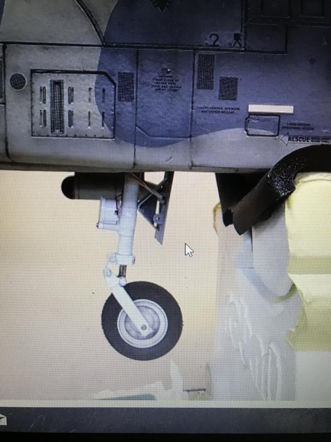

I just received the upgrade trailing link nosegear yesterday, and this morning read that it actually doesn't fit - the wheel hits the gear door at full compression. That is a pretty amazing error - I mean, we have all experienced making a nice part and then putting it in and discovering that we forgot something, and it doesn't fit after all. That is common. But going into production and selling a bunch of them....that's a pretty big oops. Not quite in the same league with the Hubble telescope mirror, but not good. Anyway, maybe it is already posted here, but a guy on RCgroups has the most elegant solution I have seen. Verrry simple and quick:

I’m the guy who posted here and on rcgroups hoping to gain some tribal knowledge. Find it strange that more pilots haven’t had the same experience I have. Well, I have found two others but no real cure posted yet. One guy ripped his gear door off and I found his repair found on YouTube. Notching out the gear door is not what I wanted to do, so I came up with the plastic bushing. Too early to say if this mechanical stop is the “cure” yet since I have not been able to flight test due to rain. I feel sure tire won’t make contact with rear door now, but not sure limiting the stroke won’t bring bounced landings back.
I won’t be able to test until next weekend now.
JohnFreewing A10, F4, F22, Sebart Avanti S mini
What I did find in my research is that there was a TL strut used early on in the initial production stages, and I just noticed the amount of stroke on that piece appears to be 1/2 of that on the latest TL strut. Having issue with posting pics right now. Will try later.
edit: attached pic is of early TL gear
If you look on MotionRC and compare "spare parts" with "upgrade parts", you can see that the original set has trailing link mains (but a weird style of trailing link with tension spring instead of compression spring), and straight oleo on the nosegear. The upgrade gear has a trailing link nose gear (of standard compression-spring/oleo type), and straight mains (also of standard spring type). It is supposed to reduce bounce. The upgrade nosegear, however, doesn't actually fit - in the compressed position it would hit the gear door. Oops. So then there is discussion about modification, either by limiting the travel or by moving/notching the gear door.Originally posted by petefoss View PostI'm out of the loop, are they redoing the nose gear retract?

1. It is ingeniously simple, thanks for posting it.
2. I assume that limiting travel can only have a negative effect in increasing shock (by decreasing shock absorption). It would not increase bounce.
3. The only concern I had is that under shock it might pop off. I know some people pressed on the nose and said it was solid, but I don't think a slow press on the nose is the same as a hard landing. I might wrap something around it after it is on, just the make it less likely to come off the same way it went on.
I have only had two landings on this plane, and both went perfectly, no hint of a bounce. But of course everything in flying seems easy until it doesn't go well.
Motion has "upgrades" for mains and nosegear. Was there ever any consensus that the bounce was mainly due to one or the other? I have read mixed advice on this. Before these upgrade gear came out, some people focused on clipping springs from the mains, or switching the mains. So I wonder if anyone just tried the upgrade mains without putting in the upgrade nosegear. That would also solve the nosegear fitting problem - just don't install it.
