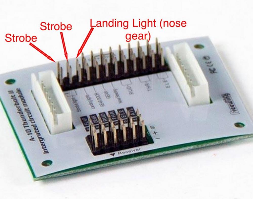

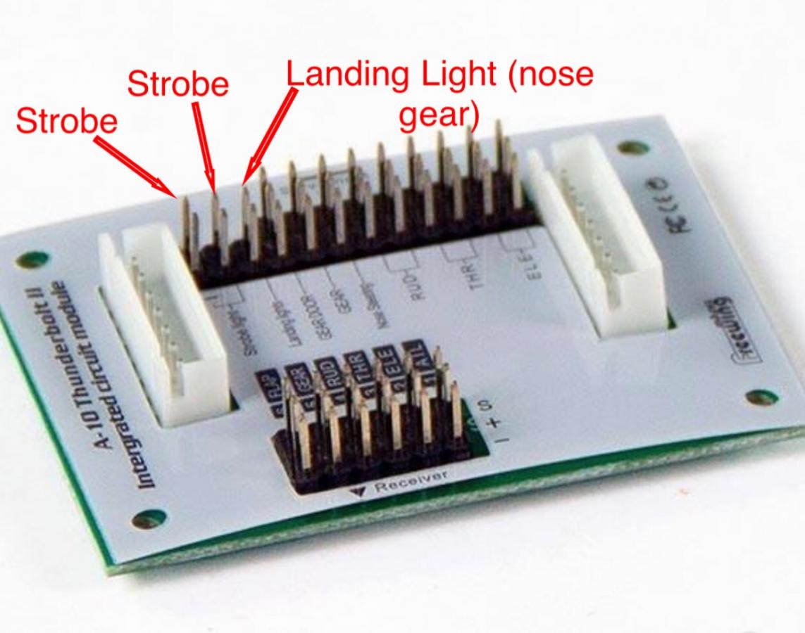

  • Hey Guys...I'm just starting to assemble and already I'm stumped...there are two strobe leads, one from the tail and one from the top...but I only see one plug on the board. Is there supposed to be a "Y" connector or am I missing something (wouldn't be the first time)? Thanks! for the help! Rob
    • Originally posted by RCAV8R View Post
      Hi Rob,
      The main control board has three servo lead slots for the lights. The top two slots are for the strobes, one for the top middle fuselage strobe and the other for the tail strobe. The third slot down just below those two slots is the nose gear landing light. The LED slots on the board are the ones that have two prongs instead of three. All the rest of the lights (NAV on the wings) are already wired appropriately to activate on the wing via one piece wing harness.

        • Originally posted by T-CAT View Post
          Hi Rob,
          Thanks T-Cat! My pins at the top of the board were bent back so it looked some kind of pace holder or something. When you confirmed what it was supposed to be I looked closer, went in with needle nose and bend the pins up. Hopefully everything will fire up okay! Much Appreciated!!Rob
          • Not a problem at all! Those pins bend incredibly easily, and I would have loved to see each slot be spaced a bit further apart, but it is what it is. Ha-ha. Thankfully those pins are pretty resilient. If a pin is bent slightly on one of the LED slots, I wouldn't mind that at all and chances are it'll work. However, if it was a pin(s) that was bent on one of the slots for one of the main control surfaces, I would forgo using it and just use a Y-harness directly to the receiver slot (such as both rudders, or both elevator servos Y'd, etc.). A person could also forgo the board, as well as Y-harness for some surfaces and use a separate channel for each servo and mix as necessary in the radio, but that would start to take up quite a bit of channels. Ha-ha
            • Good to know..and you're right...in retrospect, it could have been much more critical! Onward... Rob

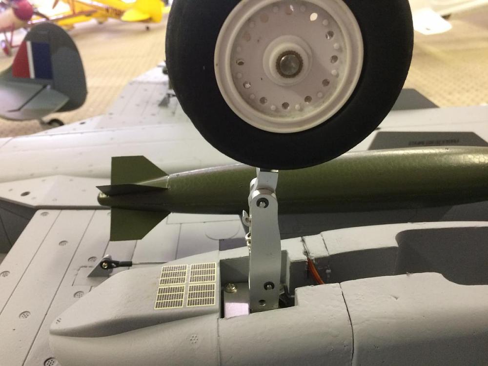

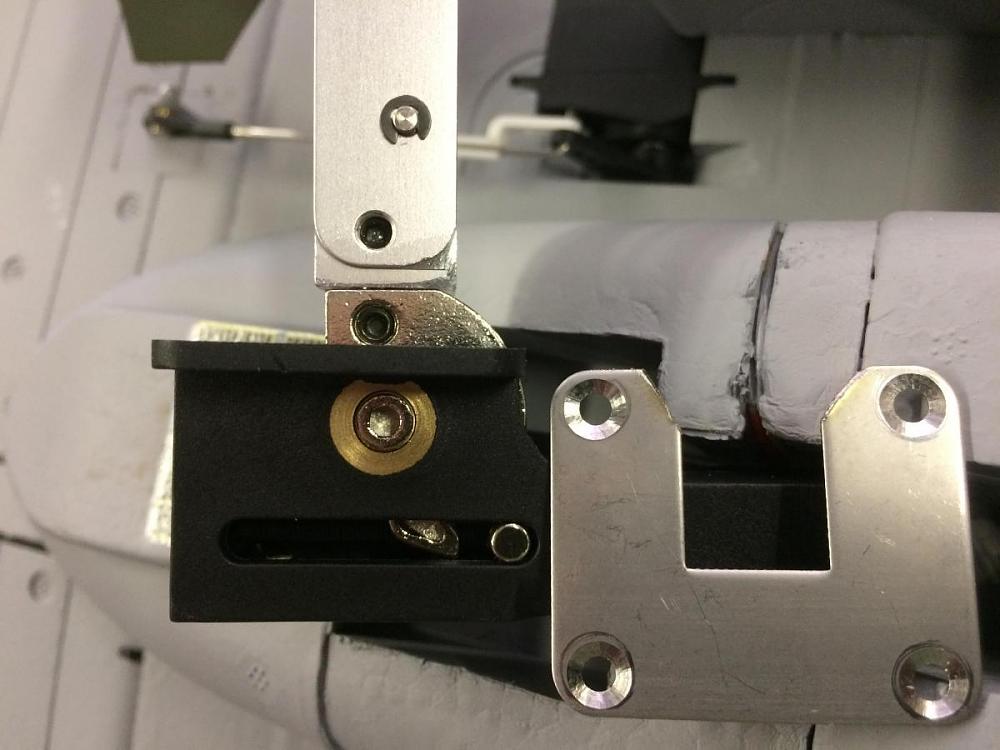

                                  • I see many getting discouraged about this plane over the bouncing and nose wheel issues caused by it but if you do these simple fixes you can fly her on grass, pavement or textile without bouncing and you will have a solid, straight nose wheel.
                                    I know I have some naysayers but I have over 30 bounce free flights with this setup and several others are having success with this setup as well.
                                    1: Reverse the freaking struts, to do this you need to take the plastic covers off of the main gear retracts (throw them in the trash so you can tighten the struts when they get loose), then remove the strut from the retract and move it to the other side with the wheel facing the wingtip. You may need to clearance the strut and plate like the pictures below, some haven't had to do it but some have.
                                    2: Make a new retract plate using the old one as a template but make the slot where the trunion rotates less shallow (see picture below) so it will stop the trunion travel and keep the strut from bending back. Put the original plate back on top of the new one for extra support.
                                    3: Cut about 3/8" off the nose wheel strut spring (sorry no picture).
                                    4: To give the retract a little more strength you can drill a hole through the battery tray and run a zip tie around the long end of the retract (again, see picture below).
                                    *Bonus* If you have already broken the nose gear strut pin and are having trouble getting a new one the Freewing 1600mm Spitfire axles work great if you cut down the flange a little and cut a second flat on them.
                                    This will be the last I post about this fix, use it or not but if you want a really great taking off, flying and landing A-10 this will do it.

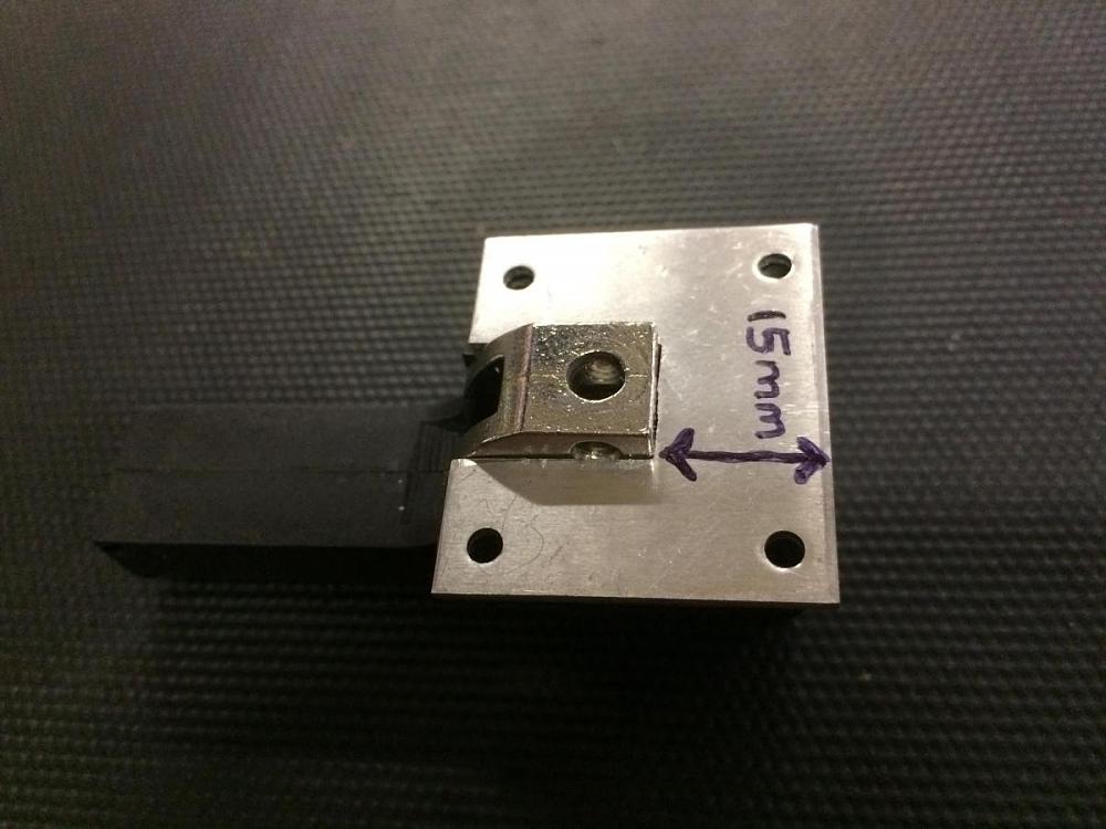

                                      • 2: Make a new retract plate using the old one as a template but make the slot where the trunion rotates less shallow (see picture below) so it will stop the trunion travel and keep the strut from bending back. Put the original plate back on top of the new one for extra support.
                                        Click image for larger version Name:	Plate.jpg Views:	1 Size:	95.9 KB ID:	96492
                                        Is this new plate for the nose gear retract? The original is only 12-13mm, so I am assuming this is for the nose!! Thanks in advance!!!
                                        • Originally posted by Hardway View Post
                                          Yes, this is for the nose.
