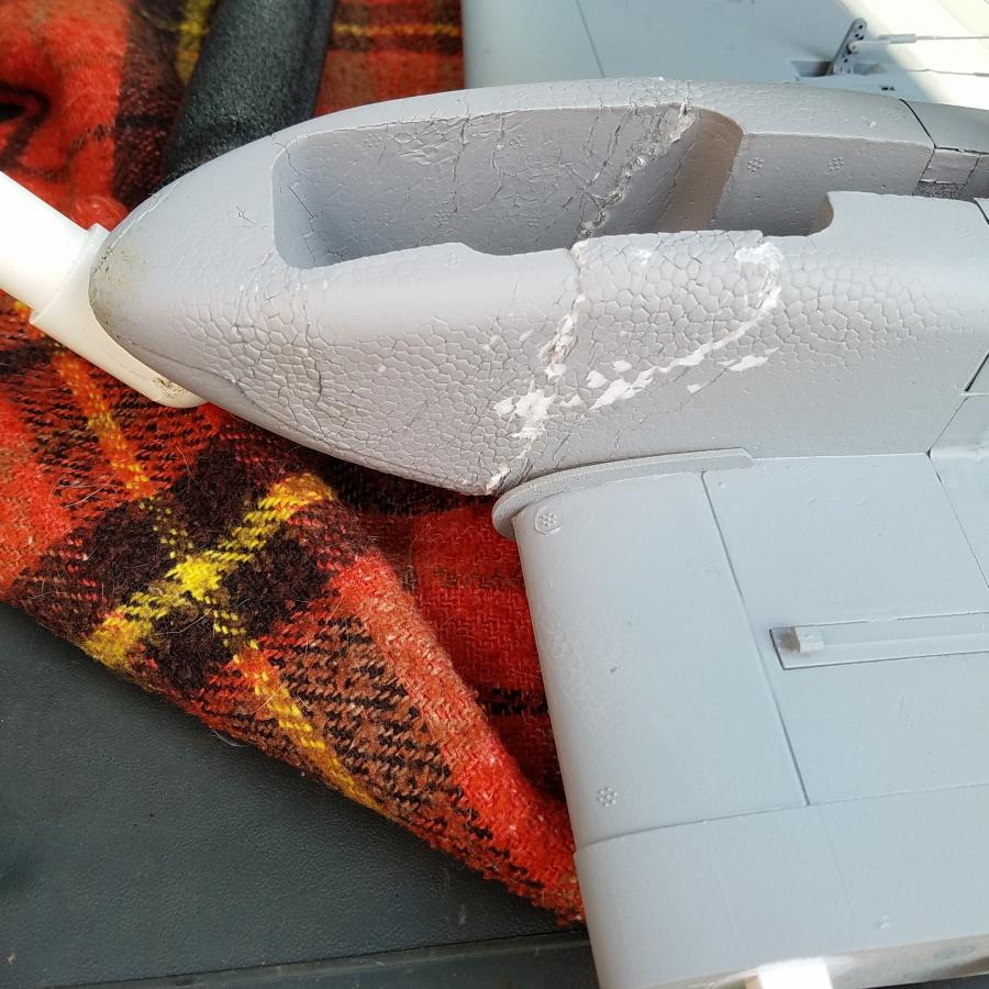

      Well mine bit the dust today, it flew apart like a mini Erma! Takeoff roll and just broke ground before the edge of runway then the uncut edge grass grabbed it and spun it in.
      So how does EPO foam react to steam when trying to repair the compressed areas for repair?
      The fuse broke right in front of the wing, ripped the front of both gear sponsons off, and pulled all the connections off the mixer board.
      I never had to do any heavy depot level repairs/rebuilds on EPO till know. All advice and thoughts on how to proceed welcomed!

          Use Foam-Tac...start with the smaller pieces and just stretch the pieces out by pulling on them over and over working them back into shape as you do.

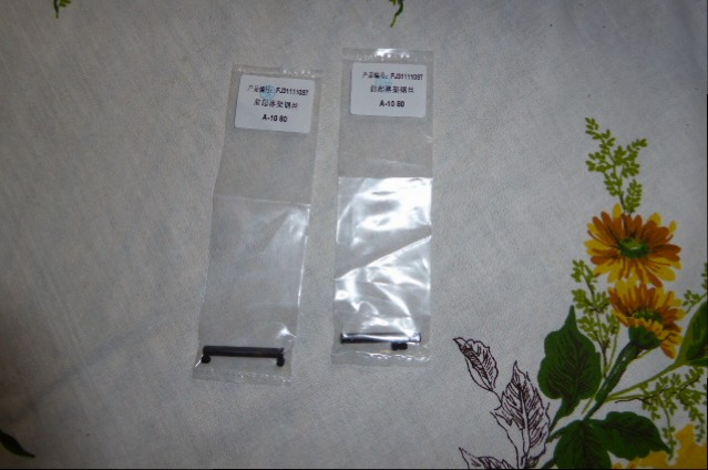

              REPLACEMENT NOSE GEAR PINS:
              I just received two replacement nose gear pins from RC-Castle that I ordered. Before they got here I found a solution (see my post 6433), so I don't need them. I paid $12. for the two of them (with shipping). If anyone wants one for $6, send me a private message with your address and I will drop one in the mail for you. You can pay me to my Paypal account. Click image for larger version

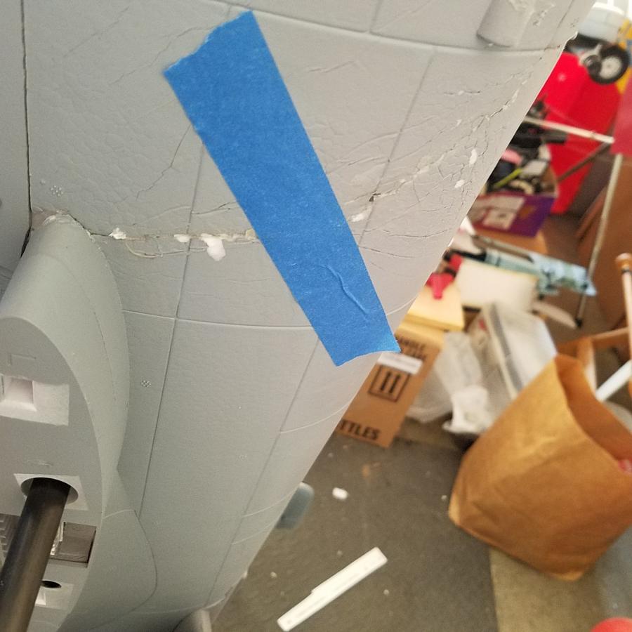

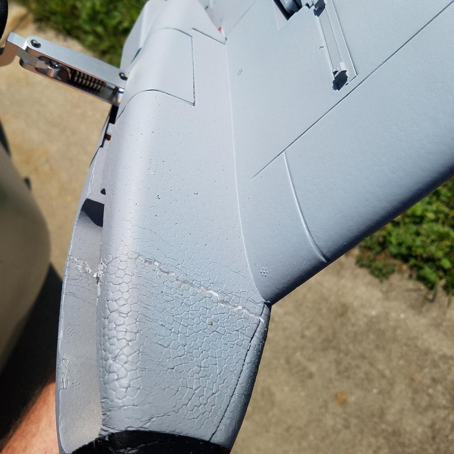

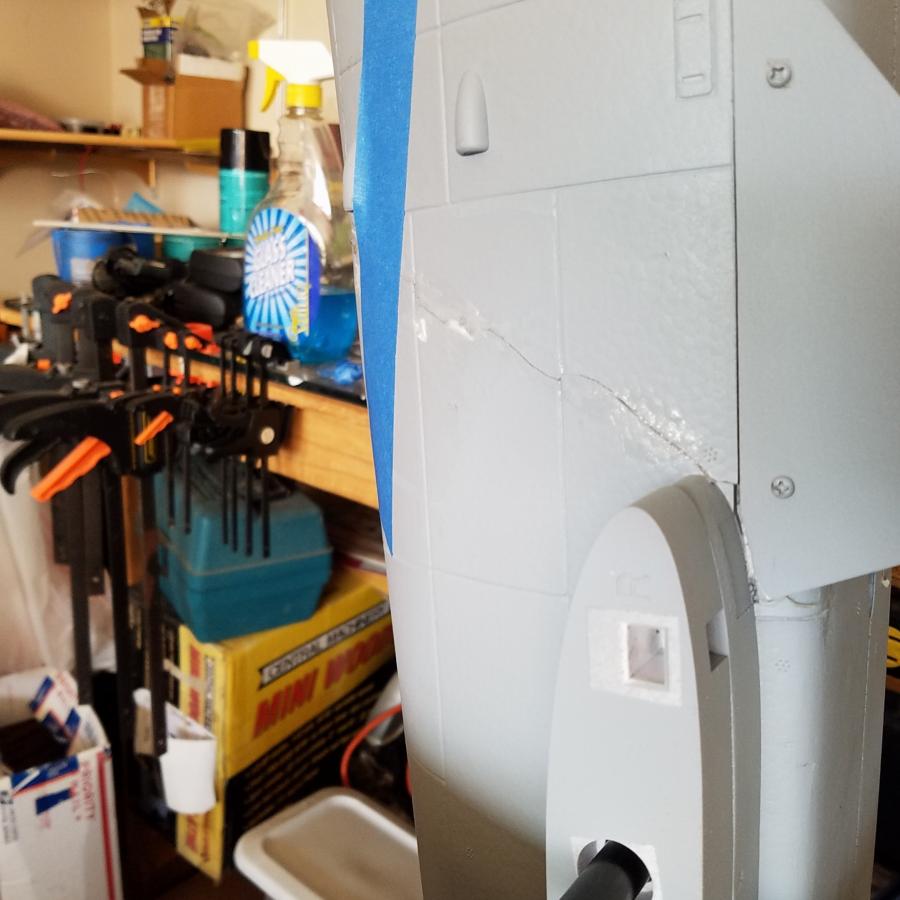

                                        Well, I must say that the flying event this weekend i started out on Friday didnt fair well at all.......................................
                                        Click image for larger version  Name:	20170915_171335.jpg Views:	1 Size:	234.8 KB ID:	97246 Major ouch!!!!! Just as i broke ground i was too near the edge of the runway and the tall grass grabbed the right gear and in a blink of an eye, it spun around and then slammed into the ground. Parts flew everywhere. So first thought is, not repairable!!!! Order a new fuse, front, rear.............not in stock at MRC, RC Castle has them but shipping showed high, nearly $100. Well went out the next day after looking at youtube videos and getting feedback from two members here back a couple post, i proceeded to fit it back and most damage was clean breaks. I was very surprised to see how well it did fit and then i started with Foam 2 Foam glue from Delux Materials. I have not used Foam Tac ...yet! but this stuff is great. I never have done a major foam repair on EPO put this stuff worked very well. Some pins, tape and careful fitting, it went back together.
                                        I found another net trick on removing/expanding back the foam after it gets crushed. Boiling water, yea but i cant boil water in big enough container to hold this thing. Several videos showed a guy using a covering iron but his foam planes were covered in a film that is available from A Loft Hobbies but i didnt have that stuff and wasnt going to cover the planes in it.
                                        So, take the iron and set it to about 2-2.5 on the setting scale of the iron, dampen a paper towel and place it over the area that your trying to expand. Let it sit for a few seconds, keep checking and watch it closely for the foam to get the alligator effect and the part starts to form back to original shape almost.
                                        Its not pretty but it gets the form back to close enough to glue it back together.
                                        Click image for larger version  Name:	20170916_141622.jpg Views:	2 Size:	87.0 KB ID:	97252Click image for larger version  Name:	20170916_141539.jpg Views:	2 Size:	71.8 KB ID:	97253Click image for larger version  Name:	20170916_141552.jpg Views:	2 Size:	76.8 KB ID:	97254Click image for larger version  Name:	20170916_141636.jpg Views:	2 Size:	115.5 KB ID:	97255
                                        To better support the fuse at such critical junction, I installed 5mm carbon tubes in the channels on each side using 30min epoxy and micro balloons as a slurry and it held up to six flights today and one bronco landing/go-around. The Foam 2 Foam i assume is just like Foam Tac as it dries clear, semi flexible but given 24 hrs to dry, it firms up.
                                        The other tip i have is a filler called Foam Putty, found in the model train scenery section of your LHS or even a Hobby Lobby if you have one near you. That will be used to fill and clean up the surface this fall after my flying season comes to a end.

                                        My suggestions
                                        Have a tube of Delux Materials Foam 2 Foam on hand or Foam Tac
                                        Break out your old monokote iron and remove those unsightly wrinkles
                                        If you are flying with heavy batteries, ie RT 6250ma or similar, By all means, install some 5mm or 6mm tubing in the channels of the forward fuse. Tip: RadicalRC has carbon square tubing with the round inside just like the main aft reinforcement rod is and will fit like a glove in those slots.
                                        My Depot level maint crew came through and chief pilot confirmed that all worked as it should.
