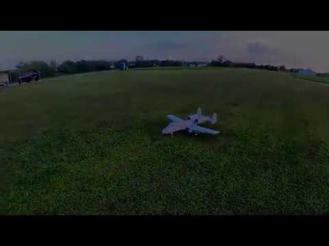

            • Almost forgot to post this. Tried out my A-10 at the Sarasota Silent Fliers field this morning. Their runway is about 1/2 the width and 200 feet shorter than the one at the SRQ Squadron but at least it's not closed due to Sarasota county using Rothenbach Park as a staging area for hurricane Irma storm debris.
              As a bonus, it's an all electric club so there's no gasser and nitro noise to deal with.
              • Sweet flite !
                Nice field also.
                Shows the nose gear perfectly....even rode a weelie for a bit on gate approach....LOL
                Oreo and nutter at the same time makes ?
                Reesetractable snackin gear.
                • Thanks Pete. I've found since switching from trailing link mains to leading link mains it's much easier to ride a wheelie with the A-10.
