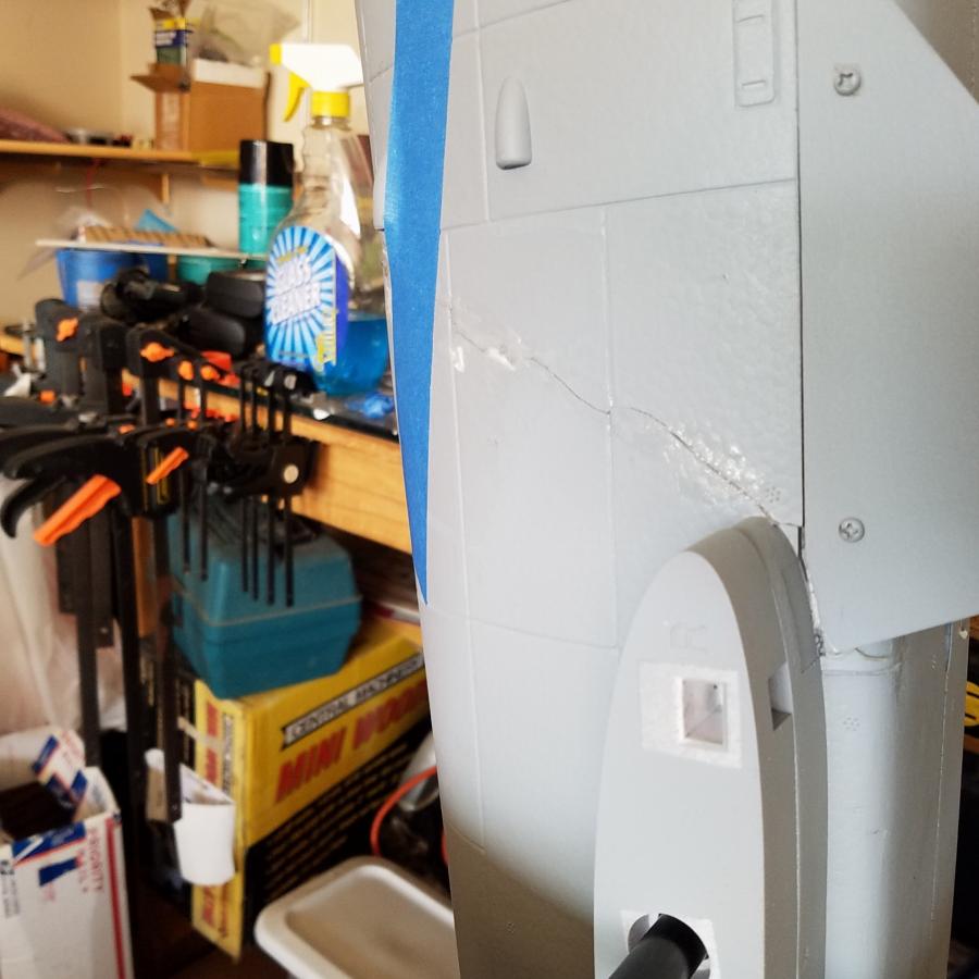

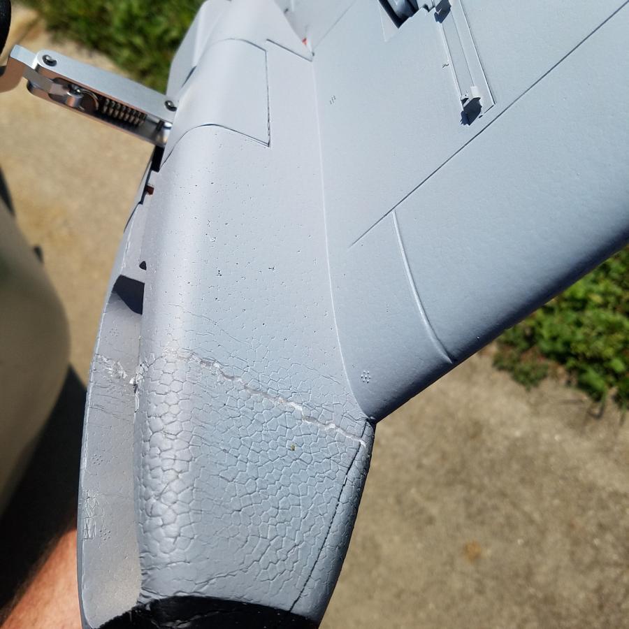

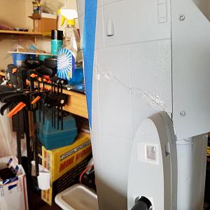

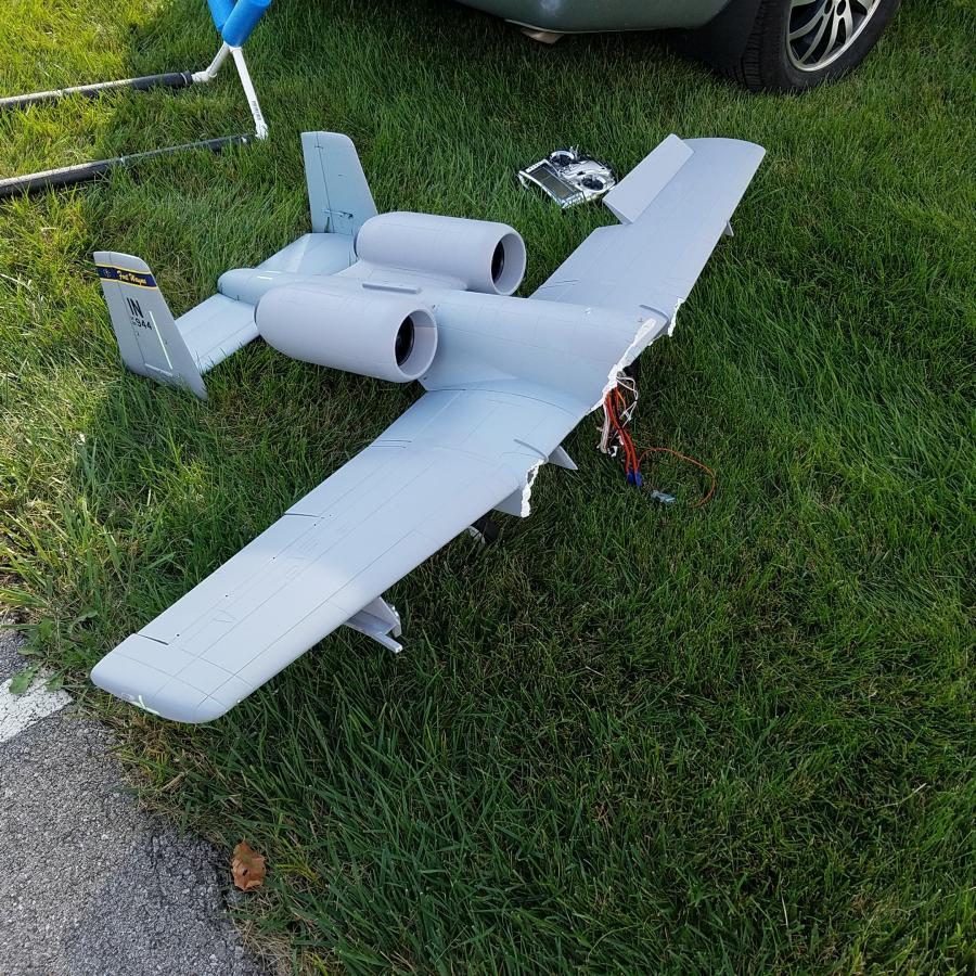

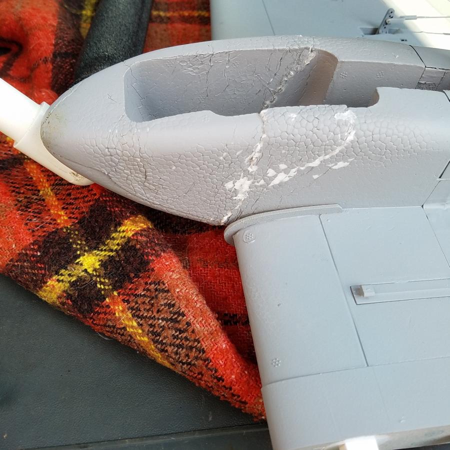

        Click image for larger version Name:	20170915_171335.jpg Views:	1 Size:	234.8 KB ID:	97246 Major ouch!!!!! Just as i broke ground i was too near the edge of the runway and the tall grass grabbed the right gear and in a blink of an eye, it spun around and then slammed into the ground. Parts flew everywhere. So first thought is, not repairable!!!! Order a new fuse, front, rear.............not in stock at MRC, RC Castle has them but shipping showed high, nearly $100. Well went out the next day after looking at youtube videos and getting feedback from two members here back a couple post, i proceeded to fit it back and most damage was clean breaks. I was very surprised to see how well it did fit and then i started with Foam 2 Foam glue from Delux Materials. I have not used Foam Tac ...yet! but this stuff is great. I never have done a major foam repair on EPO put this stuff worked very well. Some pins, tape and careful fitting, it went back together.

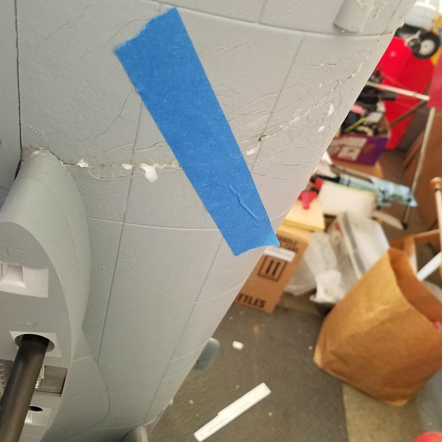

        I found another net trick on removing/expanding back the foam after it gets crushed. Boiling water, yea but i cant boil water in big enough container to hold this thing. Several videos showed a guy using a covering iron but his foam planes were covered in a film that is available from A Loft Hobbies but i didnt have that stuff and wasnt going to cover the planes in it.
        So, take the iron and set it to about 2-2.5 on the setting scale of the iron, dampen a paper towel and place it over the area that your trying to expand. Let it sit for a few seconds, keep checking and watch it closely for the foam to get the alligator effect and the part starts to form back to original shape almost.
        Its not pretty but it gets the form back to close enough to glue it back together.
        Click image for larger version Name:	20170916_141622.jpg Views:	2 Size:	87.0 KB ID:	97252Click image for larger version Name:	20170916_141539.jpg Views:	2 Size:	71.8 KB ID:	97253Click image for larger version Name:	20170916_141552.jpg Views:	2 Size:	76.8 KB ID:	97254Click image for larger version Name:	20170916_141636.jpg Views:	2 Size:	115.5 KB ID:	97255
        To better support the fuse at such critical junction, I installed 5mm carbon tubes in the channels on each side using 30min epoxy and micro balloons as a slurry and it held up to six flights today and one bronco landing/go-around. The Foam 2 Foam i assume is just like Foam Tac as it dries clear, semi flexible but given 24 hrs to dry, it firms up.
        The other tip i have is a filler called Foam Putty, found in the model train scenery section of your LHS or even a Hobby Lobby if you have one near you. That will be used to fill and clean up the surface this fall after my flying season comes to a end.
        A big shout out to my friend who came up from Alabama so we could fly at the Fall Jet Classic this weekend and practice our formation training sorties. Sean, aka, EDFJetPilot here on the forums, thanks for staying around today and encouraging me to fix it. Our flights together worked out great and i look forward to more sorties and formation training.
        Seems we flew more today than all weekend since the turbines thinned out greatly.
        My suggestions
        Have a tube of Delux Materials Foam 2 Foam on hand or Foam Tac
        Break out your old monokote iron and remove those unsightly wrinkles
        If you are flying with heavy batteries, ie RT 6250ma or similar, By all means, install some 5mm or 6mm tubing in the channels of the forward fuse. Tip: RadicalRC has carbon square tubing with the round inside just like the main aft reinforcement rod is and will fit like a glove in those slots.
        My Depot level maint crew came through and chief pilot confirmed that all worked as it should.
        Sam

        I'm amazed by the superior skill of your depot level maintenance team...never have I seen such a major mishap come back together as well and as quickly as what you did.
        Thanks for taking the time to lay out in detail what you did for your repairs. I know I learned a couple things.

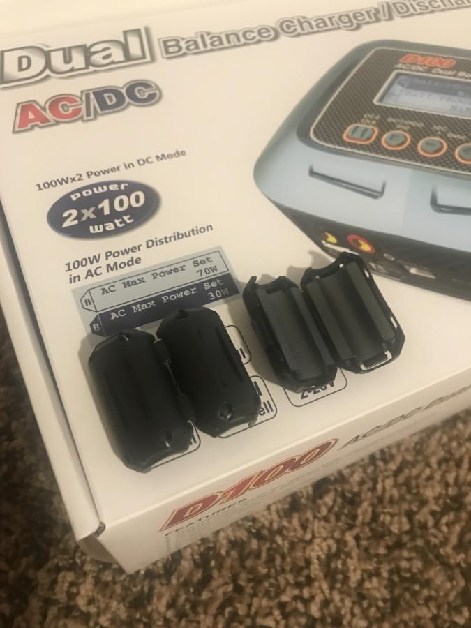

                                          #6500
                                          These came with my charger. What are they ?
