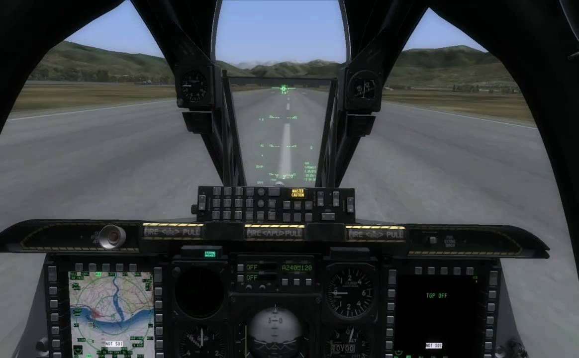

        I have not flown this particular A-10 yet but I have flown the A-10C in a flight simulator setting in DCS. Even in the simulator I have also experienced bouncing in some landings. Which goes to show just how realistic the simulator is.
        I have found the A-10 to be a bit of a challenge to land when I go too long with out flying it but when I start up again practicing with it on a regular basis I am able to nail the landings every time there after.
        But I can see how practicing with an RC A-10 can become some costly training. Which is why I keep telling people that its to their advantage to also train flying in a simulator where they can become more familiar with a particular airplanes flight dynamics and mistakes don't cost you anything. I recently started flying the AJS-37 Viggen in DCS and nailed the landing on my first try! which goes to show how much easier the Viggen is to fly.
        I recommend you checking out DCS which is free to download and it includes the Su-25T and TF-51D. But right now all add on modules are on sale till July 24. https://www.digitalcombatsimulator.c..._a10c_warthog/
        DCS A-10C Landing Fundamentals
                                          What joystick are you using?
