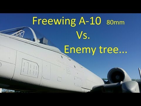

                                • If anyone doubted how tough this A-10 was, have a look at this.
                                  My A-10 was brutally attacked by an enemy tree during a very low altitude sortie.....
                                  • Originally posted by Itgordon00 View Post
                                    Wow! Now that’s amazing. Great job on the rebuild too!
                                    • Amazing! Nice job getting her back safely and repaired. Well done!
