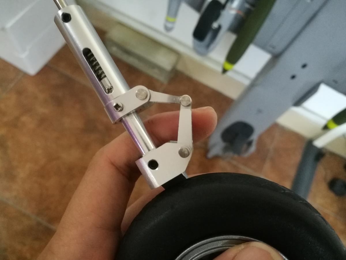

Name:
ID:	101882Click image for larger version
Name:
ID:	101883 A couple of shots taken of a friends A-10.
                                Mike

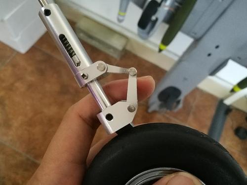

                                      #6898
                                      Update for our friends out there wanting to order OEM drop in Oleo main struts and/or a TL nose strut: We finally got the supplier to finalize the run. We'll be listing these online in the A-10's Upgrades page after the struts ship in a 2-3 weeks. More info will be published once they're en route, but for now the mains will be sold in a pair sans wheels and the nose strut will be sold by itself with a wheel installed (due, to the C-clip design). Unless there was significant outcry for main wheels to be included in the main strut pair set as well...
                                      I believe TiredIron already posted the render of the TL nose. Here's a photo of the Oleo main.
                                      Click image for larger version  Name:	IMG_20171028_160629.jpg Views:	1 Size:	74.6 KB ID:	102032
