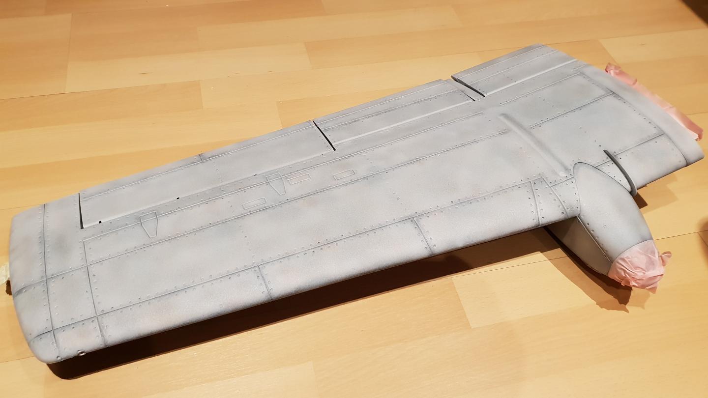

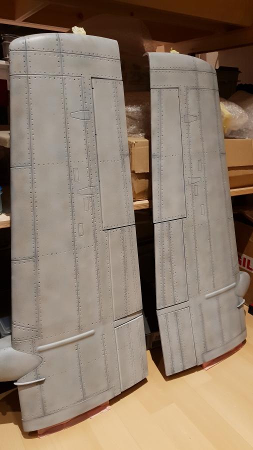

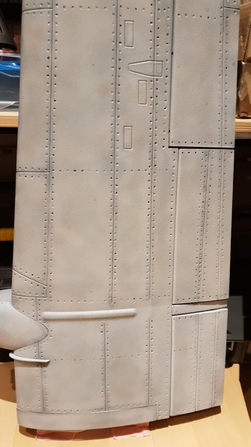

        Unfortunately the photos do not show how cool it looks.
        Click image for larger version  Name:	20181028_163221.jpg Views:	1 Size:	83.8 KB ID:	158581
        Click image for larger version  Name:	20181028_163206.jpg Views:	1 Size:	51.2 KB ID:	158582Click image for larger version  Name:	20181028_163158.jpg Views:	1 Size:	52.1 KB ID:	158583
        for preshading I used Vallejo 71029 and 71109 and then I covered with 71276 USAF light grey

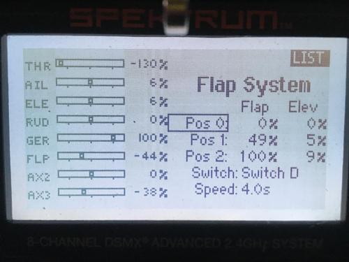

                        Need help folks. My A-10 is coming closer. Painting is done. I have a couple questions...
                        1) The pushrod for the inner flap is WAY too short. Instructions want me to use a 63mm pushrod. Even with the flaps all the way down the 63 wont reach the 'neutral' servo horn. I measured and think I need a 92mm pushrod. (I know I could remove the control horn on the servo and adjust it but I would have to dig into the wing to get to the set screw). Did anyone else have this issue? What did you do?
                        2) Hooked up electronic and radio for the first time. Everything is fine except...the throttle is not the same for both engines. At about 1/10th throttle one engine is going but the other doesnt until a higher throttle setting. How do I sync them?
                        All help appreciated!!
                        Stilgar

                        What kind of radio are you using? With Spektrum (flap system setup) I put the flap switch in the mid position. That should have the servo horn at the 90 degree point. From there I move to the flap up position and adjust the travel % to move the control horns to the rear of the wing just short of digging into the foam.At this point I add my linkages with the flaps in the up position. (I had no problems with them being too short on mine.) from there I go back to the mid position and adjust for the correct value. Once done there go to the full down and adjust the percentage for the correct throw there.
                        • Stilgar99
                          Stilgar99 commented
                          Editing a comment
                          I have a specktrum. I went to the flap system and set the travel % as far as it would go (-100%). It was still too short. The flap would have been about 5ish mm down...
                        #8893
                        You can go into the sub trim settings and adjust the servo centering for the flaps (aux 1) and maybe stretch out your -100 throw on the flap menu...

                          GAH!...I solved it....OPERATOR ERROR....(I was confused by instructions and used the wrong SIZE pushrod)... Got it all working now. Thanks folks!

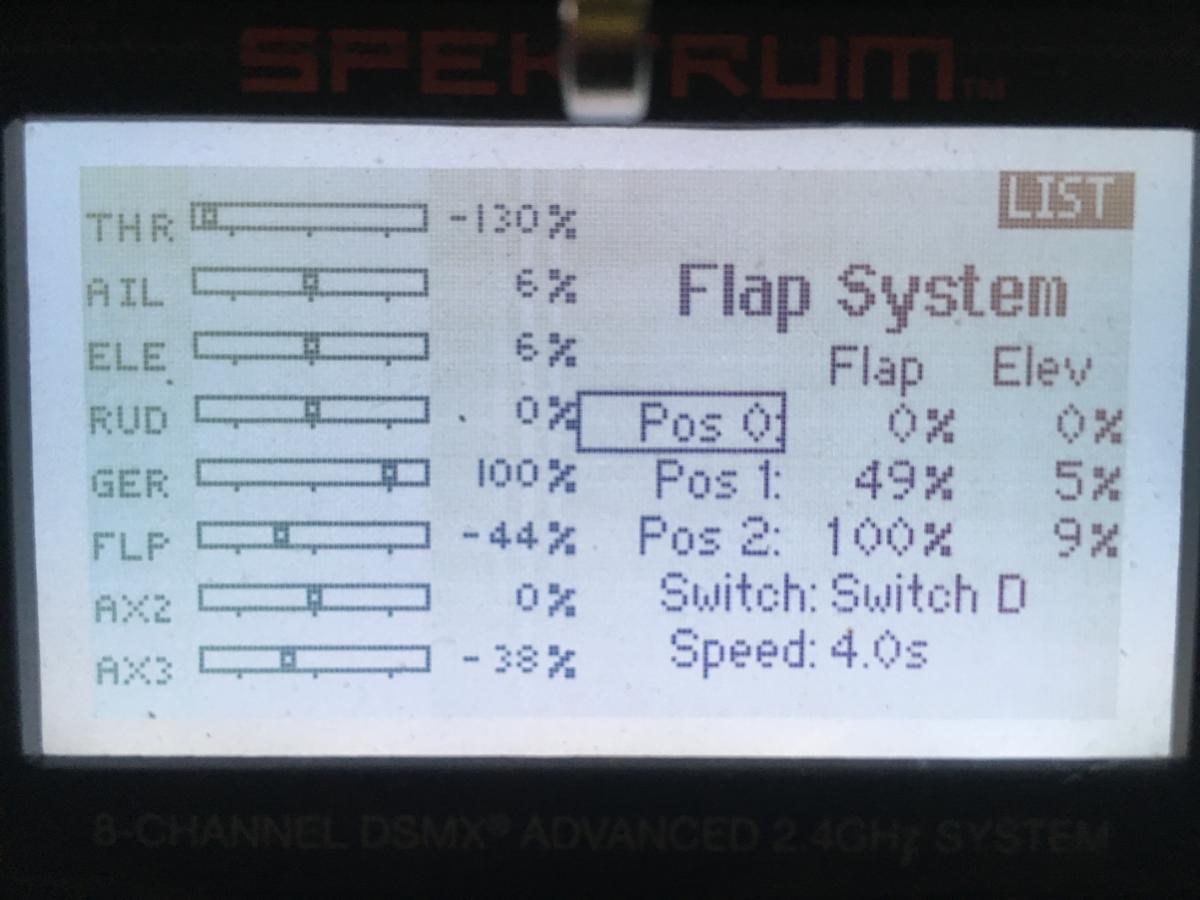

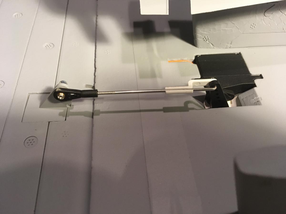

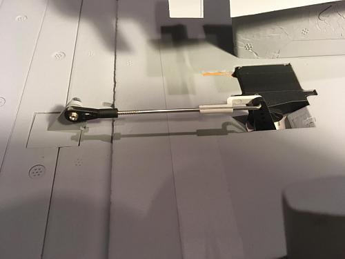

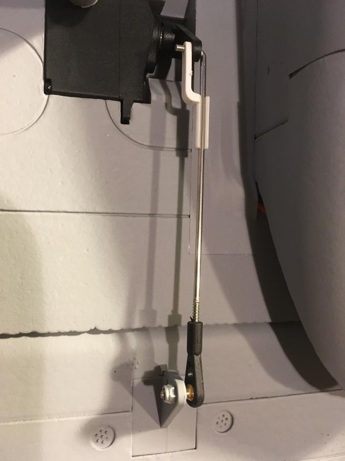

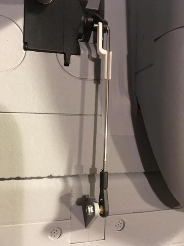

                            First, are you measuring the rods correctly? The length is NOT the total length that includes the ball socket. It's only the metal part to the end of the threads. In the picture below, you can see the inner flap. It's the shorter one.
                            The outer one is the longer one.
                            As you can see, they fit just right.

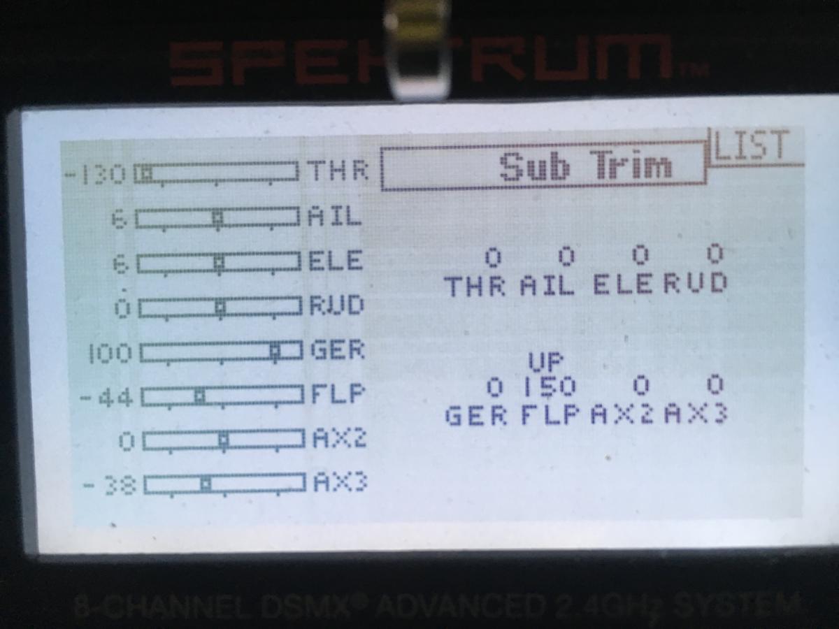

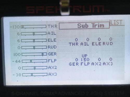

                            Next, did you "zero" your servo? NOT neutralize them, but zero the flap servos. In this next photo, you can see that you need to fiddle with the subtrim (and sometimes with the flap menu settings, too) to get the servo to the end of their travel.
                            As it turns out for this plane, the flap menu settings were pretty straight forward and needed no weird settings. Some of my other planes required the settings to NOT coincide with "0% for neutral, 50% for take off, 100% for landing". Sometimes, to get the flaps to level, on my other planes, I needed something strange like -35%. You do whatever it takes to zero the flap servos. You may also have to play with reversing.
