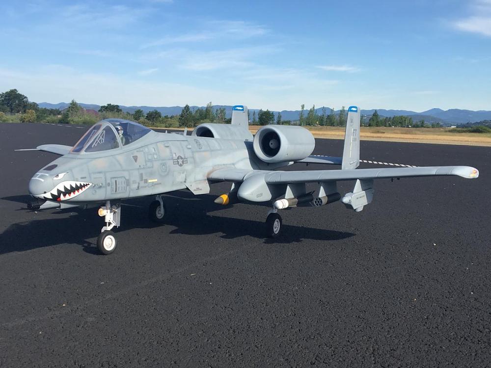

      Spammer, that is a very nice Canadian paint job , I like it !
ID:	136666Click image for larger version
      Originally posted by Spammer
      It got warm enough to paint outside in the Great White North, so finally finished.....

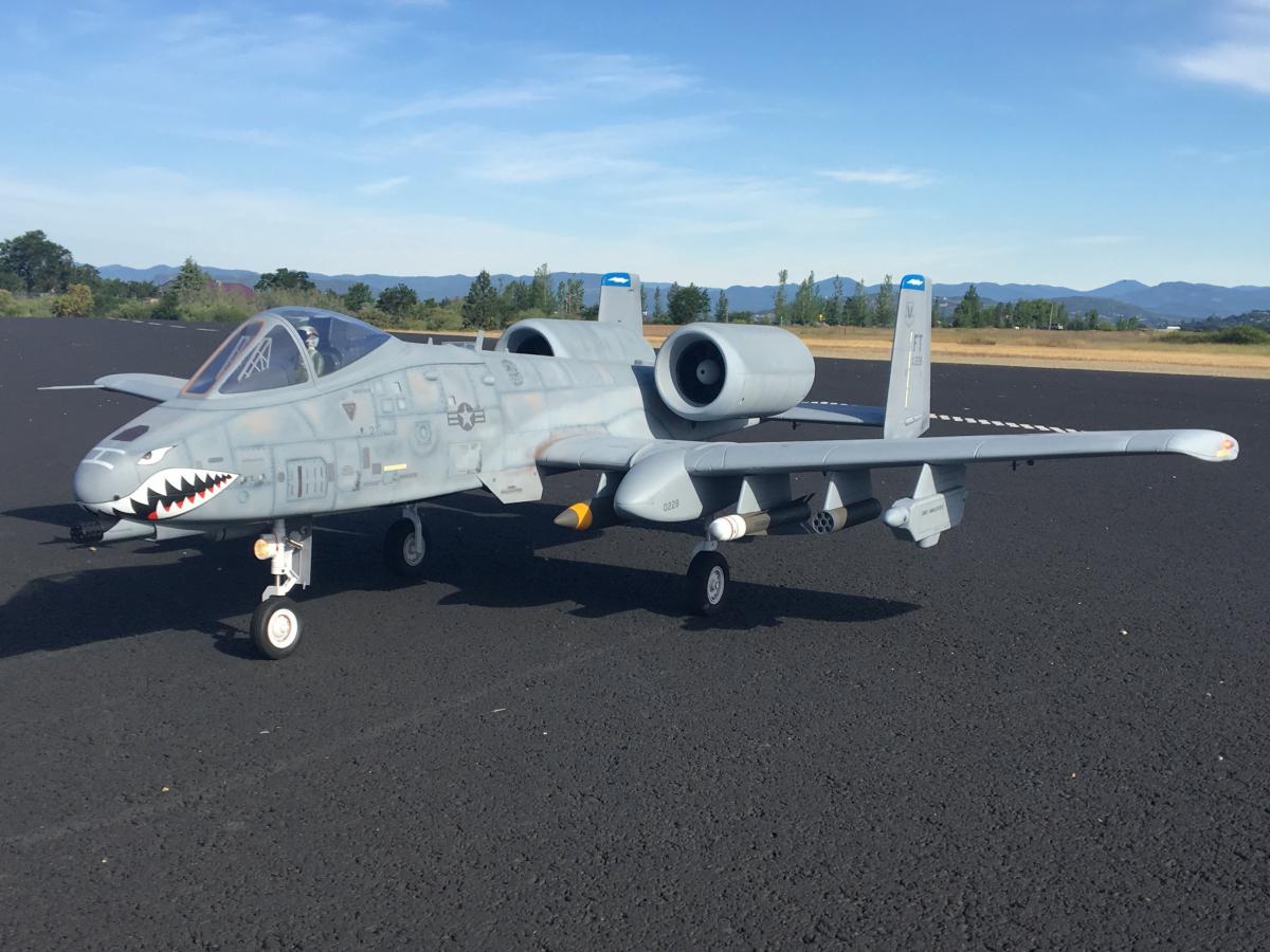

            There's been a lot of input re: paint and airbrush techniques. I think one big variable is what type of airbrush you use. I have model type airbrushes...smaller and more fine than some of the more commercial types you get at Harbor Freight (with triggers, and more of a gun look). I originally used HD paint and thinned with Createx High Performance Reducer. That worked okay, with a lot of clogging and clean up. I used Tamiya for the pre-shading and thinned with Tamiya thinner. I would not mix Lacquer thinner with Tamiya, mostly because I don't think the paint will set well. I did the whole plane a second time, masking the decals, as I didn't think I had enough difference in the two shades of ghost gray (I color matched the FS numbers at HD). I used the same pre-shading and custom mixed my own color coat with Tamiya acrylic. I can look up the colors if you want. I did end up with a Badger Patriot airbrush, which is better than the Pasche I had before. They are harder for a big model like the A-10, but I found you just have to do one panel at a time, and it comes out better! Rob Click image for larger version
