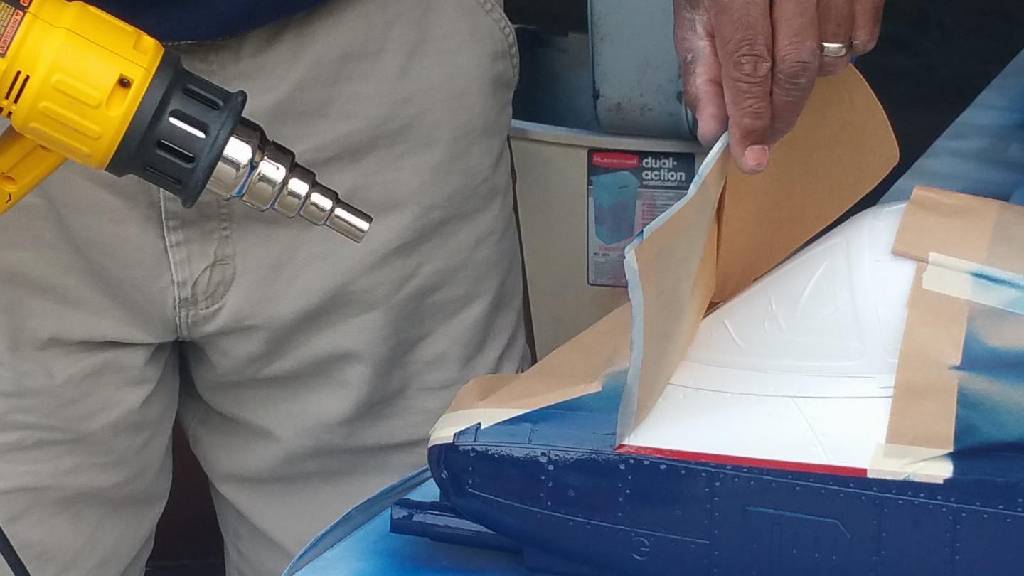

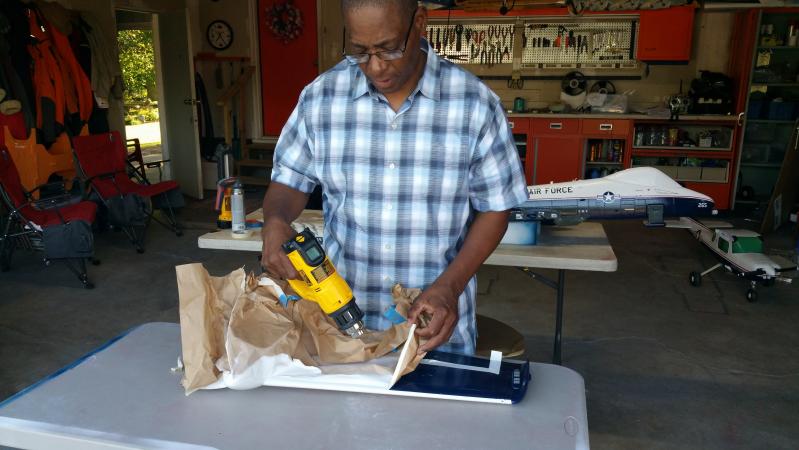

        My trick for pulling the tape off, is to use a heat gun set on low and warm the tape as I pull it off at 180 degrees direction , making sure not to be too close or too long on one spot.
        When I'm done painting my A-10 I will show you the results.
        Heat set at 150 degrees, pull slowly, steady, don't get too close.

            • Saint Clair Shores, Mi

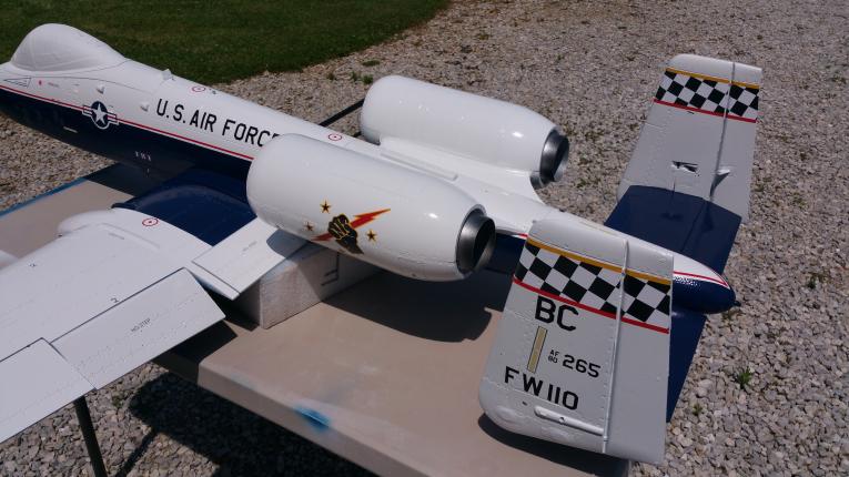

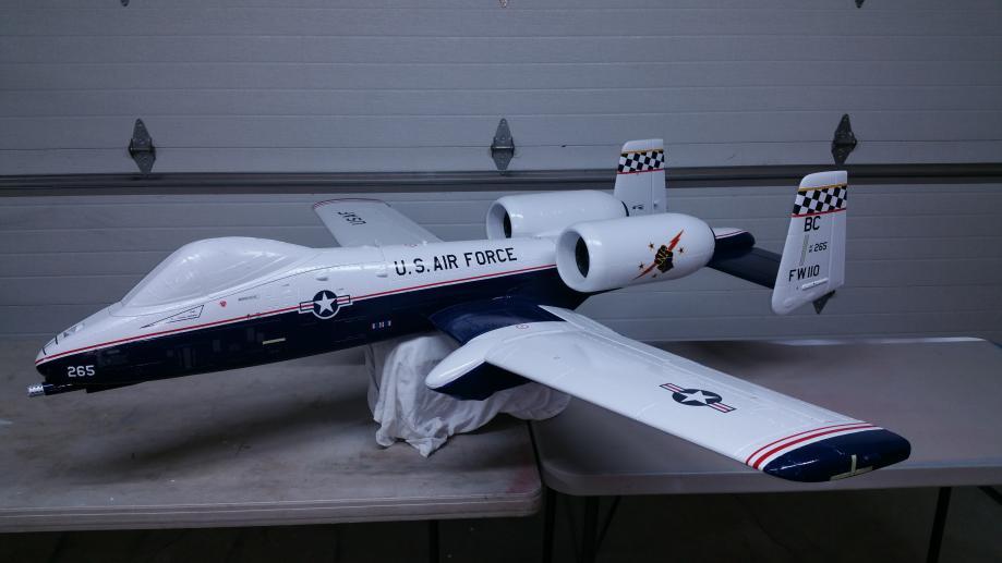

            Sorry guys, I went totally Rogue on this project.
            Plus gray planes are hard to see for this old man
            It must be a USAF theme this year for me.
            Sorry for the bad pictures , but I have LED shop lights and I can't get a clear pic anymore.
            Click image for larger version Name:	20170704_213235.jpg Views:	1 Size:	45.1 KB ID:	84672Click image for larger version Name:	20170704_143041.jpg Views:	1 Size:	58.4 KB ID:	84674Click image for larger version Name:	Screenshot_2017-07-03-13-19-06.png Views:	1 Size:	78.8 KB ID:	84675
            Looks really good. Nice touch.
                    B Hn ULTRA sweet!!

                                  Unfortunately to late for me. Gotta do the touch up. Oh well.
                                  Sorry I didn't put this out earlier.
                                  You have to practice to get the feel of the tape and watch it give way as you pull on it.
                                  You will get better at this with time like I did, this is my fourth plane this year painting and I just learned on the fly from my mistake.
                                  A bad one was I thought I had the heat gun set on 150 degrees but it really way 1500 degrees while I was pulling the tape (gater finish that will have to be fixed later) Now I leave my hand in the way of the gun to check the temperature as I go just in case I made a mistake on the heat setting.
                                  Good Luck.
