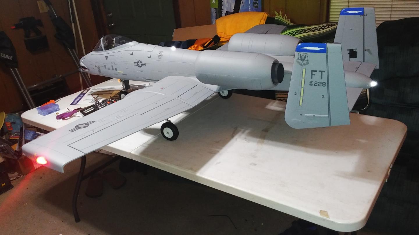

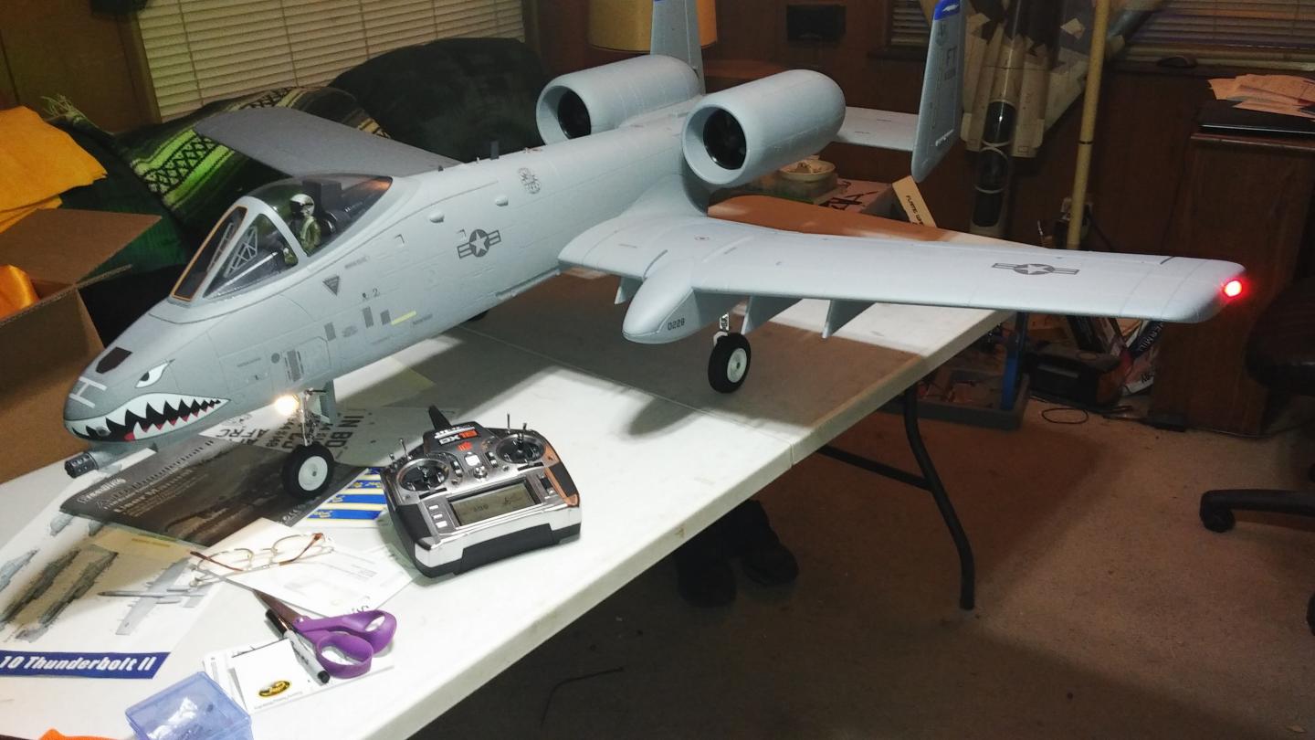

ID:	81390 Mine is finally almost ready to maiden. Just need to make myself a transport & storage stand before adding the lower fuselage bling.

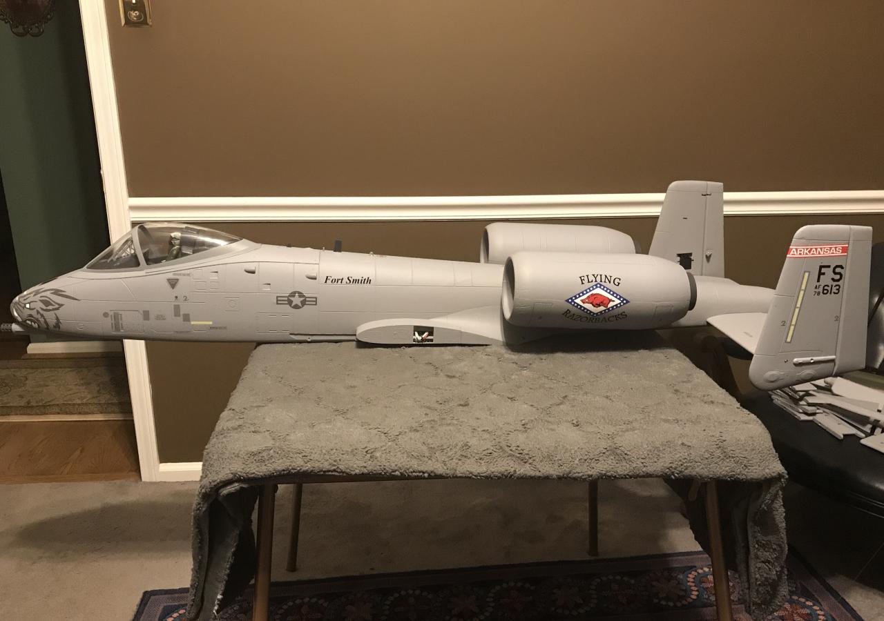

            Build went flawlessly. All buttoned up, throws, CG...Was hoping to maiden this evening but alas it's not in the cards. Sports going on at the school and my wing man isn't available, plus dodo head forgot to charge up the 6S 5000's... <face palm>
            She's void of any decals because I plan to paint her in the Arctic Camo livery after a few sorties. I've got Callie on speed dial. ;)
            As all of you who have one already know, she's one impressive model! Even though I'm in the industry I still marvel at the quality of these foam models coming out these days. With rain coming in, I probably won't be able to maiden until early next week after I get back from Friday Harbor...

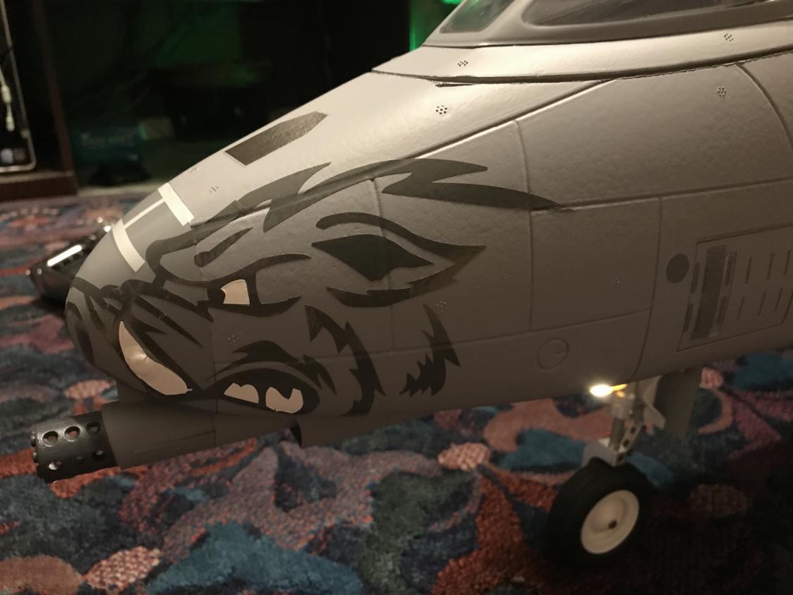

              A little taste of the Flying Razorback, from Callie.

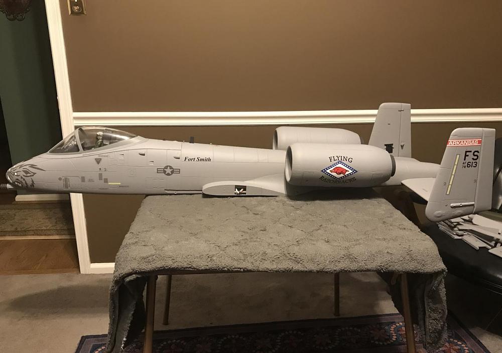

                                        Another look at Callie's scrumptious graphics. Click image for larger version
