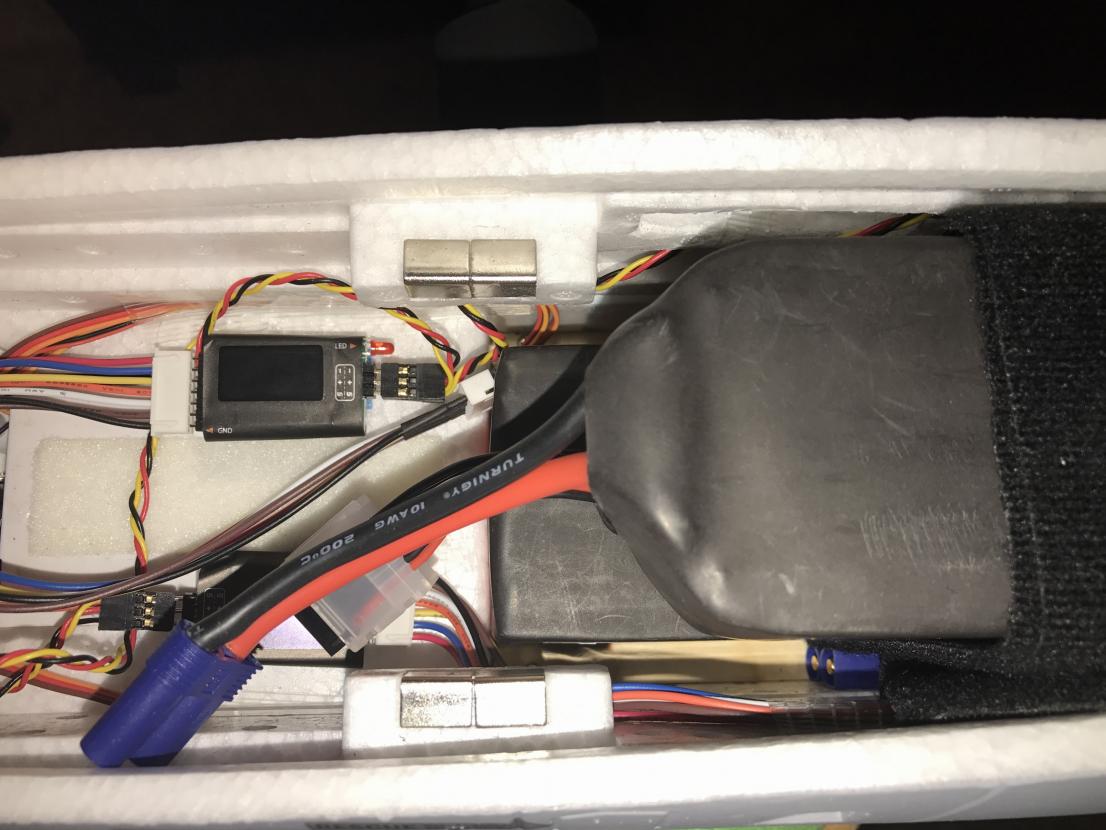

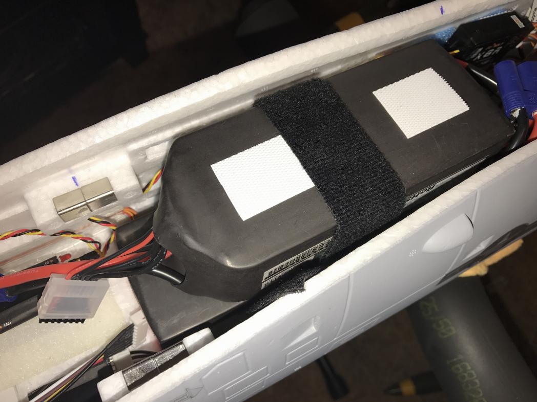

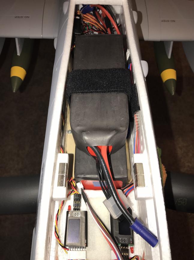

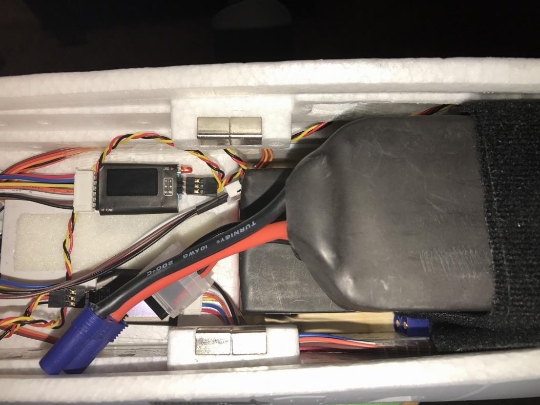

                T-Cat, I believe you said you are using Turnigy Graphene 5000s in your hog; could you post photos of exactly how you position them in the fuse, and the bottom of your cockpit section showing the adaptations? Thanks!
                  • 2137
                  • On planet earth....right
                  #4768
                  I sure can. The LiPo's in the picture are the Turnigy 6S 5000mah 65C. Keep in mind though that I have heavier power systems installed (the Freewing 80mm EDF 12-blade with 1820kv motors), so I had to ensure these had to be moved forward enough to balance. With the stock lighter system, you may need to see how much further aft to achieve proper CG. I also have an aftermarket pilot installed, and chopped quite a bit of the foam away from the center section of the canopy, but you will see how much is needed (if at all) with your install. The bottom LiPo is has hook and loop (Velcro) secured to it and the plywood floor for added security since they are heavy batteries. I also added two more screws in the center section plywood (one screw on each side) also for added security. The top LiPo sits on top of the other with a small rectangular cut piece of kitchen cabinet mesh non-slip material, and the velcro used (to ensure it was long enough) is the One-Wrap long roll cut to proper length and width with plenty of extra (much more than needed) just so I can easily grab onto it secure it properly. I didn't like the 3/4" width Velcro roll, so purchased the 1.5" and just trimmed a little width off it to fit perfectly in the oremade velcro strap slits on the plywood battery floor. The link to the velcro is below. I found the velcro at my local Home Depot.
