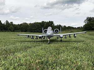

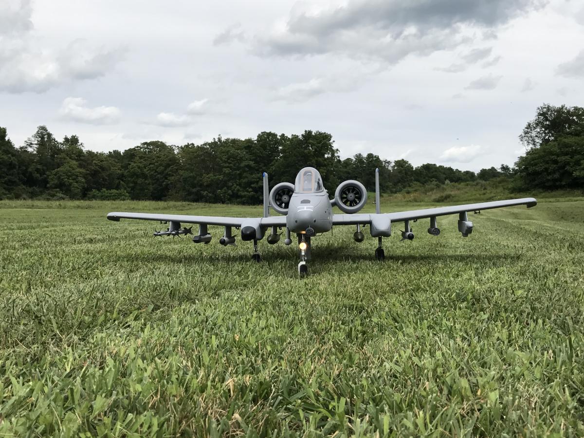

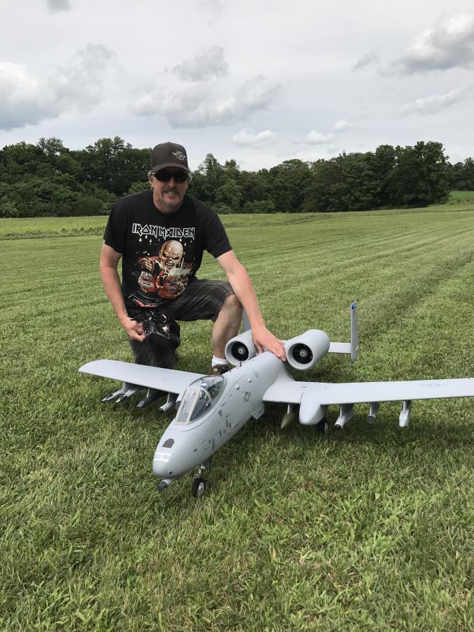

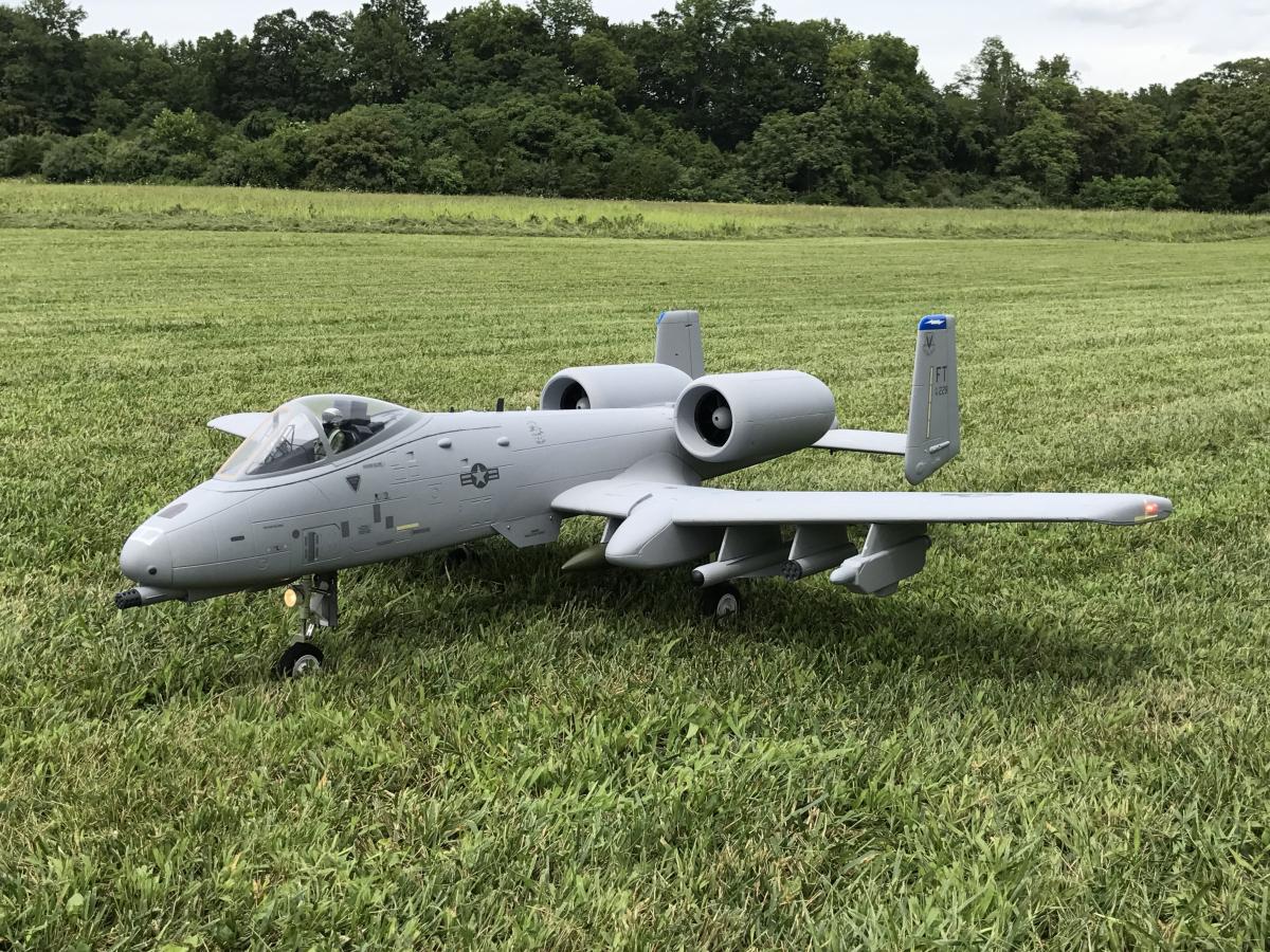

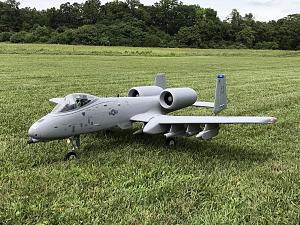

          IMG_1121.JPG Just love the looks of this bird!
          Click image for larger version  Name:	IMG_1119.JPG Views:	2 Size:	214.7 KB ID:	91521Click image for larger version  Name:	IMG_1120.JPG Views:	1 Size:	291.7 KB ID:	91520
          I'll get the balls up to add the nose art this week!

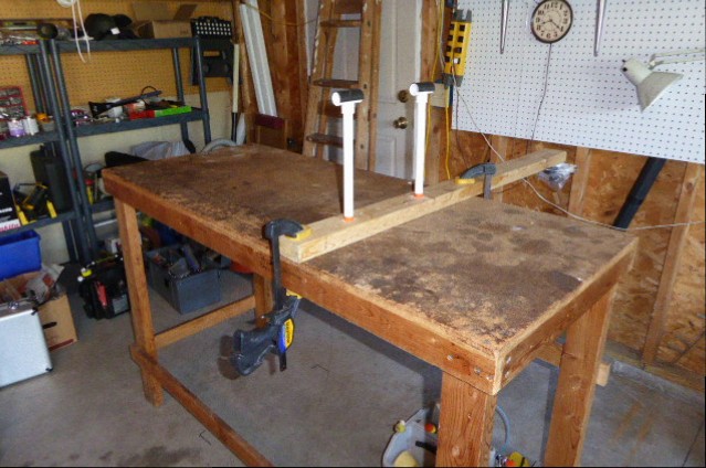

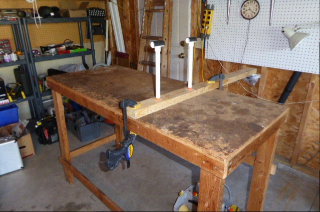

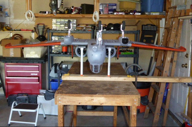

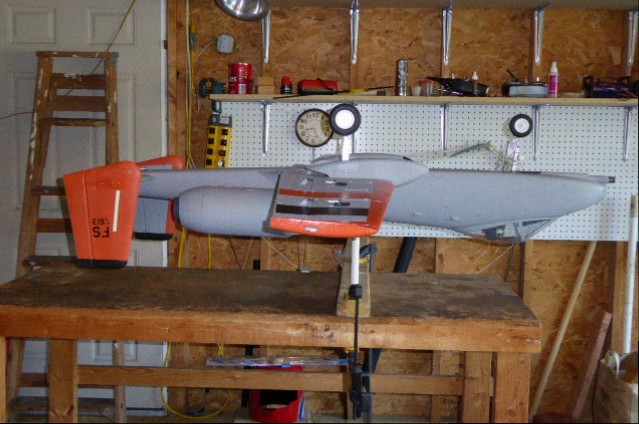

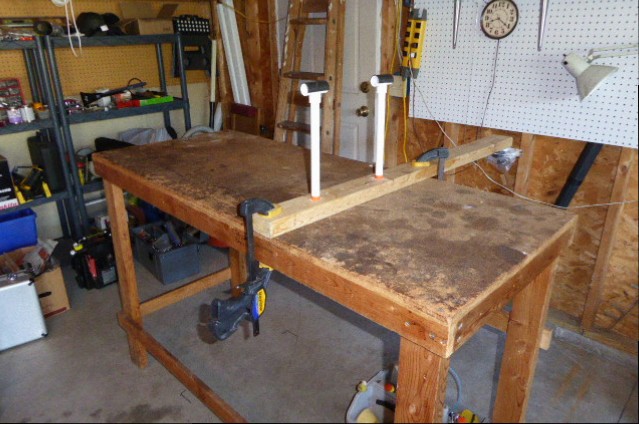

                                        INEXPENSIVE BALANCING STAND FOR YOUR FREEWING A-10
                                        I made this stand with parts I had around the house: a piece of 2X4, some 1/2" pvc, a couple of "T"s, and some "Non-Stick" tool box liner.
                                        The only thing I had to buy was the liner - and now I can line my tool boxes with the leftover!
                                        It is self-explanatory. Glue the tool box liner to the top of the "T"s. The center-to-center distance between the uprights is 10". The uprights should be at least 10" long. I drilled out the 2X4 with a 7/8" bit, which is a little sloppy, but I put a couple of laps of orange duct tape around it so they fit tight.
                                        As long as you are close to the CG, the liner will keep it from slipping and you can move the airplane around until it balances perfectly.
