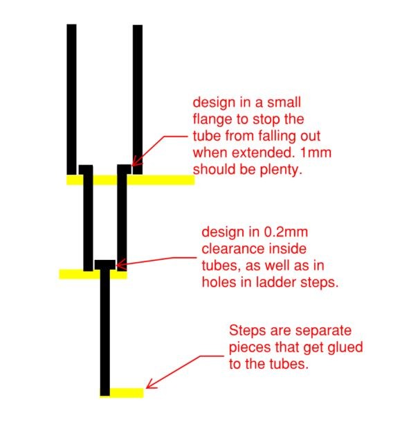

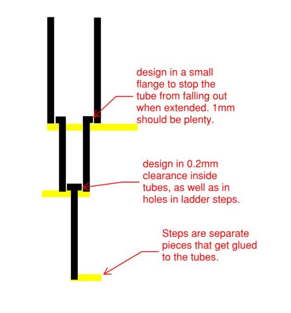

Topshot19 check out the crude diagram. this is a Cross-section view.
basically each telescope section is broken out into a tube and the ladder rung. The tube should be hollow to allow the ones below it slide in, and have a small clearance so things don't get seized. The tubes have a flange designed in so when it extends the flange gets caught by the ladder rung. Each ladder rung needs a hole modeled into it to let the tube pass through, but be small enough to catch the flange.
Edit: also, you cant print everything vertically, make the tubes have a 0.8mm wall thickness and it will work fine.
