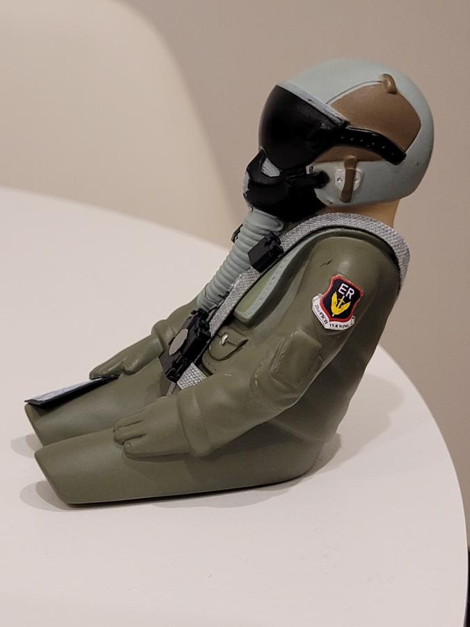

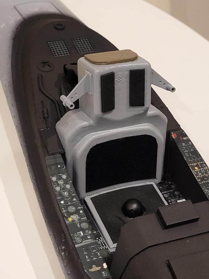

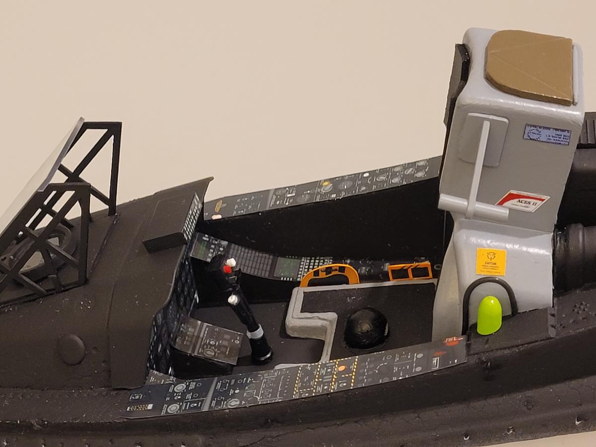

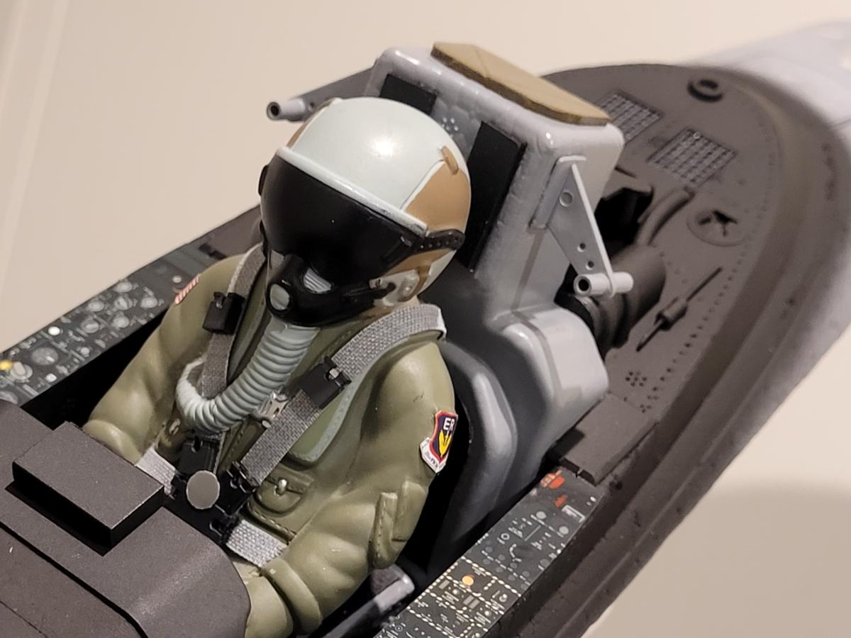

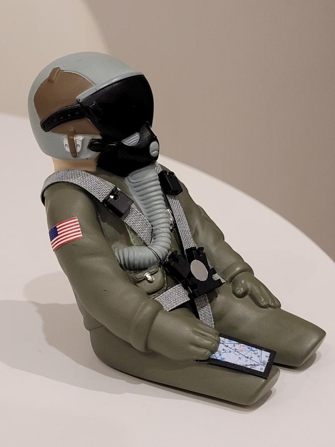

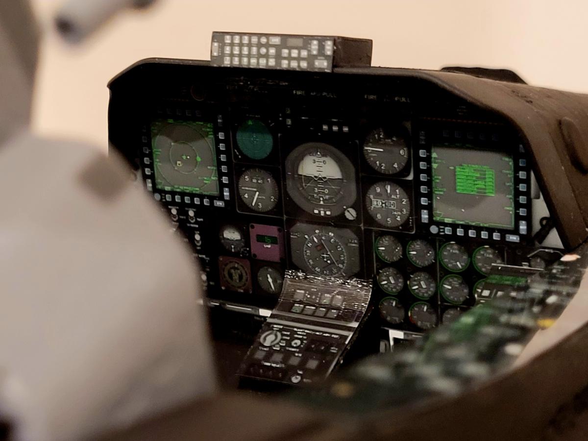

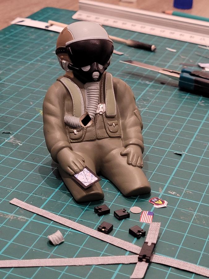

                                My vision of the cockpit
                                ​...but it's not over yet
                                  • 4875
                                  #11317
                                  RAFALR30 Great original work, Sir. Impressive results using all OEM placement. Best, LB

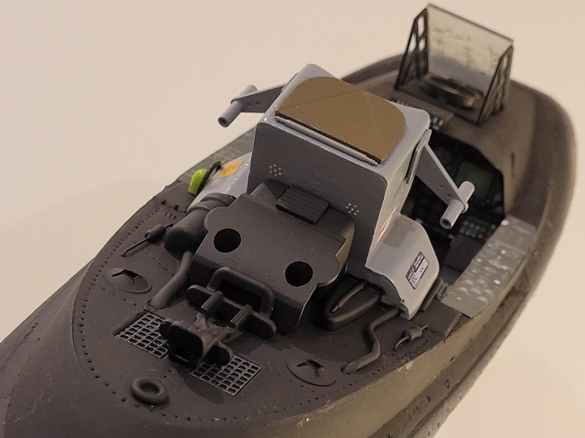

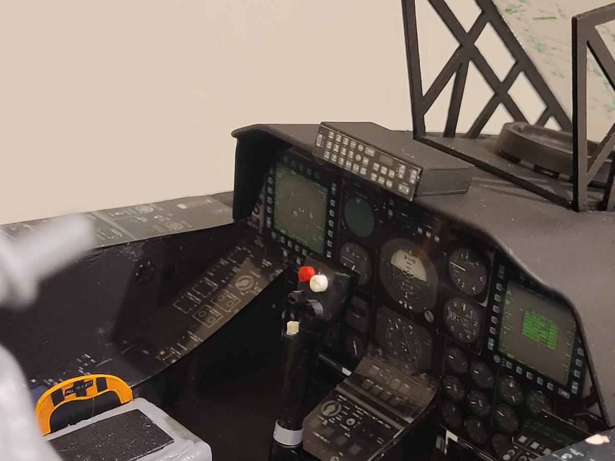

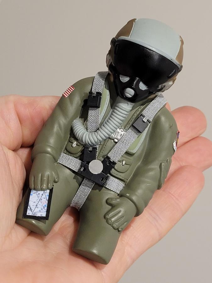

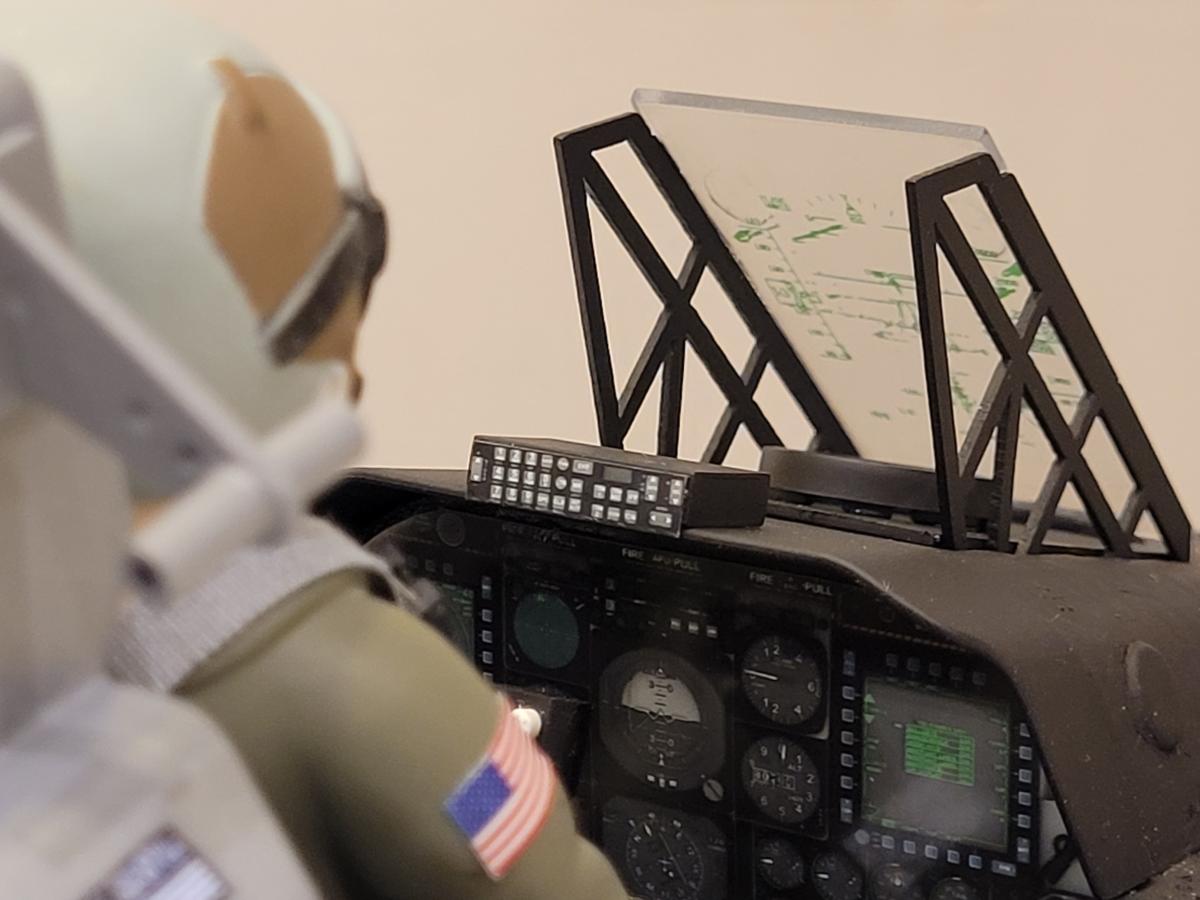

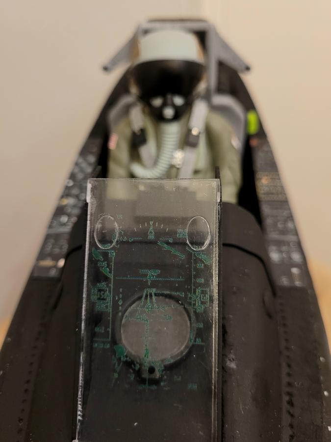

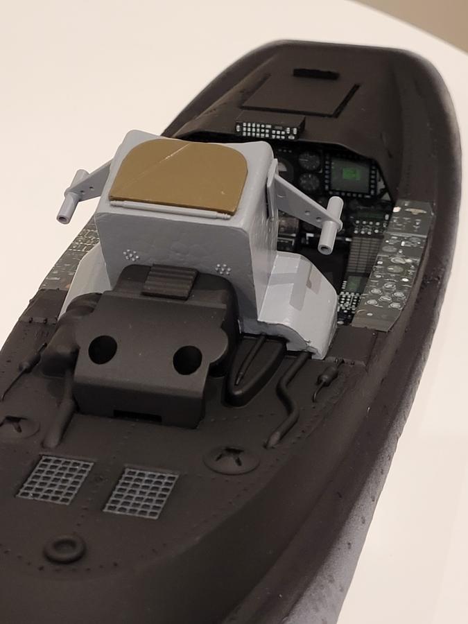

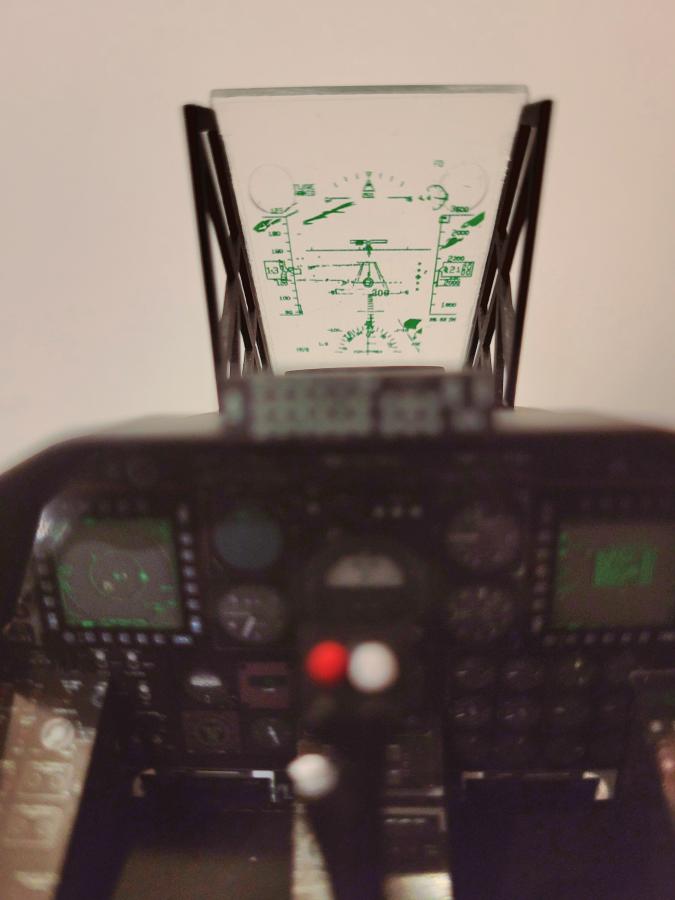

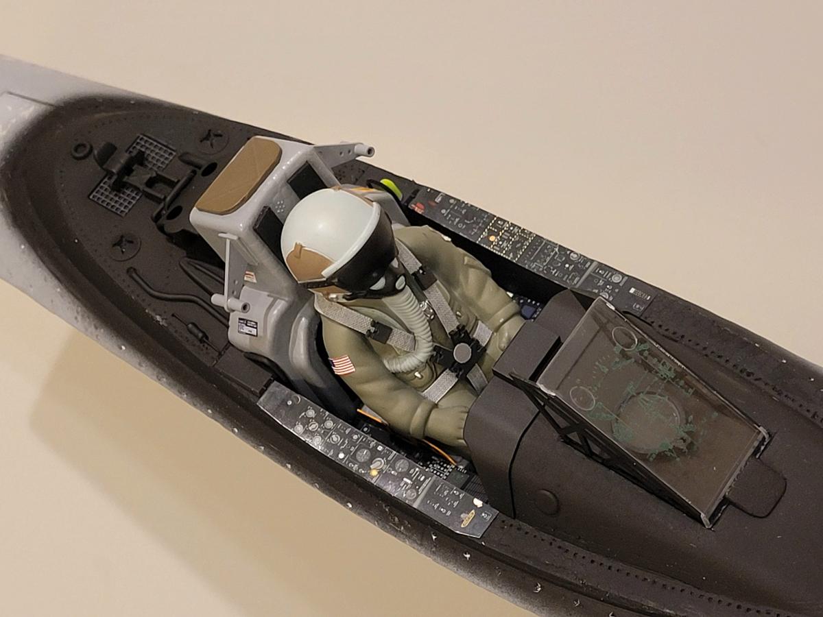

                                    This is the end of the work - the cockpit is finished.
                                    And it's all made of "waste" such as: resistors, plastic parts from Kinder toys, wires of various diameters, the tip of a green brush, parts from a pen, a cable ferrule, a part from Ursus tractor lighting, transparent film, a lollipop stick, material from an old phone case, electronic connectors...
                                      • 4875
                                      #11319
                                      Originally posted by RAFALR30
                                      This is the end of the work - the cockpit is finished.​
                                      RF, Bravo Zulu, Sir. Very nicely done. Diggin' the HUD. Best, LB

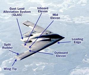

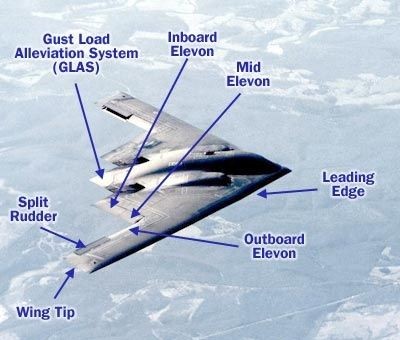

                                        [QUOTEAfter seeing the B-2 with the drag brakes. I have since wondered if it would be possible for Free Wing to develop an update to the A-10, to add the drag brake setup with the ailerons would be a great addition to this Fighter][/QUOTE]
                                        The B-2 incorporates what's known as a "Split Rudder" out at the wing tips. This system keeps that plane flying straight, and I would also suggest it provides drag to slow down the plane much like a speed brake does, however, don't hold me to that, I'm not a B-2 expert. If the B-2 didn't have this system it wouldn't go too awfully straight. Northrop's flying wing also had this system but I doubt it was computer controlled. I'm sure there are more well informed experts on this forum when speaking of the B-2 such as GG.

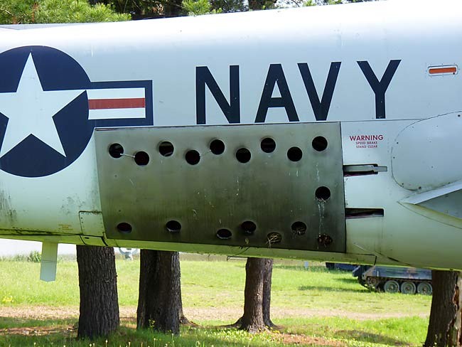

                                        If we take a look at the A-6 the split devices at the wing tip are there to create drag on final to spool the engine up to a certain percentage N1 or maybe EPR should the aircraft bolter (go-around). Without that drag on final the engine would take time to spool up and go in the drink. The system is designed to close them when the throttle is advanced when they do bolter so they are not penalized for airspeed. The A-6 has dive brakes on the side of the fuselage aft of the wing. When I was in the Navy these dive brakes were bolted shut on some aircraft and never used. Over time the aircrafts mission profile changed from the original diving style bombing to low level ingress to a higher level bombing profile of dropping LGB's (Lazer Guided Bombs). Gone were the days of dive bombing. My son who's now in the Marine reserves flying the F-18 said his time over Iraq he dropped his JADMS from a higher altitude 18-20K and from a distance.
