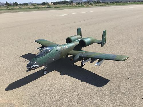

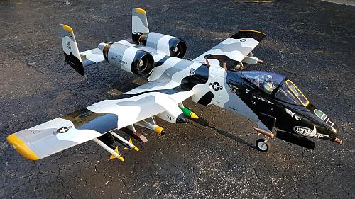

                                        • 2716
                                        #11479
                                        Originally posted by JPD

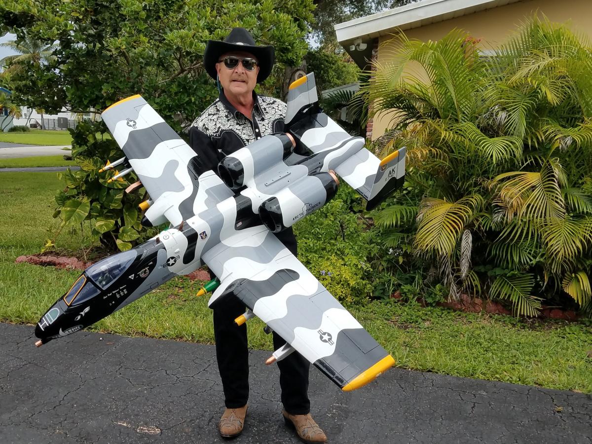

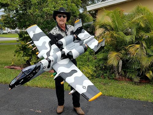

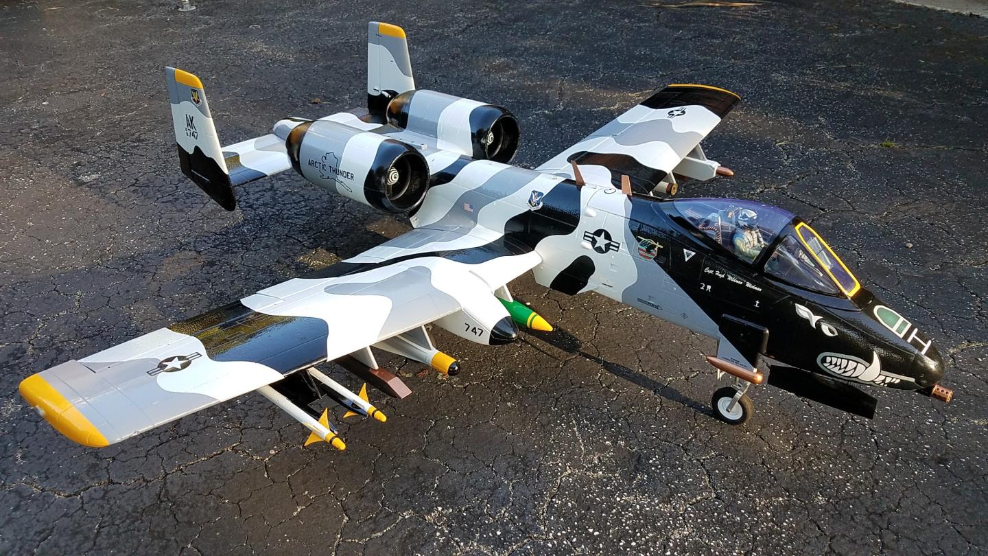

                                        Does anybody out there have a Spectrum (DX8e) flight profile for the Freewing A-10 80mm EDF they'd be willing to share. The jet is on its way along with some 80mm X-Fly motors/12 blade EDF, paired with Spectrum/Avian 100 amp ESC's and a Spectrum AR8360T receiver. I'd like to get a starting point for AS3X/SAFE mode settings in the flight profile if I could based on real world experience...I've peeked at the manual and it seems fairly comprehensive insofar as throws/deflection for empennages, but I've had to start from scratch on a few other models after finding the flight envelopes didn't even come close to working. Anyhow...would love a Spectrum flight profile for this thing...
                                        I'm using an AR 637T RX and an IX 14 TX so I don't want to send you my programming files as there may be some differences between the 2 transmitters which could cause more harm than good.
                                        With that said, I can give you a few starting points I like, but everyone has their own personal preferences, but keep in mind that I never program in SAFE as I really don't like the way an aircraft flies with it and it makes me feel that I am not in complete control of it's orientation. I have my FM for gains set to my switch C (AUX2) with flying gains at 50/55/60 (I know that sounds high but works for me and I can dial the gains down in flight anytime with my right knob as my gain switch-but never had to), take-off gains at 60/70/80 and landing gains at 70/80/90 with all priorities at 160.
                                        Flaps at take off are deflecting 29 mm with 2% up elevator compensation, while landing flaps are at 50 mm deflection with 4% elevator comp. 3 different D/R & Expos tied to a 3 position switch, ailerons for low/mid/high at 60%/72%/85% deflecting 30mm/36mm/42mm (this will depend on which holes you use in the control horn and your TX), Elevator 85%/100%110% which is 30mm/34mm/36mm, and Rudder at 70%/75%/80% giving 21mm/27mm/29mm. Expo at whatever your personal preference is but I like it relatively high at 20-30%.
                                        Main recommendation I have is not to fly it at the manual 78mm. Way too nose heavy making landings more difficult that could result in a nose first touch and the "dreaded" Bucking Bronco". :face_with_symbols_o I have mine balanced at 92-94mm, which results in extremely easy flying and landing. Don't forget that the jet wash goes directly over the elevators, so if you have it too nose heavy, hence more up elevator trim, the throttle position will affect the attitude much more than with other aircraft causing it to climb at high throttle, and drop at low throttle. At 94mm, once trimmed it will maintain the same attitude no matter what your throttle position is. I'm flying mine on 2 of the new SMC HiV 5900's, each weighing 740gr and have the batteries in line (not stacked on each other) as I removed the circuit board in the back, stuck it to the port side of the fuse, and can position both batteries far enough back to get my desired CG. I'm sure the Avian ESC will also handle HiV batteries if you're so inclined. Flight times are 6-7 minutes and I earlier replaced the old standard 80mm outrunner fans with inrunner fans from my Mig when I upgraded those.
                                        In my option, this is definitely one of the best flying EDF's in my arsenal, takes off smooth, flies exceptionally well, cruises much slower than you'd think and lands like a trainer. You will not be disappointed. Looks Bad A.. in the air as well!!!:a10::a10::a10:
