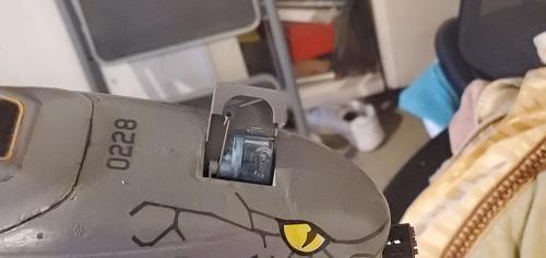

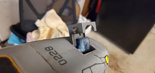

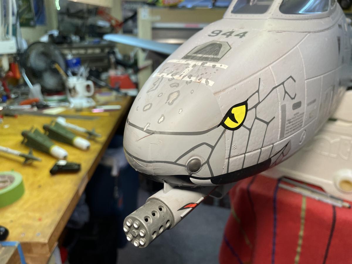

                    cannon is 3d printed . The fuel port door open and closes with a micro servo in parallel with the gear door. Opens when gear is up and assists with cooling the battery

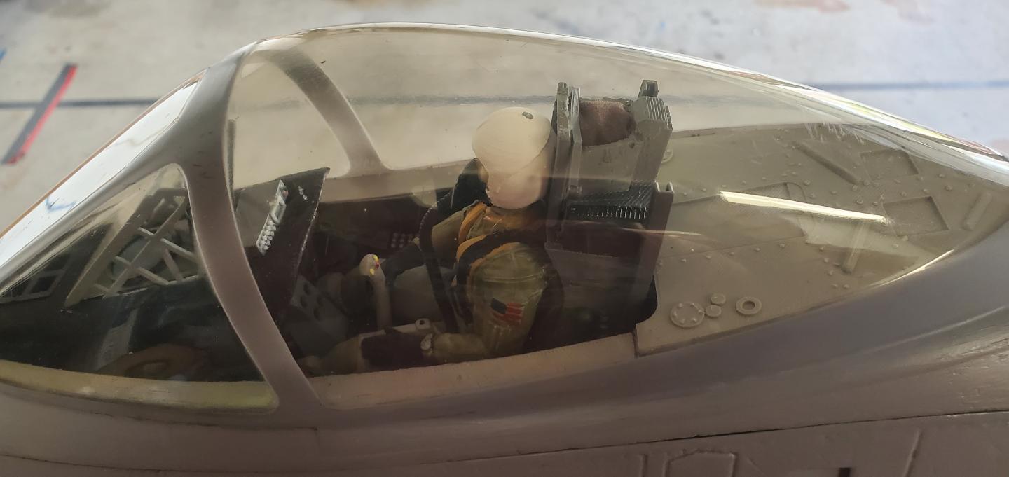

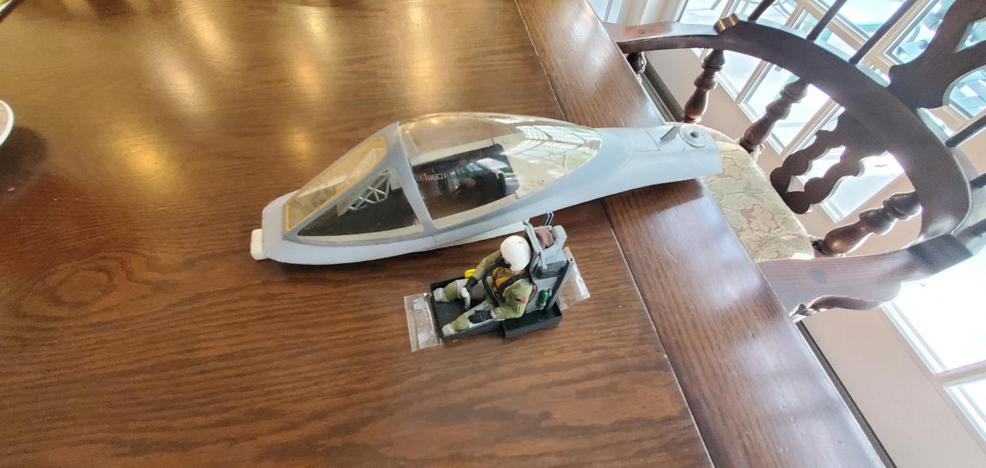

                          #11293
                          Originally posted by Pilot-GJC
                          Love that idea, would be really interested if you had anymore photos?
                          Where did you get the 3d printed cannon from?

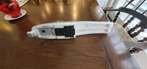

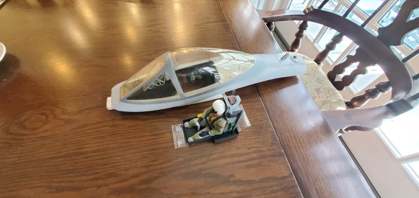

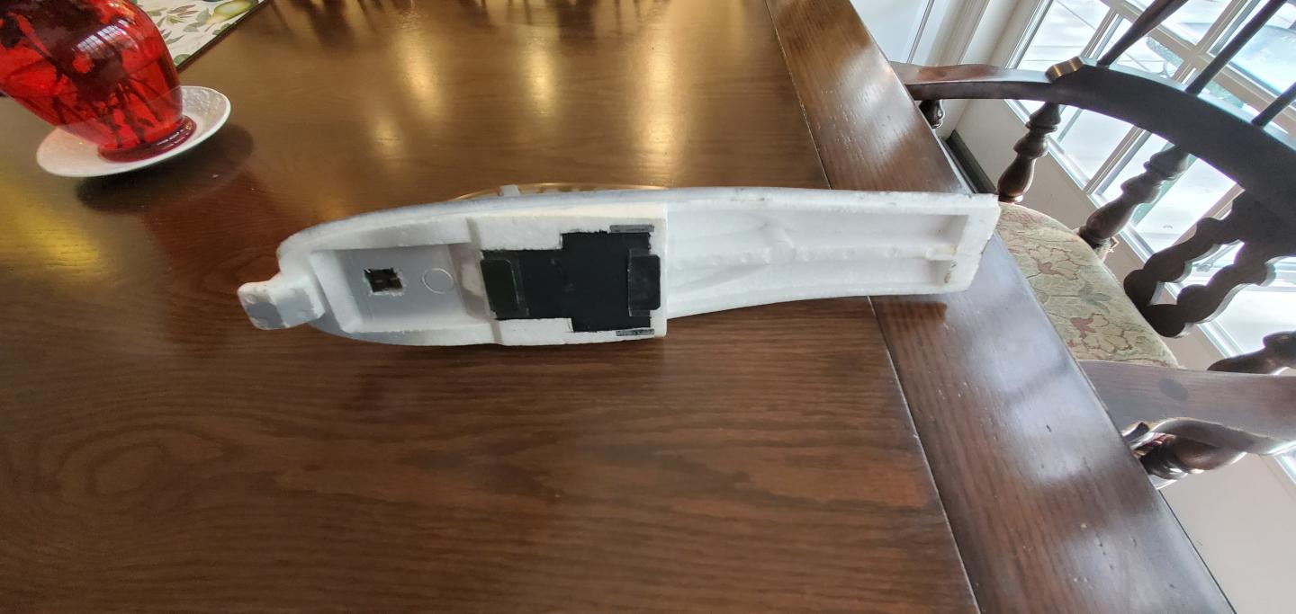

                          everything is printed on a Prusa 3d printer. You will save money if you buy a printer instead of having it commercially printed. Programming is easy with Free "tinkercad". If this is not your thing check out thingiverse.com. Search for DirtyDee for A-10 stl files which can be commercially printed. The gattling gun is hard to print requiring multiple steps. The holes are the hard part requiring a jig with support inside and outside the heat shield. I have included some pictures ​ to perk your interest. ​ Click image for larger version

                            I'm literally printing the gun as we speak, cockpit and pilot are next, I then have a really cool idea for the ladder, will be printing off the more scale looking nacelle outlets and then for more scale looking ordinance. The new paint scheme is almost done, I've printed off the majority or decals using my partners printer.
                            I'm still pretty new to all this but I'm learning with every project.
                            Anymore pictures/details on the fuel port door as I think this would really finish the model off.

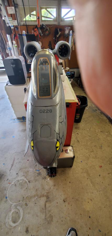

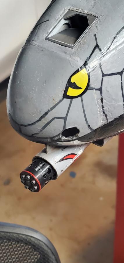

                                the hinge for the fuel door is just .2mm pla. Very flexable at this thickness and mine has lasted for over 1000 cycles. Also try to design everything in vase mode with no supports. For strength print a tube to go inside to act as a doubler. Also consider using different materials. The IR sensor on my sidewinder is plastic tube, sanded to shape and buffed out with a dremel drill. All on Amazon. And while you are at it, make a case for your missiles. Hope this helps

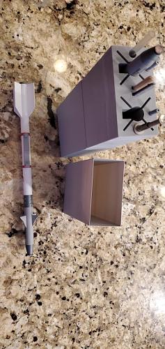

                                        Here is a accessory to go with your A-10 that is selling on Etsy. It is a replica of the GAU-8/A Avenger in the A-10 that measures 19" long and 6" high while sitting on the stand. Here is the link to the shop also there is a pen holder on there as well https://www.etsy.com/shop/Exocoetus?..._id=1341983043.
                                        I started designing the boarding ladder but have gotten side tracked on other projects on the AL-37 side. I plan on returning to it soon and I will put the .stl files up on here
                                        Jeff
