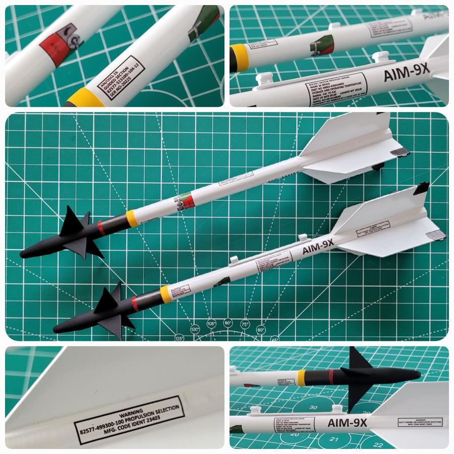

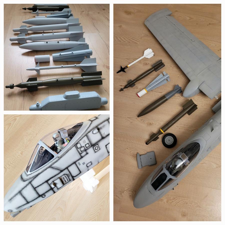

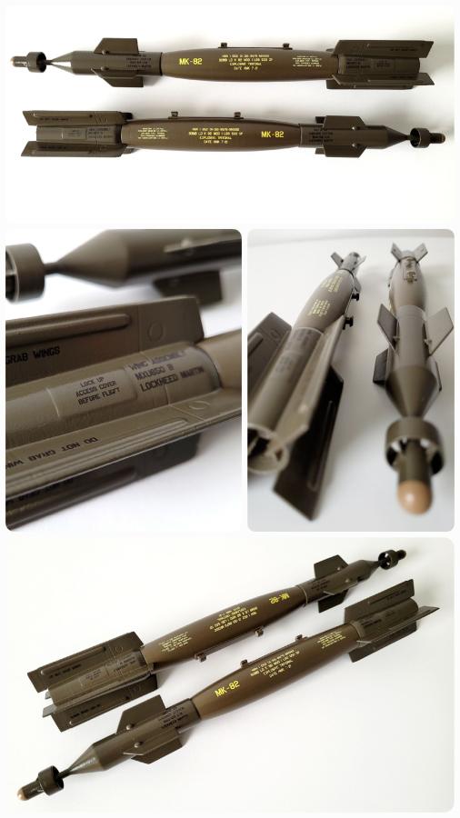

      Step by step. Work progress.

        RR, indeed...Gorgeous details & great work. Best, LB

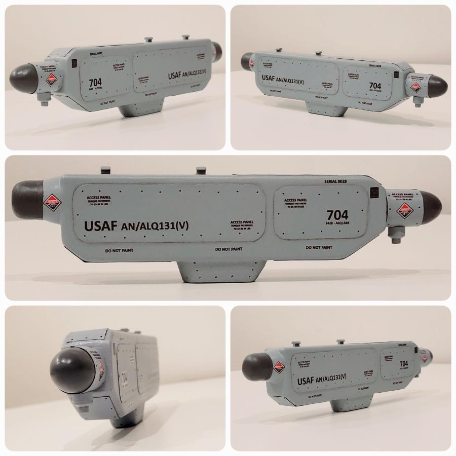

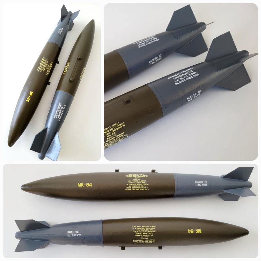

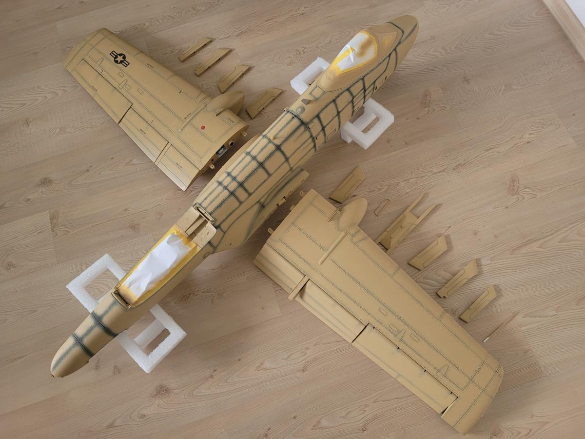

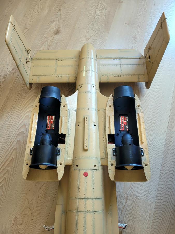

          Work continued.

            RR, Simply, great details and what a beautiful finish on the model. I'm smiling. Best, LB

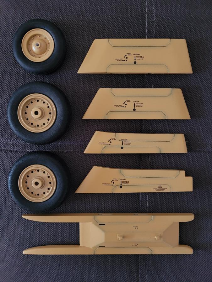

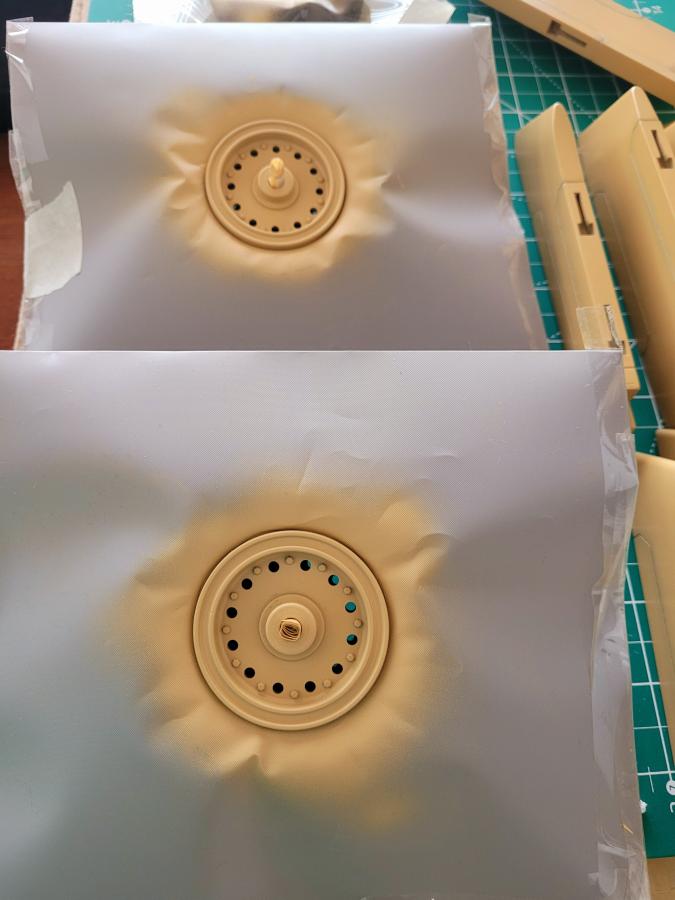

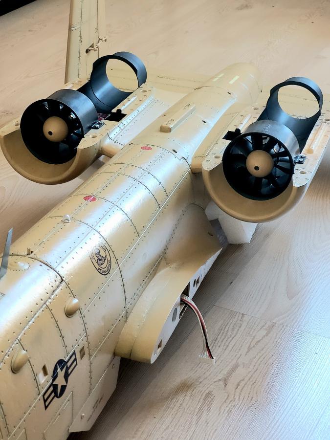

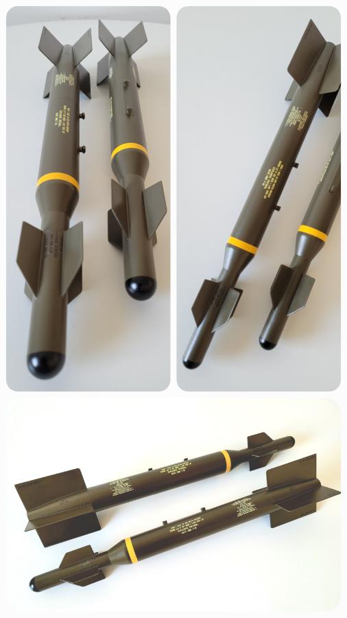

                  Work, work, nice work.

                    RF, Nice work, indeed, Sir. Looking forward to more pictures as you progress. :pop Best, LB

                      Nice work there RAFALR30.
                      Love the pre-shading weathering and nice scale look!

                            I did airbrush shading for the first time. A lot of work but the result is very nice. Glad you like it. Thank you.

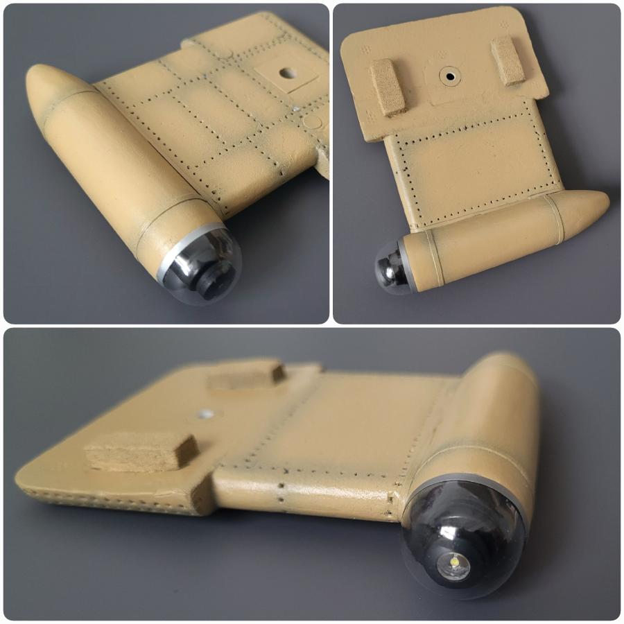

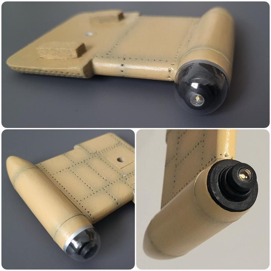

                                  This time I finished the AN/AAS-35 Pave Penny pod. Details made of what is in the drawer, of course: silicone bumper for drawers (painted black), diode housing, flat-faced LED, grey/silver adhesive foil. The housing of the head is a previously prepared "hoof" made of wood, on which I stretched a heated transparent plastic (package from a food product).
                                  I will try to make AGM-65 Maverick missile warheads using a similar technique.

                                    RAFALR30, now that's some clever modeling. "We don't need no stinking 3D printer". Outstanding work, Sir. Best, LB

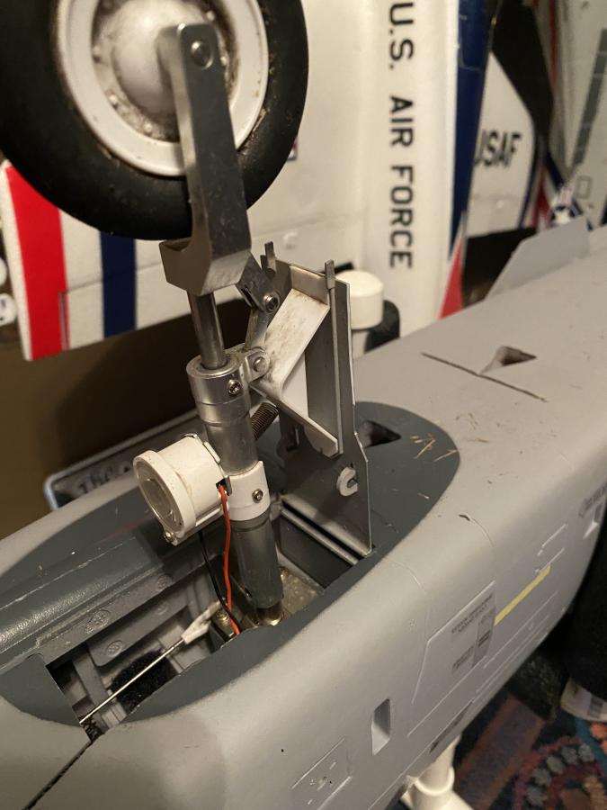

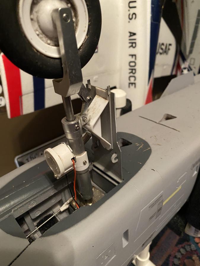

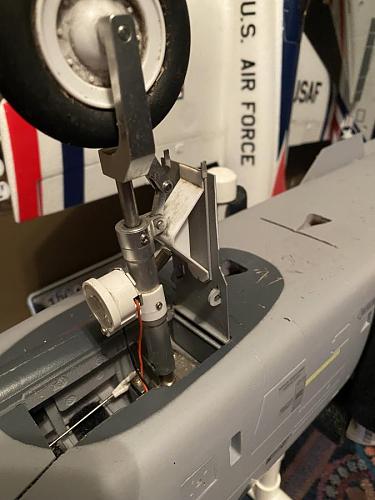

ID:	383286 Ok, nose gear experts, I need your thoughts…while taxiing back to the pits on my grass field the little white angle thingy on the strut door popped of, it’s still whole and thinking about glueing it back with the stuff Motion uses to glue the fuselage pieces together, or is there something better? Bigger problem, on takeoff roll I noticed it was hard to keep a straight heading it wanted to wander bad on the ground, when I investigated the nose gear strut is loose causing a left or right turn. The metal servo horn attached is rock solid , no movement just the strut itself. Before I start ordering partsbreak into the nose gear and start taking stuff apart I’d like to know what to look for.

                                        White tube glue, yes. Sounds like a loose set screw.

                                          Mine came off as well, I just drilled two tiny holes, one at the top and one at the bottom then I put some tiny little screws to hold it on, never had an issue after that.
