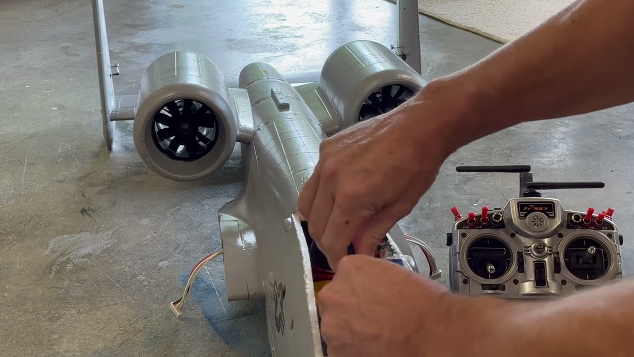

              I made a video during one of my troubleshooting sessions. It's a bit inconsistent, sometimes it will stay at WOT just long enough for me to "trust" it, and then it cuts out. UGH! Give me a carburetor and a screwdriver Ha!

                I made a video during one of my troubleshooting sessions. It's a bit inconsistent, sometimes it will stay at WOT just long enough for me to "trust" it, and then it cuts out. UGH! Give me a carburetor or a screwdriver Ha!
                I can only guess that in my case with the AL-37, that it's a "similar" occurrence because mine happened in the air, resulting in a dead stick landing in the tall grass. Is there any way you can tell if the ESCs are hot when the motors cut out?

                      This is still baffling (yet interesting). The only thing I can see as being really different is that the Cessna is a single ESC/motor plane. The AL-37 is the first twin that I've used reversing HW ESCs in. The only other twin I have reverse is the Freewing PJ50 bizjet but that one, I set up using the Avian smart ESCs and smart RXs. However that one required using a separate smart RX to control the 2nd ESC and reverse. It would not work when the 2 throttle leads were Y'd together. It seemed the Y'd signals was too confusing for the system. I use the HW 120A reversing ESC in only one other jet and that one is the 8s Freewing F-18 and it has worked flawlessly. So, the only difference that's coming out of this so far, is twin vs single.
                      Have you tried this? ................................... Eliminate the twin vs single by isolating one ESC/motor completely from the other ESC/motor. IE, don't allow the sharing of throttle leads, reverse leads, flight batteries (via Y's or any parallel hookup of the batteries - in the A-10, I don't think either battery shoots any power to the other system in stock form unless you wired it that way afterwards).
                      If I can't figure this problem out with the HW units (or if you haven't figured it out) by winter, I will convert my AL-37 to the same system used in the PJ50 (ie, twin Avian ESCs, smart RXs with one being a simple 4-ch to control the 2nd ESC). The PJ has been flawless. I need the same reliability for the AL.
                      PS, I've had a Funjet and it can be a weird little plane, so why it didn't work there is another mystery.
                        YES! It was in the 2nd half of the video posted above. 1 battery, 1 motor, 1 ESC, with the other ESC disconnected (throttle and Reverse wires).
