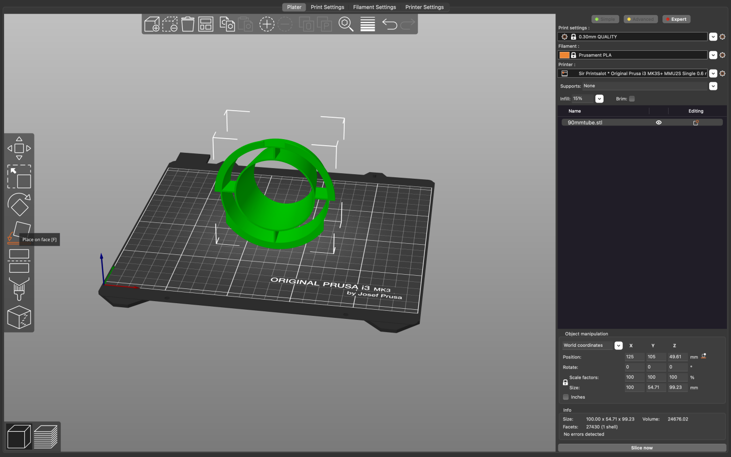

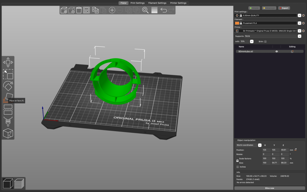

        Yes, I am looking for the 90s. Rudy, This file has the nozzles standing on it's edge with a brim or skirt, instead of laying flat on the heat bed. I'm a 3D printer idiot, and don't know how to change it!!

          WH, are you using Prusa Slicer? On the left-hand menu there is an icon that reads "Place on Plane". I just call it 'lie flat'. Click it and then the face of your object that you want on the print bed. Best, Steve

            As Elbee mentioned, there's a button here on the left that says "Place on face". Click that and when you hover the mouse over the object, you should see different planes highlight. You can click on one and the part will rotate the plane you clicked down against the bed.

              See,, I told you I was an idiot!! LOL. When you do that, does it get rid of the skirt or brim?

                WH, The skirt is always in your prints. It is in the G-Code and allows the printer guidance for the print layout and layer thickness. On the right hand side there are options. These include a brim setting check box. Turn it off, no brim, turn it on, brim. I would not print that part with a brim, but it is probably advisable to do so if DD has designed it into the STL file. To remove it from the STL file you'd have to take back to your CAD software and remove it there. Are you working with DirtyDee's STL files or are these DD's G-Code files? Usually you add a brim if the part has a small contact surface to your heat bed. Which steel plate did you buy with your Prusa? That makes a difference, too, on how often and when you'd want to use the brim setting. I have the textured coated steel sheet and this provides enough sticking power for most things. I used the brim a great deal when I started as I did not mind the clean up of cutting back the brim and I did not want to reprint parts. Now I just don't worry about it so much since I design everything and I almost always have to resize or adjust my designs. If I can assist you with anything, please just let me know. Best, Steve
