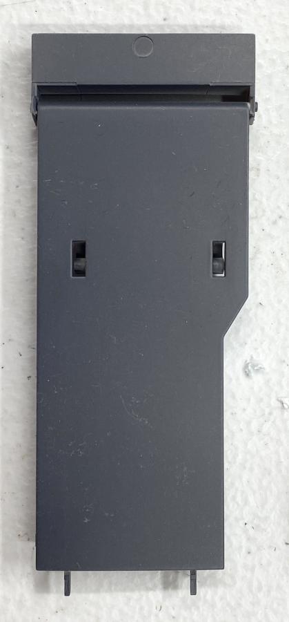

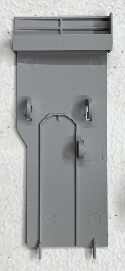

      A favor, please. 🙏 I’m trying to remount the nose wheel gear doors on my A-10 (when I bought it used, it didn’t have any) and I’m unsure about how the rearward door mounts to the strut. I think I’m missing pieces, but if someone could kindly post a photo of that gear door, I would greatly appreciate it. TIA. 🙂
        #11083
        Did you buy the door parts from Motion? If so, you should have gotten a white plastic spacer, a spring, and a screw. This is what it should look like with everything.
        • Mud Duck
          • Feb 2022
          • 46
          #11084
          Thanks! I did buy the gear doors from Motion R/C. That’s exactly what I needed to see. 👍
