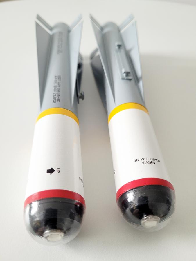

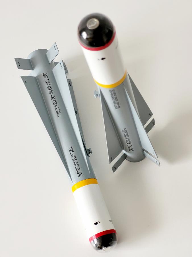

    Originally posted by RAFALR30
    Work completed.​
    RF, OUTSTANDING! Good to see interest in the Hawgs again. She's a beauty. Best, LB
    • SanExup
      • 912
      • Western Wy.
      #11402
      Again!?! One of my favorite planes! I have Hawgs of every size, and at least one gets flown everytime I fly. The Hawg is my emotional support animal.
      • RAFALR30
        • May 2022
        • 35
        • POLAND
        #11403
        And I did something else: AGM-65 Maverick

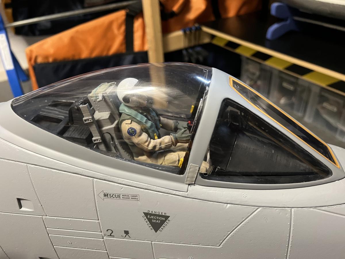

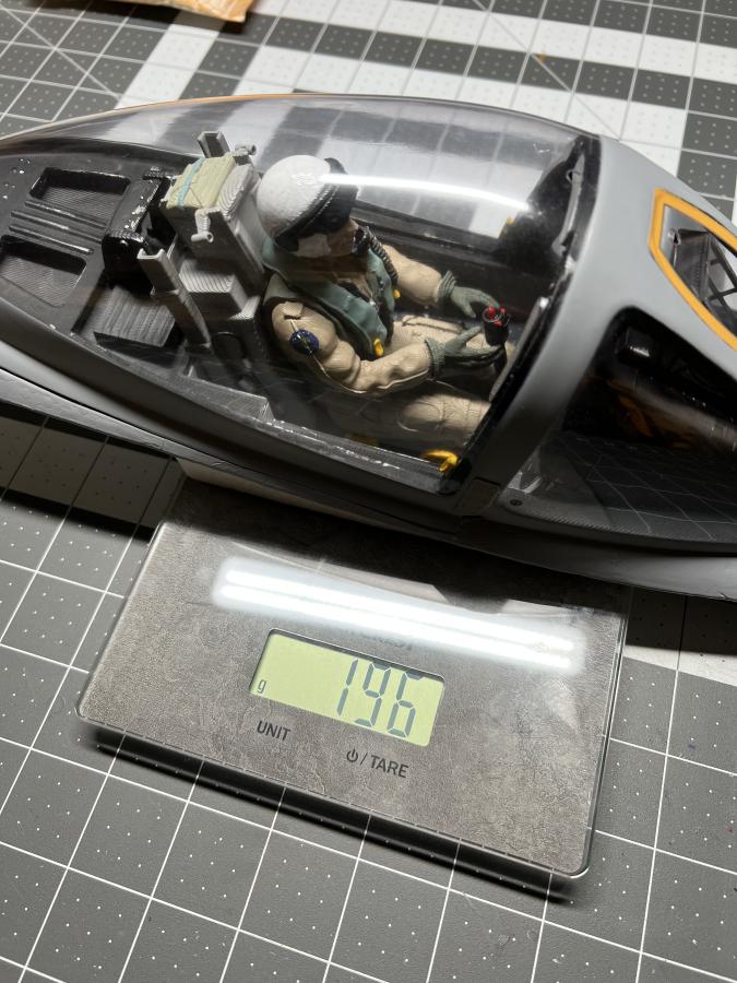

            Does anyone know how much the stock canopy weighs? Thanks
            Tolga
            Instagram: @_t01ga_
            YouTube: t01ga
            • t01ga
              " T "
              • 197
              • UK
              #11406
ID:	387744 I got the answer, 81g.
              My DirtyDee 3D printed cockpit weighs 196g.
              Tolga
              Instagram: @_t01ga_
              YouTube: t01ga
                • 4838
                #11407
                Originally posted by t01ga
                I got the answer, 81g. My DirtyDee 3D printed cockpit weighs 196g.
                T1, Nice work on the "DD" Cockpit, Sir.
                Is that a Max Grueter Jet Pilot?
                Lookin' good, regardless.
                Best, LB

                  #11408
                  Best, LB
                  Thanks LB. The pilot is from Real Model Pilots.
