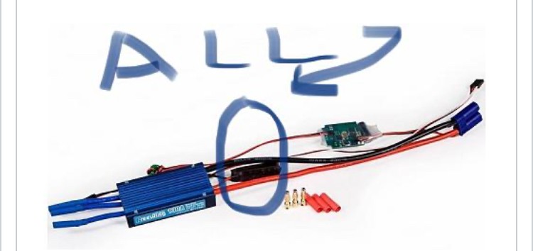

                              For such expensive planes, a few $ spent on RF chokes is cheap insurance. Go to Amazon and search clip-on RF chokes and get a variety pack. Then place them in the following places on all your high-current ESC birds:
                              - All the leads coming FROM the ESCs going from the ESC to the battery, receiver and add another small one by the green toroid one going to the receiver.
                              ****Place them as close to the ESC as possible.***
                              Note: It isn’t critical to place them on the motor side wires of the ESC.
                              - On all long wire runs to servos. Place as close to the servo as possible.
                              - Anywhere else you feel is critical.
                              Use as large of a choke as you can fit. A little foam carving may be needed. They are light weight.
                              Good luck!
                              -GG

                                Glider guy. I no U have been over the choke thing a good amount!!! Put up with me just 1 more time.. I lost a beautiful wunala dreaming al37 some time ago.. it simply flew away on takeoff . and suspected my dynam detrum radio.. and have now changed to spectrum .. I now believe it was likely RF related.. I have 2 8s. 90mm jets that I'm sure need RF chokes.
                                . I'm ordering now there is a large size difference. 2 to about 6 or 8 mm. What sizes should I order. And where to place them.. and how many?? U have done diagrams. .
                                But I can't remember what thread. Thanx in advance. After reading hbuffs loss. I gota do it
                                Smart man!
                                If you order one of the several variety packs on Amazon, you will have a lot of “size” choices. Use the largest size for any given location that will fit. Obviously, the power lead wires will take the larger size, and you can put several wires down the choke’s center valley/trough.
                                For added RF noise protection, put a small one near each servo that is on a long wire.
                                Place the choke(s) as near to the ESC(s) as possible. Include ALL the wires on the non-motor side. No need to put chokes on the motor side of the ESC(s). The motor side of the ESC(s) is relatively RF “quiet. Several wires can be in one choke.
                                I always add a small one near the green ring one near the receiver, too.
                                Here is a rough image covering the above.
                                -GG
