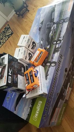

      Had a nice day flying at the field today and when I got home, I had a little present in the mail from Callie. Not sure what this is for but I'm guessing sometime in the near future I may end up joining Aros and his special little club.

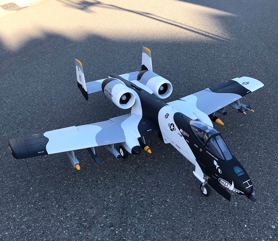

      My man, you can never go wrong with the Arctic Camo scheme! Can't wait to see yours!

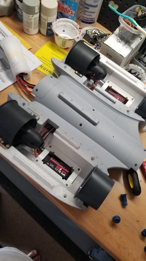

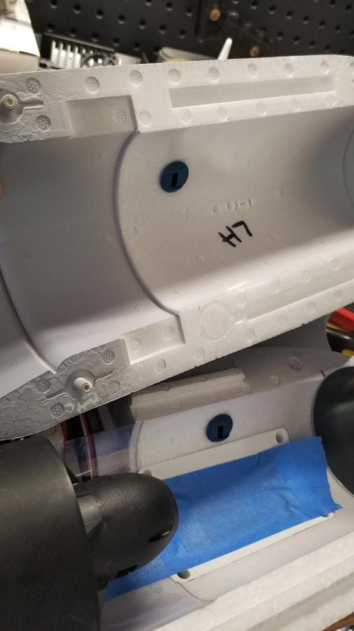

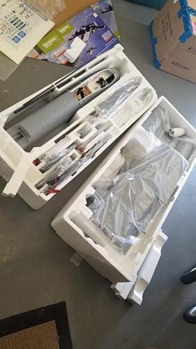

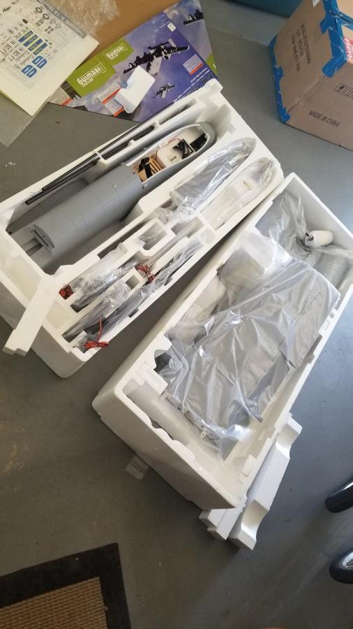

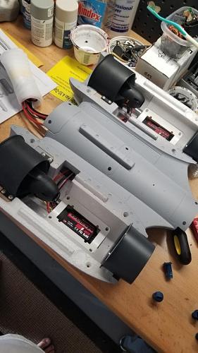

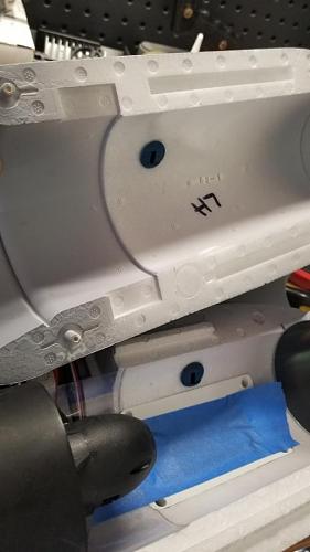

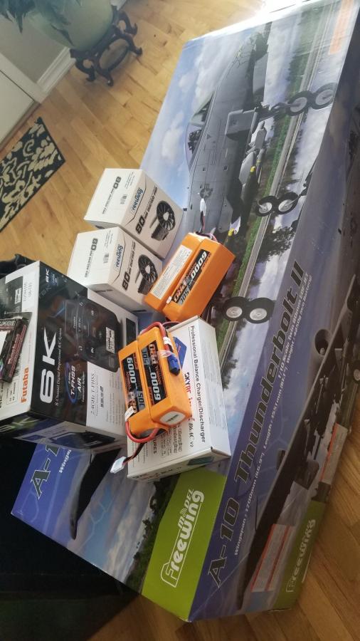

                                Unboxed and made sure everything was there, no damage and all looks good. The batteries for this thing are HUGE! Installed a few NERF whistles in the nacells and started detailing the tail feathers before assembly. Are the decals all waterslide??

                                • Yes. Clean off the area before application and take your time and you'll be rewarded with some really good looking decals.

                                    December came early for you this year. Hey, on that Futaba radio, you will more than likely need to reverse the throttle channel to get the ESC's to arm, I have a Futaba 7C that I fly with and all 15 of my Freewing EDF jets, I had to reverse the throttle, maybe you won't for some reason but if you run into problems trying to get them to work properly, you might want to try that. You will like that Futaba radio and rx, you don't have to worry about adding satelites and all that, it should work great in that A-10. I woud change out the battery holder on that radio though, get you a nice battery pack, I wouldn't trust that 4AA battery spring loaded tray, old school. I can message you my phone number if you need some help setting it up, I don't mind.??
