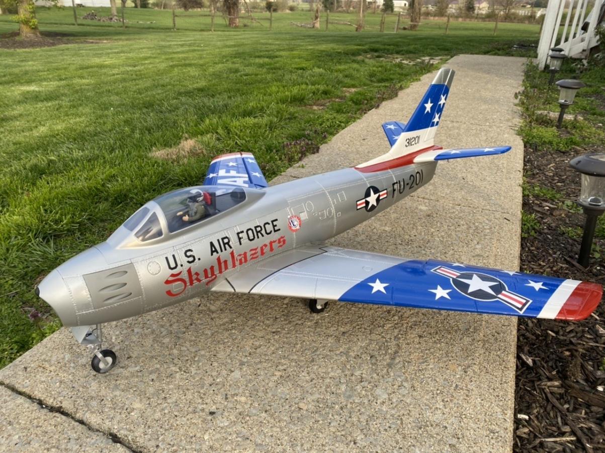

    Originally posted by Waconut
    The graphics arrived today. Callie does great work. I am happy with how it turned out.
    WN, Phenomenal livery and very well executed...but you knew that. Bravo Zulu, Sir. Best, LB
  • Waconut
    The graphics arrived today. Callie does great work. The stripes were not included but I didn’t think they would be. I will order some pinstripe tape.

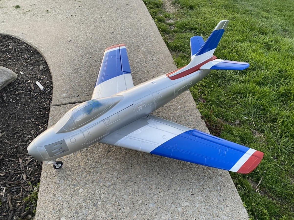

  • Waconut
    I decided to put the F-86 together and see how the paint scheme is looking. Can’t wait for the graphics to get here’s.
